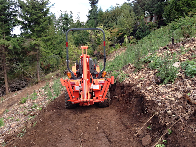

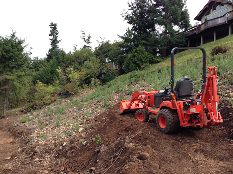

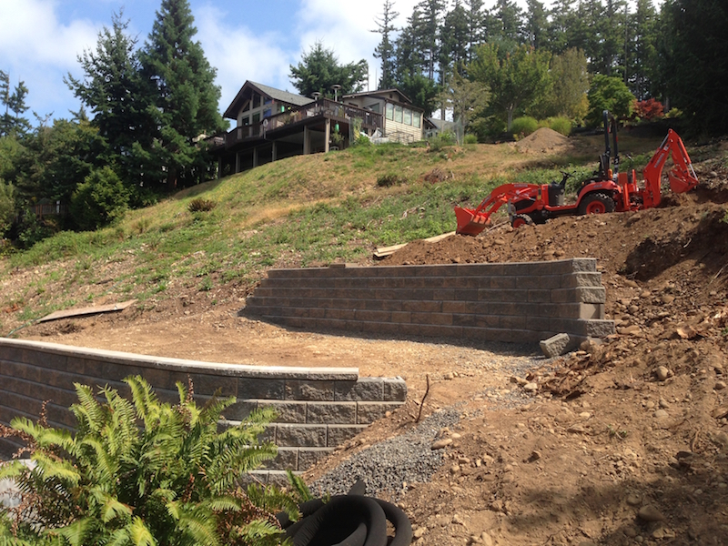

Lots of good points made. My property is steep as that in most places and steeper yet in some. And why I have been busy trying to terrace about an acre's worth with my BX. Up and down as other's have said, I do all day long. Often having to put in the differential lock to get up and always in 4WD. 2in spacers for the rear and 1.25in for the fronts. Keep bucket as low as possible. BH facing uphill when traversing. Go very very slow. A rock or dip on one side is all it takes to go from pucker to over.
So, I guess it depends on exactly what you want to do, how long you have, money an object, bla, bla, bla. Renting an excavator for me was out of the question because I can only put in a few hours a day every so often so it is a long term project. I whittle away and the landscape takes shape slowly. Do I wish I could snap my fingers (hire it done) sure but that isn't going to happen. That said, I surely wouldn't want to traverse slopes on a regular basis with my BX (hence the terracing but that is a lot of work and expense). Takes real discipline and patience to work on sloped property I have learned. Don't get confident. Good luck what ever you do!
