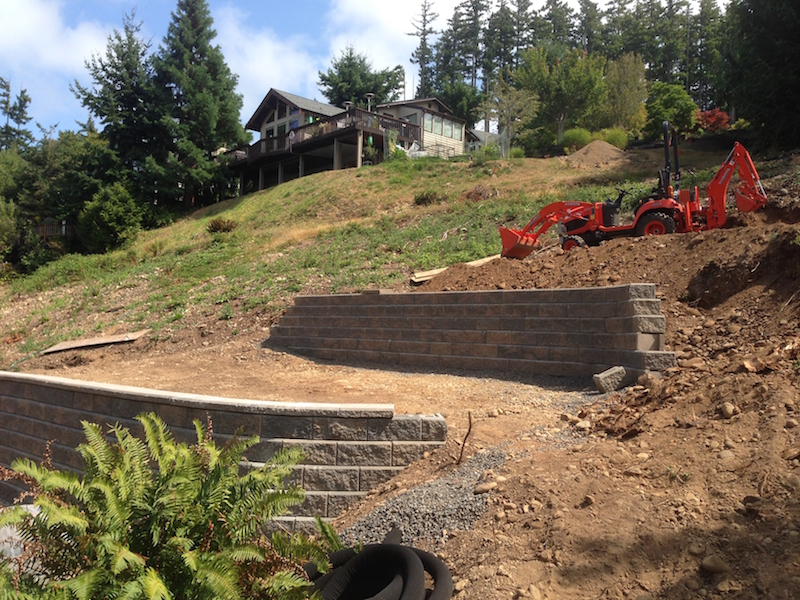

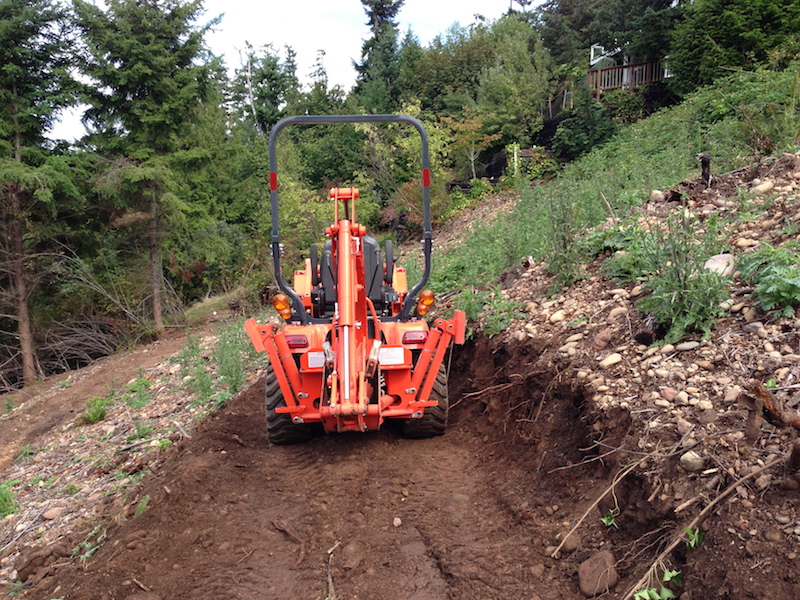

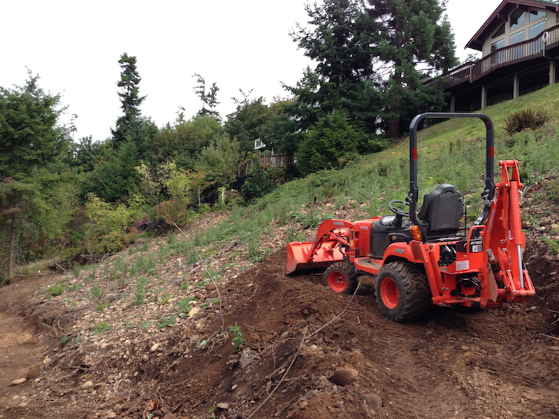

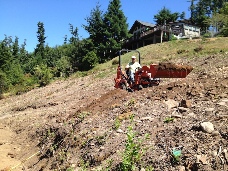

Mowing? Without any attachments, I would likely feel comfortable, in 4WD of course - forget once, and you'd be in trouble. With any attachments mounted, I'm going straight up, or straight down, NO turns whatsoever. Even then, it's at slow speeds.
I'd take the suggestion of renting a tracked unit, or hiring the excavation out. When I first got my BX, I scared myself several times on relatively flat ground.

As others have already said, it seems that pictures somehow just can not capture how steep a slope really is. IMO, these pictures look too steep for BX excavation work and I'm sure it's worse in person.

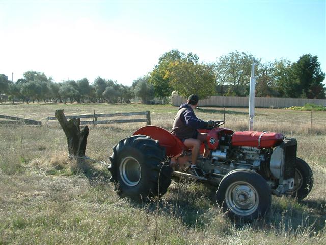

B and BX series Kubotas are fairly tippy. I nearly rolled my 2005 B7510HST (hydrostatic tranny, 4WD) while scooping dirt with the FEL. The right front wheel dropped into a wheel rut and I had to lower the bucket in a hurry to keep from rolling.
For work on your hills you need a tractor with a low center of gravity and wide wheel track. Something like my 1964 MF135 diesel would work OK on your hills.
That 135 is what's called a straddle tractor. You sit on it like you'd sit on a horse with your legs straddling the transmission. This helps to lower the CG. The wide rear tires on 16" dia rims gives a 7-ft wide wheel track.
A tractor like the BX is a platform tractor where your feet are above the top of the transmission. This tends to raise the CG.
So when you go tractor shopping, see if you can find a straddle tractor like my 135. Many old tractors like the Ford 8N are straddle tractors. Trick it out with wide rears on 16" dia rims, add a ROPS and mow your hillside in safety. Your cost would be less than $5K.
