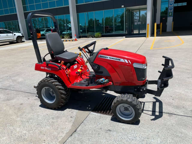

Hi all, so after some massive luck, I've found our old Massey up for sale on Facebook marketplace, pretty much in the same condition we left it in,only with 100 more hours, the owners are asking 12.5K or 8600usd. This is more than we sold it for but it's still cheaper than most stuff now.
What I am wondering however is would a brand new loader off of a 1725 or 1723 fit the 1705? Even with minor modifications, just since I'd very much prefer a loader on it, but can't justify buying a brand new machine to fit with one

I'd presume so, this is a similar one to what I'm looking at, just minus the MMM, and it has the loader joystick aswell as the connection points. I'm hoping it's somewhat simple, as from what I gathered to add it to a new machine was around 7000aud. I remember our old Massey had the same setup too, so I'd assume the frame would just need to be bolted on?
