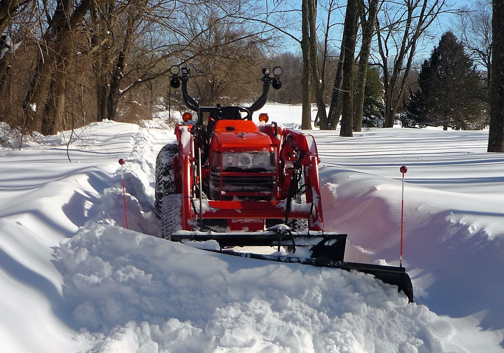

I have a HLA plow and it's great! It does everything I've ever asked of it, and I don't baby it at all. Used it since new 3-4 years now- can't recall which.
See my signature for size of my plow blade: 7'/84".
I try to allow a frozen base before plowing, which isn't always possible, but it is right now.
The blade doesn't need to be hung from chains like truck plows, as long as the loader is strong enough to carry the plow without problem. The weight of the blade helps with plowing heavier snow, and the HLA design, with crossover valve, reduces shock to the FEL. Their plows are designed to be used on tractor FELs.

Yes, the closer the less strain on the loader. My plow setup is virtually unstoppable. With my Aquiline MPC rear chains and loaded tires I can climb Everest. Pics to follow. :laughing:

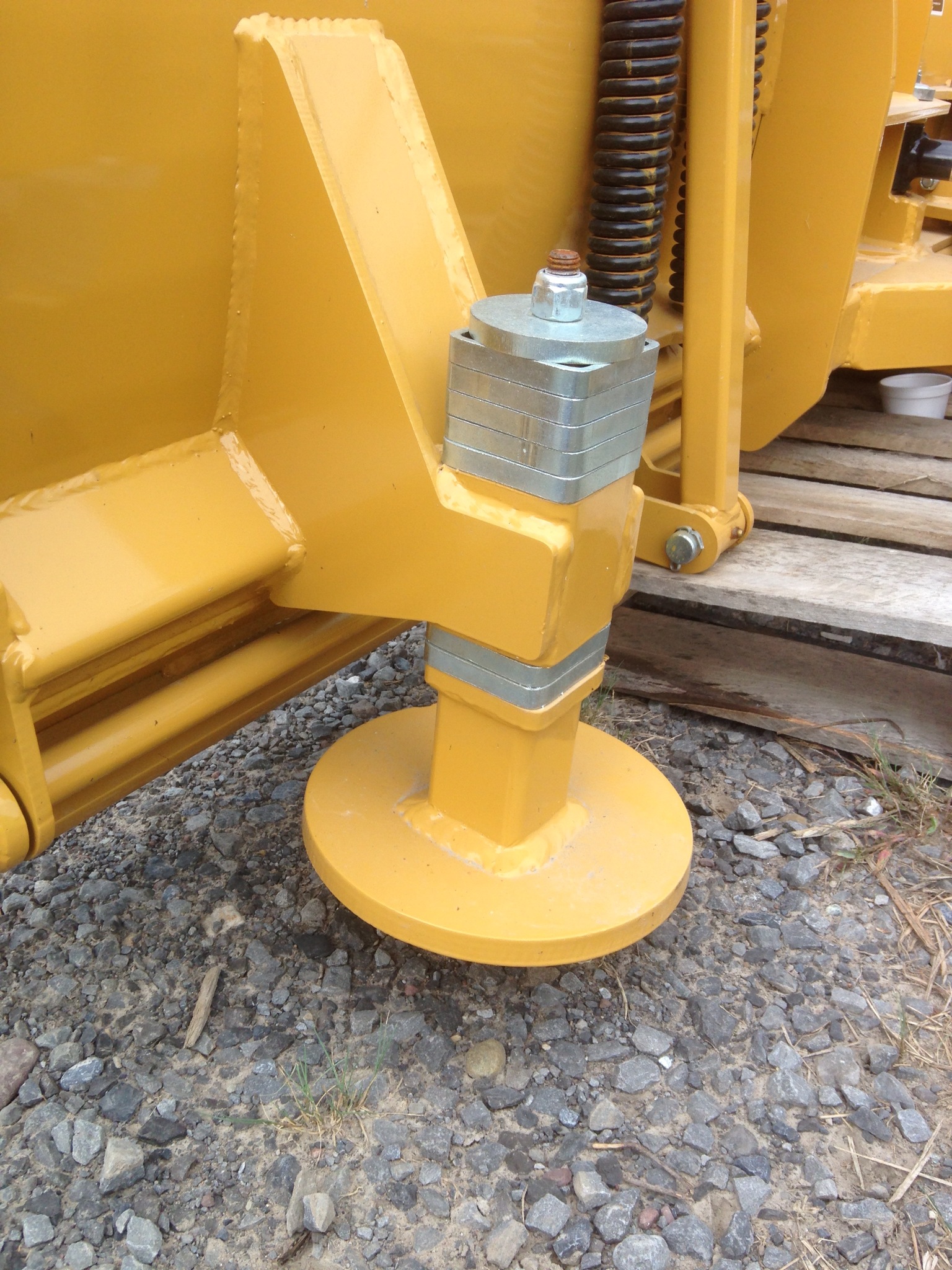

Interesting! I didn't realize that they had made plows with fixed skid shoes! Like to see a photo... All the HLA plows I have seen (catalog + in person) have stacked spacer shoes.
/ WORKSAVER VS HLA Snow plows #16
Here is link for HLA Snow Blades, they do not make one without adjustable shoes/skids. Maybe you bought an older model or clone? Just saying, my 2000 has adjustable skids/shoes and my friends 1000 also has them. Picture please? HLA Snow | 2000 SnowBlade

I purchased a HLA 2000 new 4 years ago that had set on the dealers lot and the paint job was bad. I had it painted to match my Kioti and it worked great. I then purchased a new HLA 3000 and have had it for two years and the paint job on this one is holding up much better, it still looks good. Both have similar type adjustable skid shoes.
