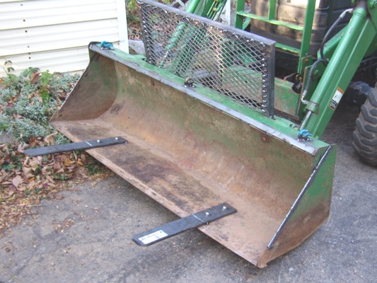

Welding the springs may not work well. Have you considered bolting them on.:D
I have two pieces of truck spring bolted to my bucket that seem to work well.:D

Egon,
Did you temper those springs? And how much abuse do you subject them to?
Thanks.

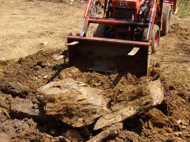

   / Working with Leaf springs? #4
Those springs are not tempered. The ones you see have not been put to the test yet but on my previous the same set up was used to carry logs, dig out tree roots, move rocks and even spade a garden.:D
Well thanks Egon,
Based on your info I went out and sistered replacement springs next to the old broken ones and only tacked them along the sides in a few places and it seems to hold up now. At least they didn't crumple on the first load of Firewood like the first time around. I would have bolted, but of course that would have meant making holes in spring steel which aint easy so I figured I could burn a hole but then I figured if I was going to heat stress it with a torch I might as well heat stress it with a welder but avoided critical areas for better strength this time around.
   / Working with Leaf springs? #6
leaf spring steel is difficult at best to weld, about impossible to drill, and overall difficult to work with without using a torch
   / Working with Leaf springs? #7
Mine were drilled but it was an industrial drill unit and the bits had to be sharpened frequently.
Cutting a hole in with a torch should not hurt anything?:D
   / Working with Leaf springs? #8
Spring shop used to rebuild springs by adding the replacement leave(s) and heating them in an oven to temper them. They 'restore' the arched shape and paint 'em...
Excavation teeth have harden work surfaces mounted on softer material and are usually bolted on.
