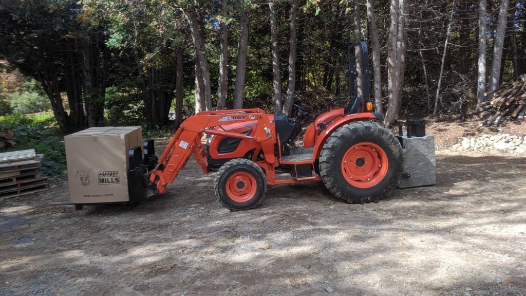

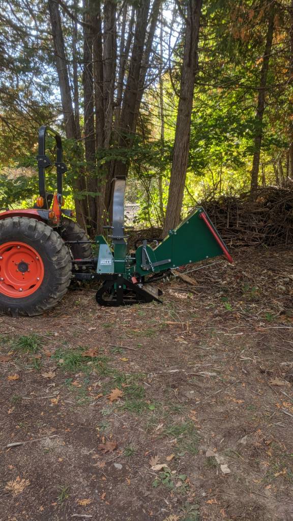

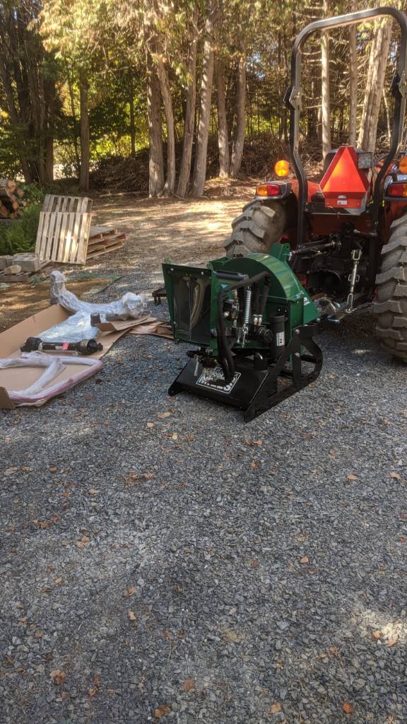

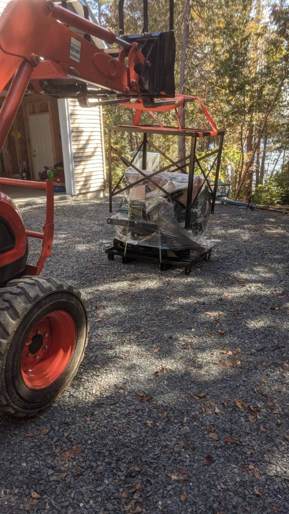

Thanks for all the great information posted on the review and the related follow up. I ordered the Woodland Mills WC68. It came in a week and I was chipping the same afternoon I received it. I am very excited to get to work on cleaning up the property. I think the hydraulic infeed will be enjoyed by my wife. The box was well labelled so delivery guy knew what was inside. He looked around as we unloaded it and said: "you sure could use a chipper"!
