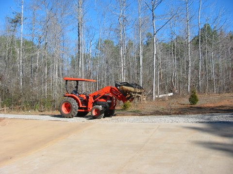

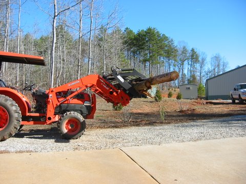

#9
I have completed the grapple installation. It probably took less than two hours total to install the Long electric/hydraulic valve, the hoses, and the electrical.
As a quick test, I picked up a couple of logs in the woods beside the road into my place. It is much like anything else mechanical in that I will need a little practice to get proficient, but it is certainly a good tool. I have enough downed trees to keep me busy for a long time to come.
I will attach a couple of pictures from the first test and get more pictures later showing the installation details.
