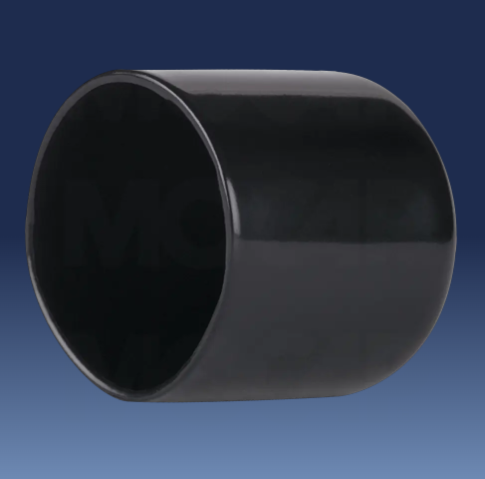

I've lost several of the darn reservoir caps on tractors as well as my vehicles. I swear there's a gnome around that likes to swipe them.
Quite by accident I found these vinyl caps are a good fit and work as an acceptable replacement:
RVC.
They are very flexible and can be cut to any length. Just put a pinhole in the top for a vent.
They're $3 apiece in lots of 10 but you can get a free sample if you ask. Make sure you order the right diameter.

Perfect. That'll work. Thanks.

Do you happen to know the exact diameter of the opening? I have some caps that look similar but that tractor is 3 hours away. Thanks.

I don't have a Kioti but all the reservoir openings on the ones I have are 1.5". It may not be standard though. Maybe someone with a Kioti can post a measurement.

I'm hoping.
