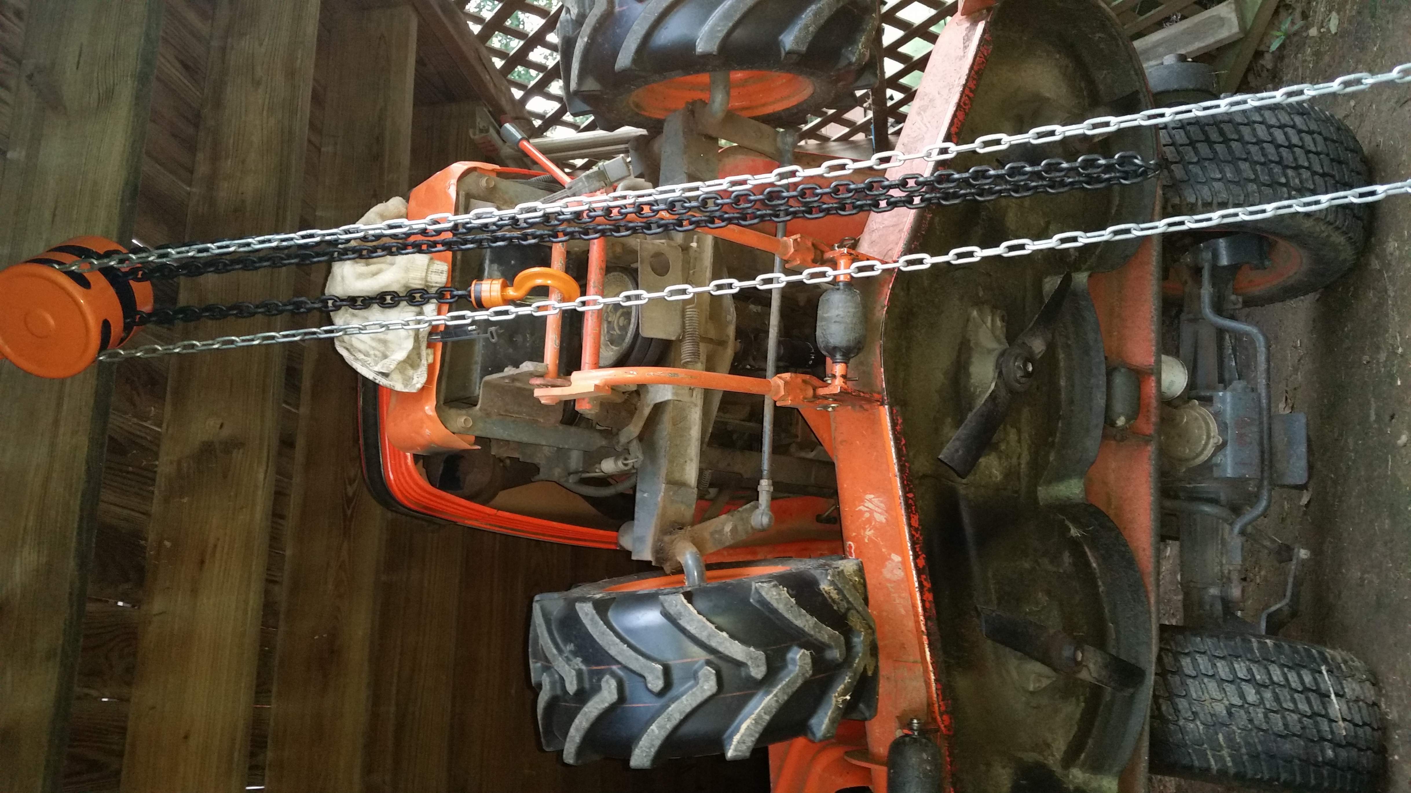

Cleaning my mower deck (Kubota g1900) is always a pain. Ramps nor jack gets it high enough that I can access the deck so I always end up "scraping blind" in a few spots. Picked up a hoist and it does the trick! My question is, will elevating the front end like this do the tractor any harm? Thanks for sharing your expertise! (If this is okay, my next step will be some safety stands) Jeff
PS Can't figure out how to load the picture in portrait mode. It automatically flips my portrait-oriented picture to landscape. Any help appreciated!

I wouldn't leave it like that for extended periods of time, but it shouldn't hurt anything. Just curious, why did you put r1 tires on the front of a 2wd tractor?
/ Will this harm my tractor? PICTURE
Thanks, 4570Man. I'll only hoist it to clean the deck. I guess I should let fluids settle before starting it after I drop it back down.
Good eye! I needed new front tires and just happened to catch these on a closeout - $30 for the pair. No reason for R1s, other than they were cheap!

I would NEVER go in under that tractor hooked up like that to scrape the deck or anything else. I assume you have people depending on you and you are not thinking of them. Let the deck rust out and get a new one every year, but don't go under that tractor. It would be cheaper than the Dr bills and lost work if it ever breaks. Ed

One of our TBN member lost his life just depending on chains.

It's a pita pulling the deck off to clean but that's what I would do. Or drive it up on ramps . If something goes wrong with that set up you have, there is only one thing for certain, you are going to be in a bunch of trouble. .02

I raise mine up like you show in the pic, but with a floor jack. Its high enough for me to use my high pressure washer but I couldn't squeeze my rotund form under there, even if I wanted to. Best to stay out from under and use the garden hose & nozzle or high pressure washer.

I remove the mower from the tractor and use the FEL to lift the mower so it is sitting vertically. Then I clean it. Never under the tractor or the mower.

Thanks for the good replies. For what it's worth, I would never get under the tractor without taking safety precautions. I just raised it to snap a picture and see if you guys thought it would harm anything (besides me!). As I was raising it I thought to myself, "no way I trust a cheap Harbor Freight hoist enough to get under that thing!"

Now, if the OP wanted to invest in a pair of the large, (screw-type) jackstands you see in marinas, holding up (multi-ton) sailboats, and wrestle the in place every time, that would (in theory) at least give him some time, to get out from under, before they tipped over, if the chain (or the WOODEN????) beam the hoist is hooked to give way.
But I'm NOT recommending that. I'm recommending NOT being under a chain- (or chainfall)-suspended tractor.
And to the OP: please tell me that is not some non-professional-grade chainfall and chain? Like, NOT Harbor Freight or even Northern Tool? (And, FWIW, I grew up in my father's heavy construction business, specializing in lattice-boom, and later, hydraulic cranes, which I used to operate, occasionally. The cranes ranged in size from 6 ton to 55 ton. He would not be under that tractor either, if that means anything to you--and he saw combat in WWII, as a Motor Pool Corporal, running cranes and dozers, building roads, bridges, etc..., while being shot at/bombed, etc..., on an Island, far away, at the tender age of 18. He's 90 now.
