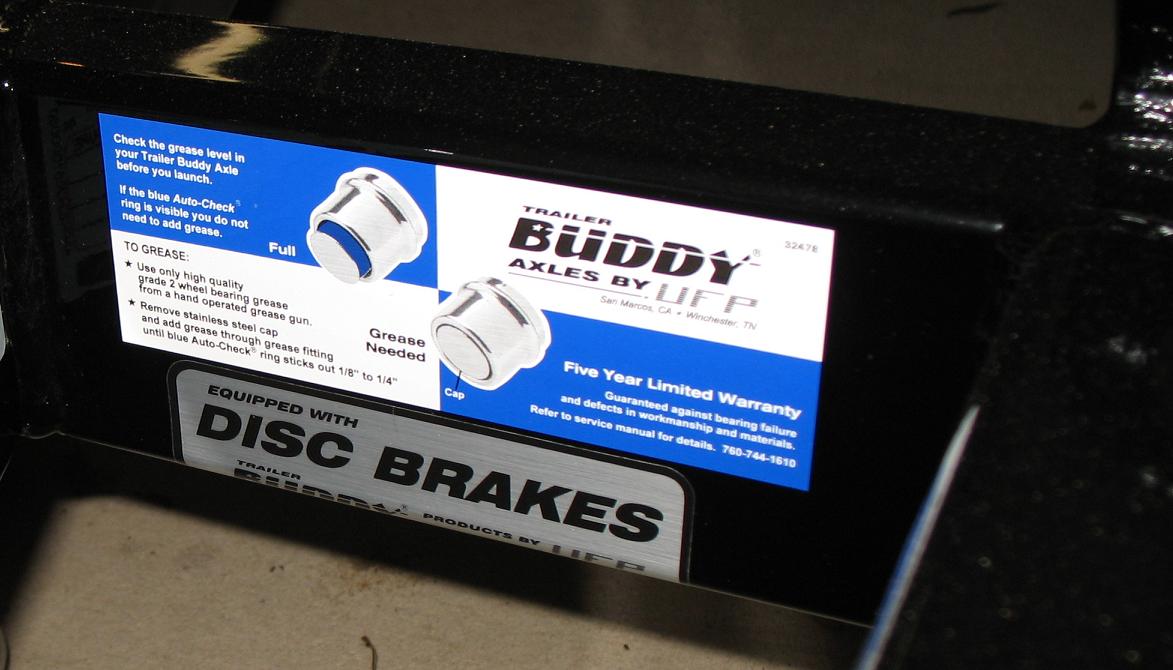

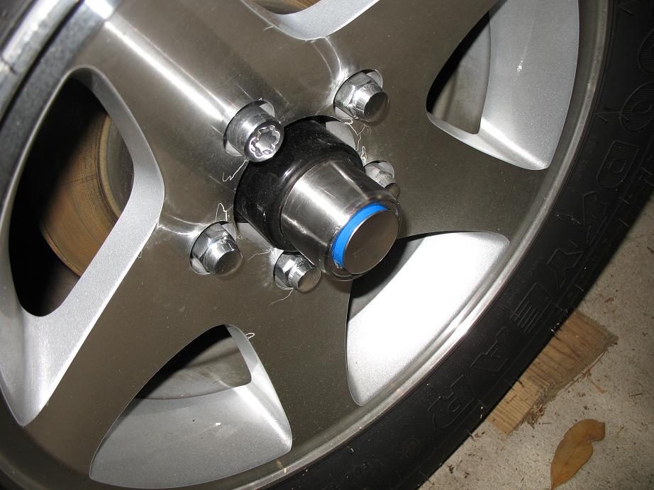

All this time I thought my boat trailer had genuine Bearing Buddy brand bearing buddies, but since this discussion I went out & looked & took the pic below.
As you can see mine say "Trailer Buddy Axles by UFP." You can also see in both pics that they have a blue ring you can monitor; If you still see blue, you're grease level is good, & if you can't see blue & when you push on the chrome cap it won't move, it's time to add grease.
These would sure be nice on tractors :thumbsup:
