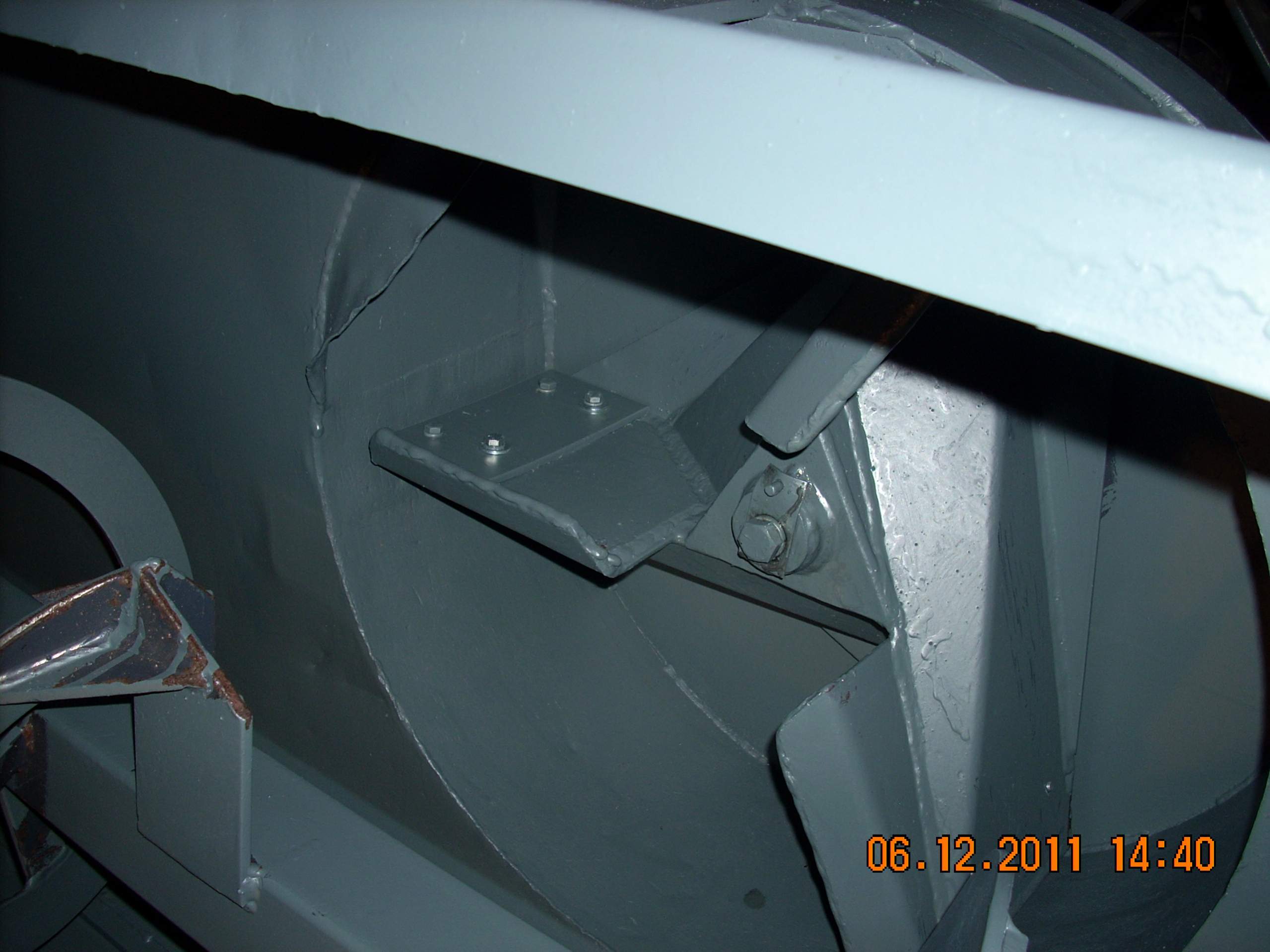

In my case I bought a used 73" blower as it was all I could find locally, for $800. It works fine on 540 rpm but doesn't throw very far. I use it mainly on 720rpm to get a really good throwing distance. My blower had excessive blade tip clearances so I made up some bolt on tips to reduce the clearance down to about 0.030" - they are made from 1/4" steel flat bar. One could also use old 3/8" conveyor belt to achieve the same effect.
I bought used as I am retired and do not have too much spare cash - not enough to lay out for a new blower at that time. I have had to replace auger bearings and open up and check gearbox, clean and refill. As the blower is used I am not expecting new type performance. I also extended the effective width by adding two wings to the blower.

I understand completely. When you changed the tolerances it made a big difference didn't it? Amazing what a quarter inch can do on a fan.
