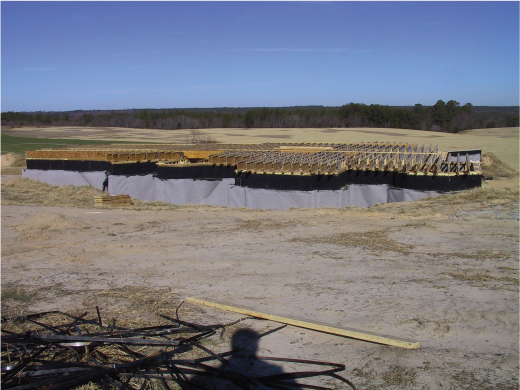

Kyle, like most of the responses, it's quite expensive to add a basement. Our house is being built on a hillside so a walkout basement makes good sense. It's the full size of the the house and will be about 1400 sq ft finished and 800 sq ft unfinished or so. The walls are 10 1/2 ft high and very thick. Lots of poured concrete with a slab floor. Both the architect and the contractor asked if we wanted to make the unfinished portion a shelter from tornados but stated that to do it properly it would require a steel ceiling tied to the foundation. I declined since tornados of any significance are quite rare locally (one every 30 years or so). We have a few load bearing walls and a fairly big open space with a central fireplace. This is accomplished by 16 inch high trusses for the first floor. I've attached a photo of the current state of construction.

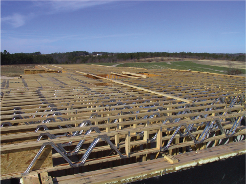

Here's a second photo of the trusses.
