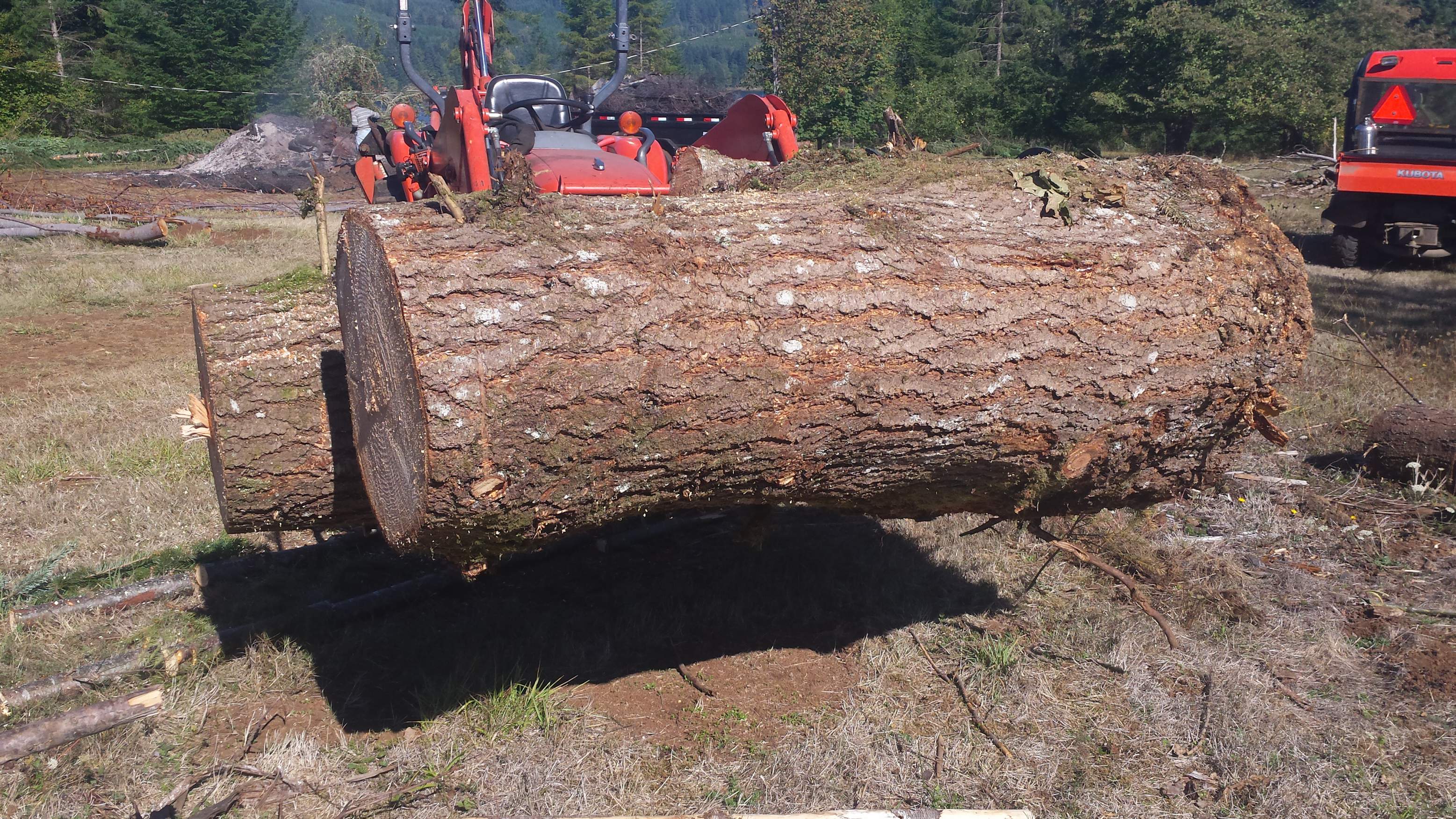

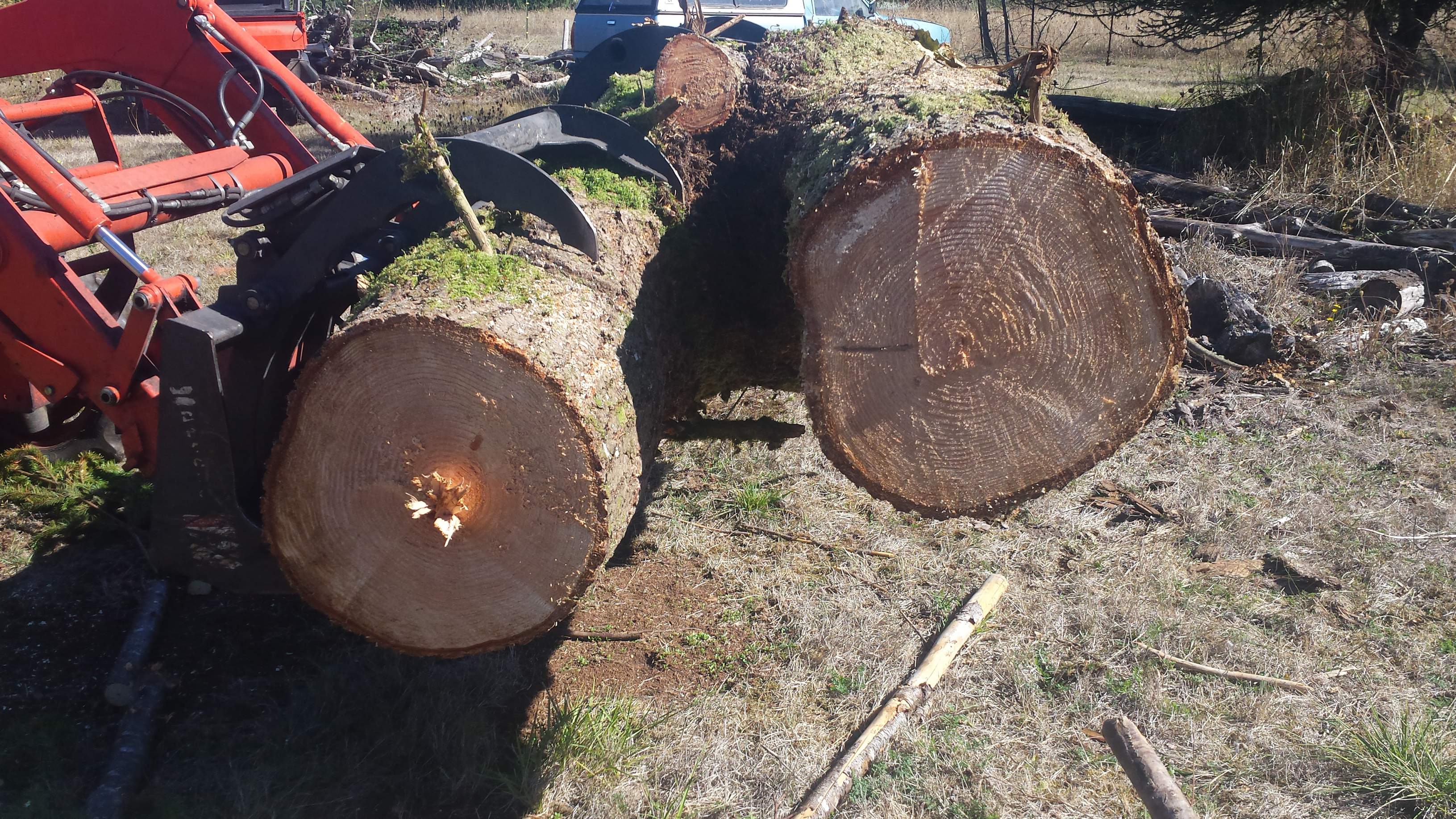

If a Kubota loader is weak, how did it lift this??
