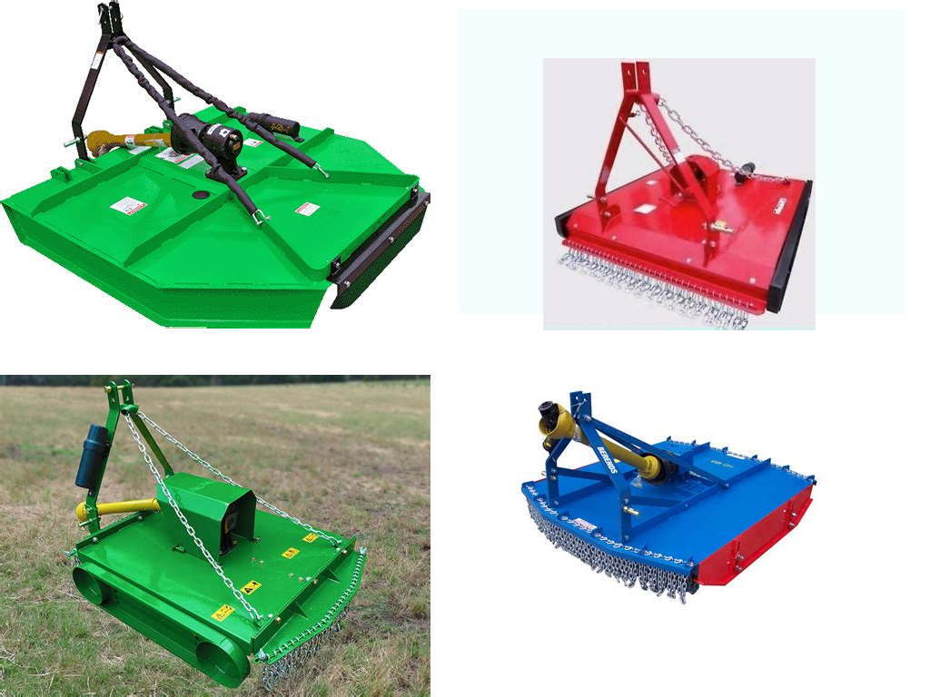

Or, you could take it off. The rest of the world seems to get by without tail wheels.
