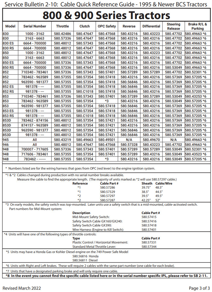

/ Which cable part number is the proper replacement for my worn BCS tractor / tiller control cable?

Service bulleting 210
This PDF lists all the correct cable part numbers for all of the different BCS tractors broken out by tractor model AND serial number range.

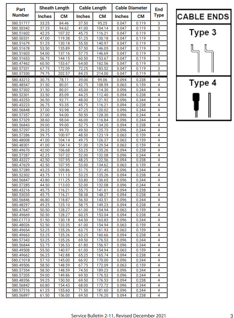

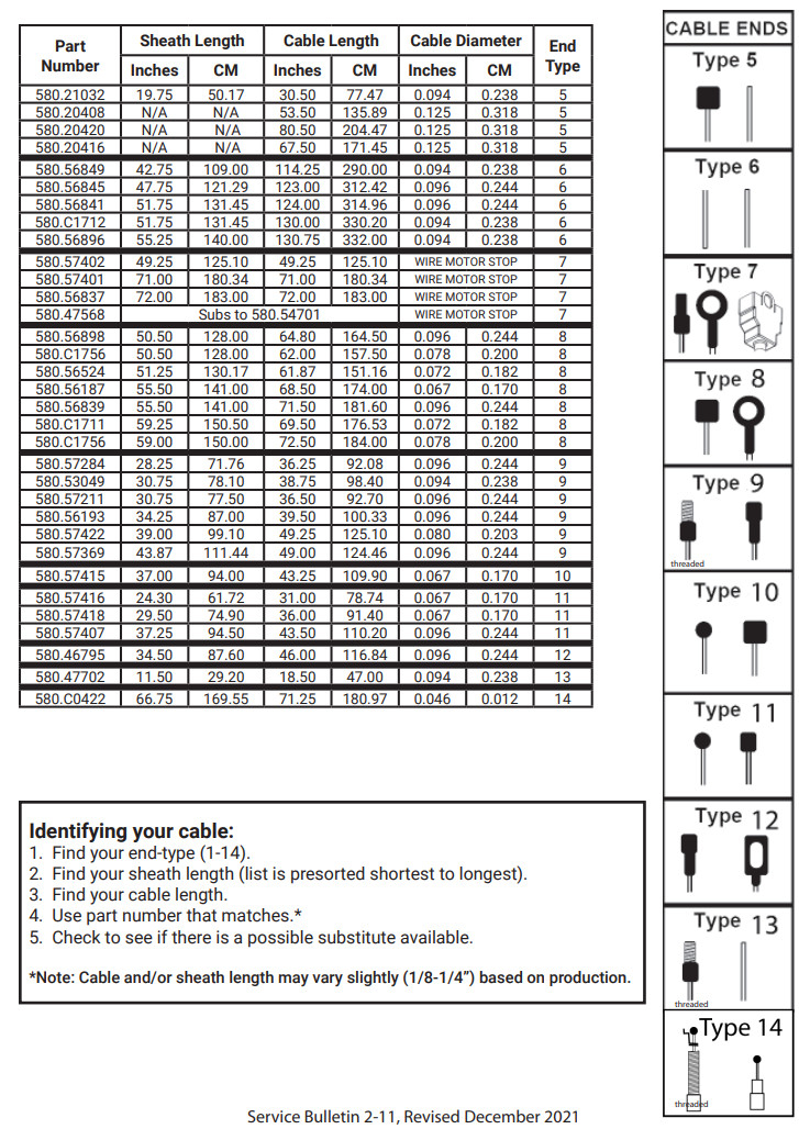

Service bulleting 211
This PDF shows the sheath length, cable length and cable diameter for each cable part number. So if you can't find the cable you need this pdf will give you the specs to have one made.
Just because links have a habit of disappearing on the Internet here is the data from the tech bulletin.
The PDF's are definitely preferable to my screenshots. You can search the second PDF for the part number from the first PDF to find the exact cable specs you need!
