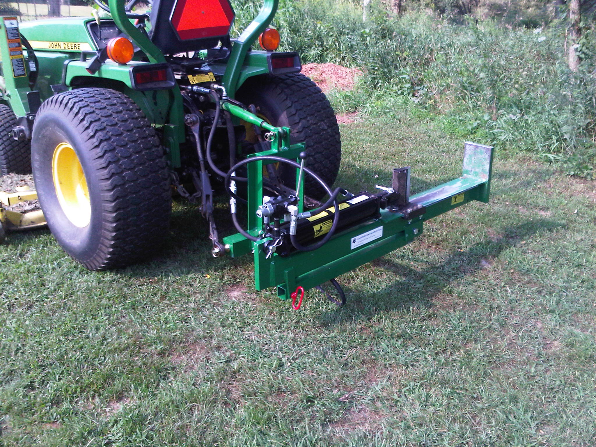

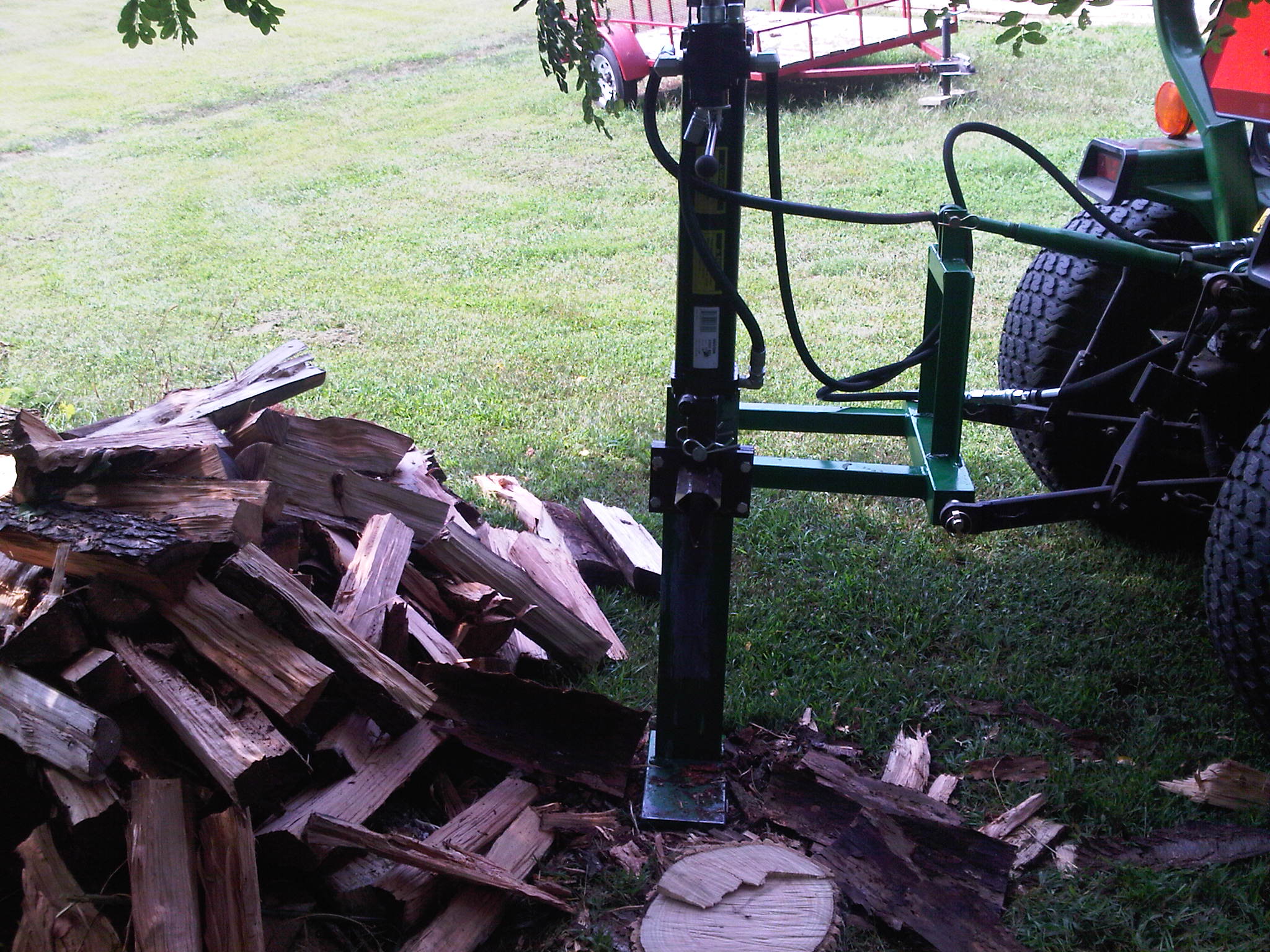

The ramsplitter works good for me. I have 7.2gpm at 2500psi and cycle time is good. Has a 3.5 inch cylinder. Probably only getting 13 tons out of it, but it splits everything. Doug is a little on the flaky side, but the product came as advertised and I am very happy with it.
There are also many threads on this subject. Search the forums for "3 point splitter"

I have the TSC splitter, which is actually a SpeeCo. I seriously doubt their 22 ton claim though. Regardless, it works just fine for me. I paid just under $600 for mine, hoses not included. Either they've jacked the price up considerably, or they're providing hoses and connectors now for $700. Regardless - assuming you've already got hydraulic remotes on your tractor - it's a bargain compared to the gasoline or PTO powered competition.

I bought the SpeeCo at TSC also, $695.00. No hoses. I have no complaint at all. The first thing I did was weld up a small table with some scrap angle iron and bolted it to two existing holes in the beam. When splitting a large chunk of wood the back half will roll off on to the table, out of the way. Hold on to the near piece and split again if necessary. I don't half to bend over and pick any of them off the ground. I have been splitting up to about 24" dia. Cherry, and Ash. Nothing has even slowed it down. I run my tractor 4200 J.D. at 1500 R.P.M.s I bought the hoses at local N.A.P.A each 5' long. But had to get the quick couplers at John Deere dealer to match the ones on the tractor.
