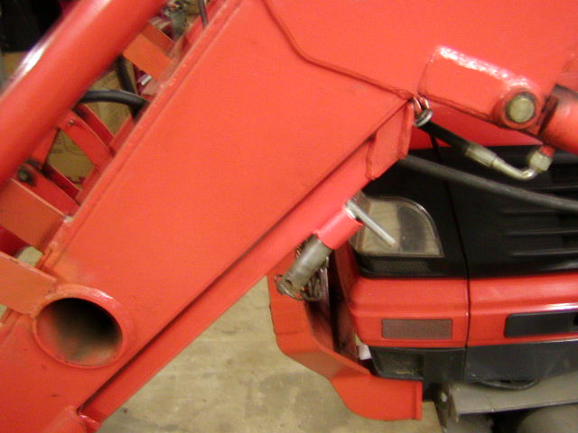

Yes, I do get the warm fuzzies when I figure out something I think is good. I still wonder why it takes me so long to come up with some ideas such as the fel bucket quick connect pin holders, while changing implements.
The quick connect is great, had one for over 2 years now. Changing implements takes about the same time & effort as going through a gate, so I think I may be changing implements nearly as often as I go through a gate. It finally dawned on me, I didn't have to hold 2 pins & linch pins in my hands, open the cab door & lay them on the floorboard, then reverse procedure when hooked up to the next implement.
It only took me 2 years to figure out and 15 minutes to fix. /forums/images/graemlins/blush.gif
Now I can stand nearly in one spot to store or install the pin.
Will save a lot of steps over the life of the tractor. Cost 4" of 1-1/4" pipe & one welding rod.

That's trick Neal. That's like my always using pins instead of bolts on dirt bike trailers I'd make back in the old days. A pin you could cable or chain to the trailer but a bolt was nothing but a thing to get lost. Invariably we'd come in with someone hurt or running late and lose a bolt or nut. Pins with attaching cables became status quo real quickly.
