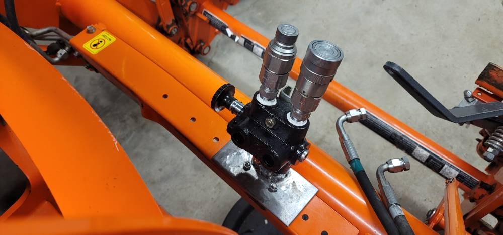

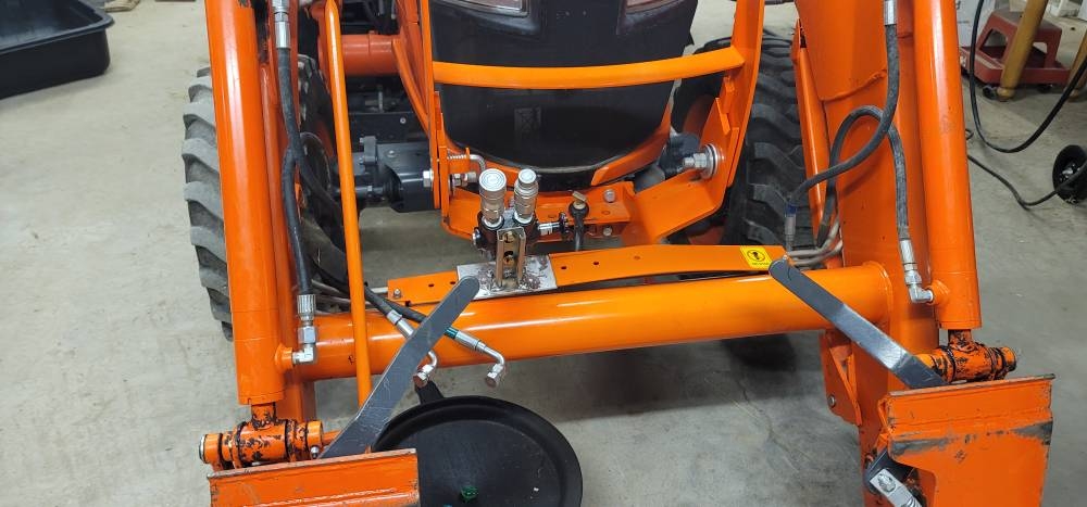

I've had a 3rd function on my loader since new. I had a linear actuator power SSQA on my old machine (Linear actuator for power SSQA?) & am hopefully going to get around to putting a hydraulic one on my L4060hstc finally.
I blew a hose on my hydraulic SSQA post hole digger a little while back & finally got around to fixing it. Standard control valve & no crossover relief, so the only surprising part was it took that long for something to let go.
I snapped a crossover relief between the bracket & QDs on the loader as a quick & dirty fix for 2 post holes this weekend. Things leak & because I flipped the bracket, the back of the hose barely touches the brush guard. So that needs to get redone properly. Hoses don't hit the top of the SSQA frame, but it's closer than I'd like & I'd probably be unable to unlock the SSQA handles with a hose on so the valve mounted like it is doesn't work on many levels.
My only other 3rd function implement at this time is my snow plow. That already has it's own crossover relief valve in it. I'd like a grapple at some point, but it's not likely something I'll get for a good while, if ever.
I had thought about permanently mounting a crossover relief on the loader so it would service all implements & either remove the one on the plow, or just leave it & end up with 2 for that implement. There isn't a super easy place to mount it on the PHD. I'd have to probably mount it to the side of the housing on the top & end up with hoses doing a big S.

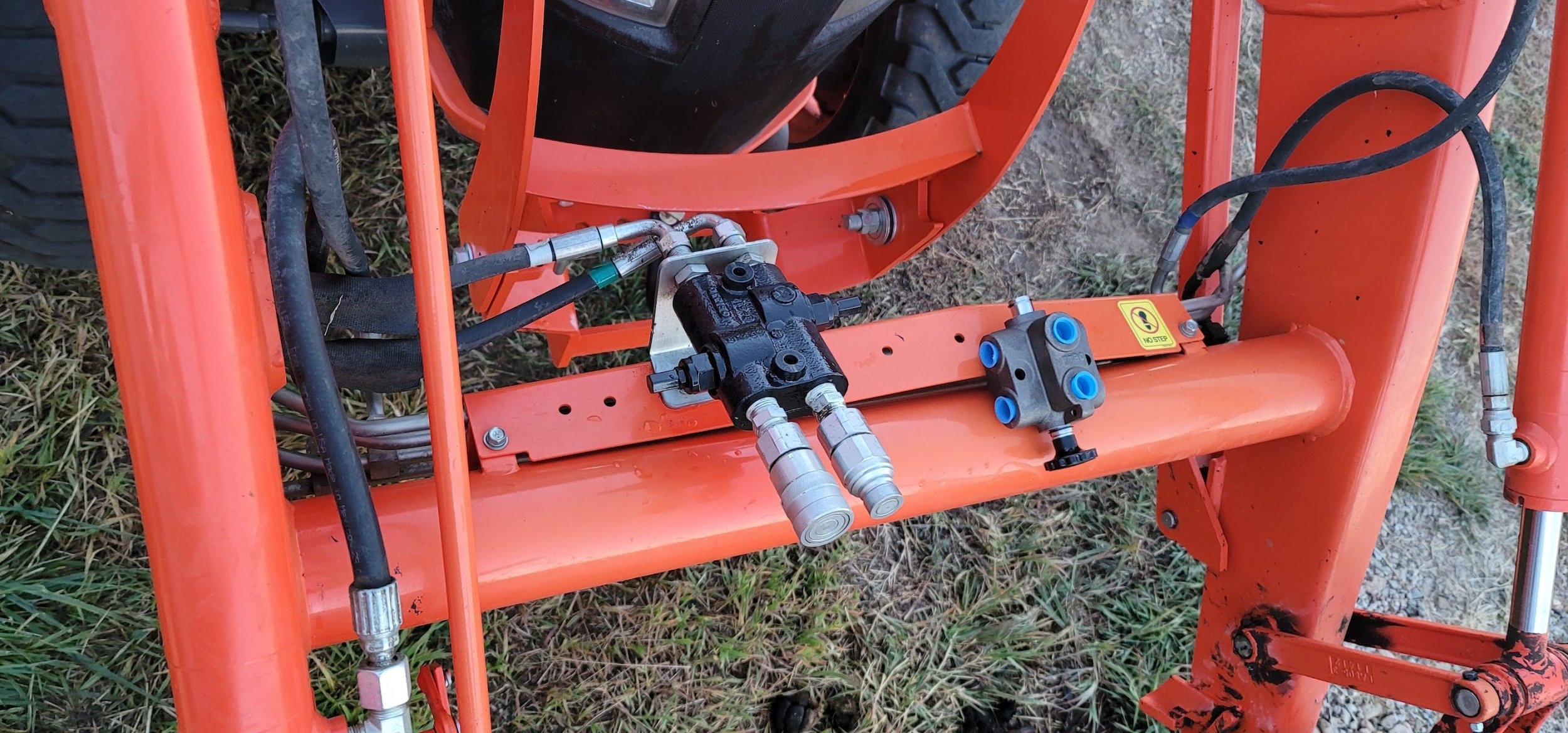

Any suggestions on where to mount & package things? I'm not concerned with how to make things work, plumbing is straight forward. Into the top ports on the diverter, 1 pair out to the power SSQA cylinder. Other pair out to the QDs or crossover relief then QDs. Valve with the blue plugs in it is the diverter valve I plan on using for the power SSQA. 2 ports on top are input, ports on either side are the outputs. I'm guessing I'll end up with the QDs pointing more vertically to steer clear of the SSQA frame, power SSQA gear & what not. The mounting cover the DQs are mounted to is tweaked from a previous oopsie lowering the loader with the brushguard not latched back. Light gauge steel I've never gotten around to hammering back straight. I haven't looked under the guards around the 3rd function valves under the machine, but doubt there would be room for the crossover relief there. Not sure if I want to permantly mount it on the machine side anyway.

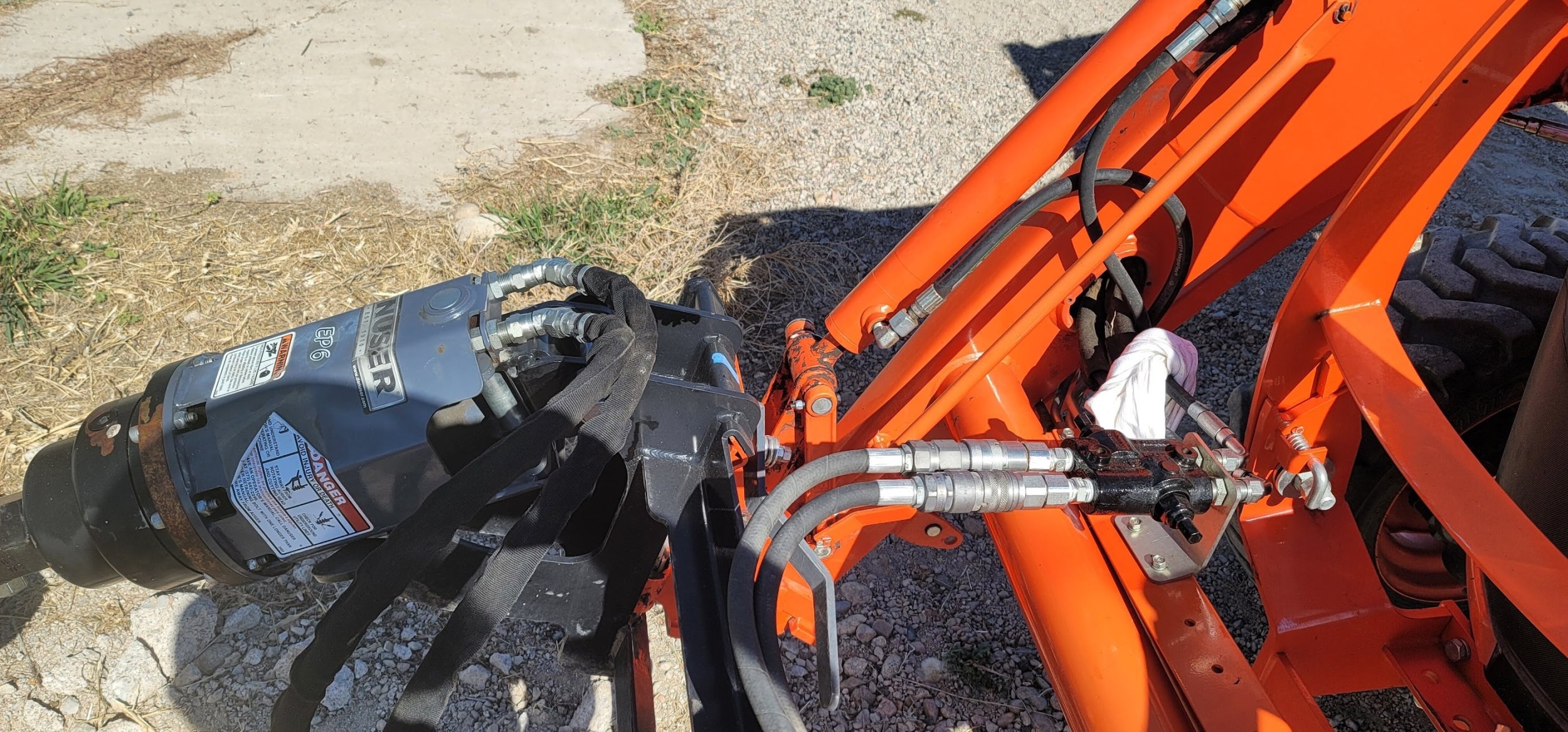

Drilled 2 holes in the top of the PHD last night & bolted the crossover relief there. So apparently, it's going on the impliment & only the diverter & QDs are going on the loader frame.

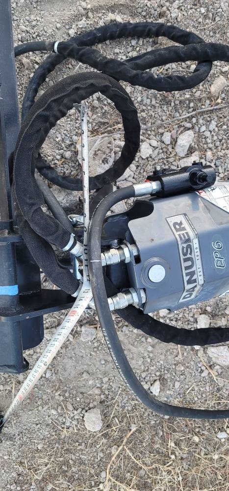

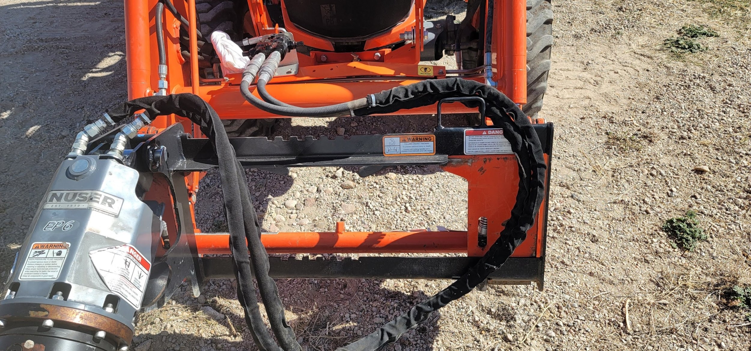

Attached the crossover relief to the PHD. Started measuring for the short connector hoses with a random hose I had laying around.
Painted the manual doverter valve, fabled up a bracket & think it's going there for now.
Have a 1" cylinder with a 5/8" rod. Just need a longer bolt to hook up one of the ball eyes. Figuring out how ill add a rod to the other end. If you can't make it perfect, make it adjustable. So probably going to cut the eye off the rod & weld on some threaded rod.. 5/8-18 Rod End Female Right Hand CFR-10 | Female Mount Female Rod Ends | Rod Ends | Power Transmission | www.surpluscenter.com so I can get the max stroke set exactly right

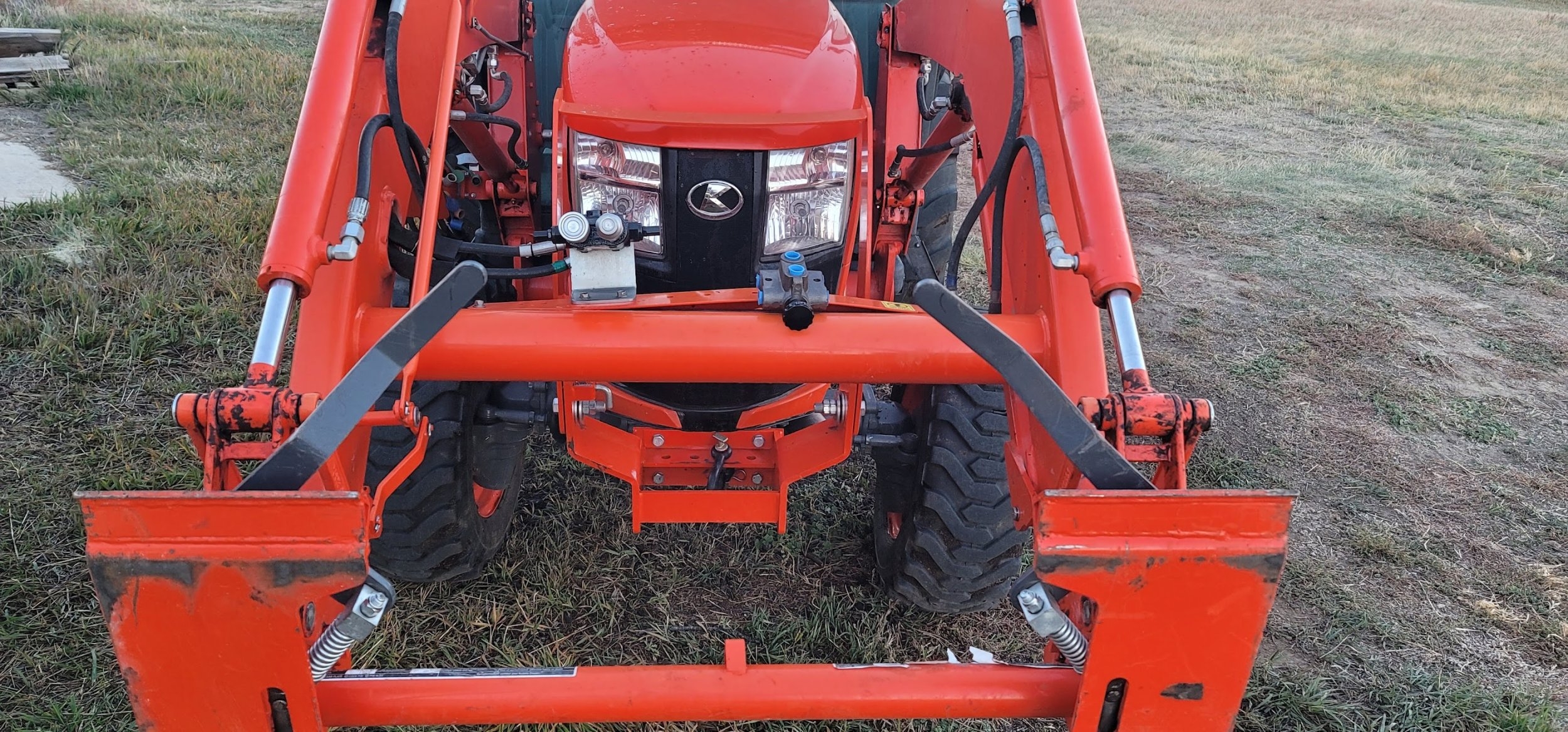

I like your coupler mounting position. It allows you to use body weight to assist in coupling Your hoses to tractor.
I have done similar and it makes a big difference in ease of coupling.
