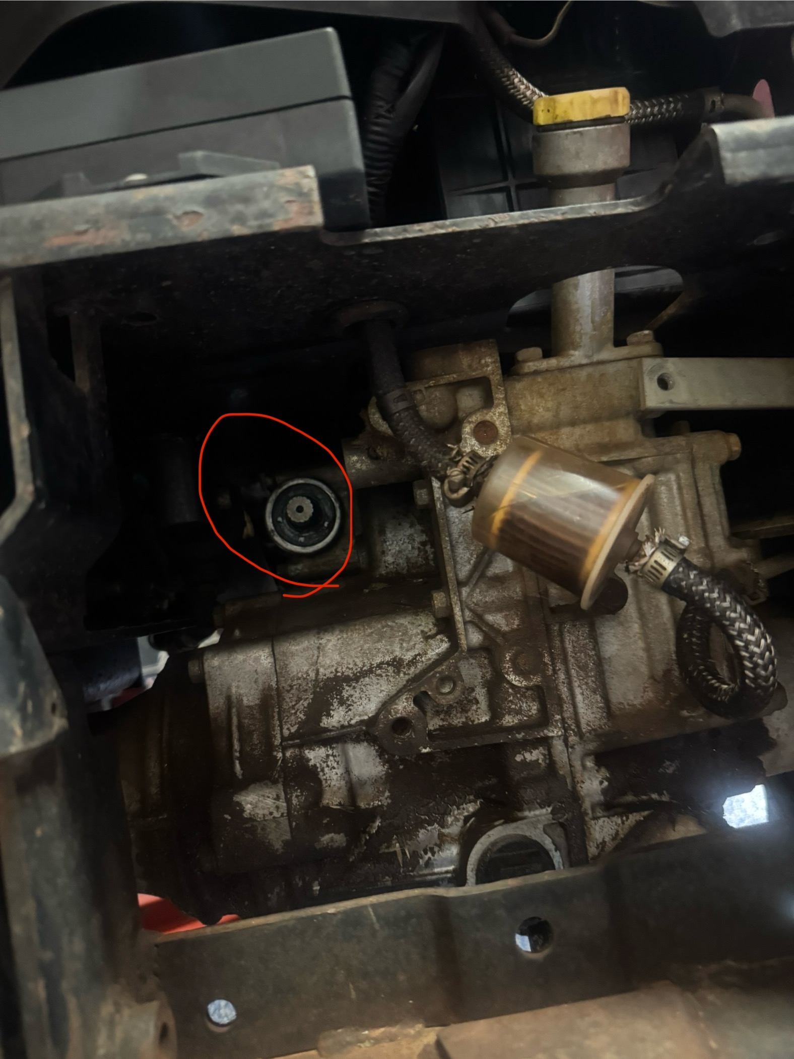

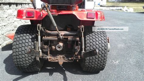

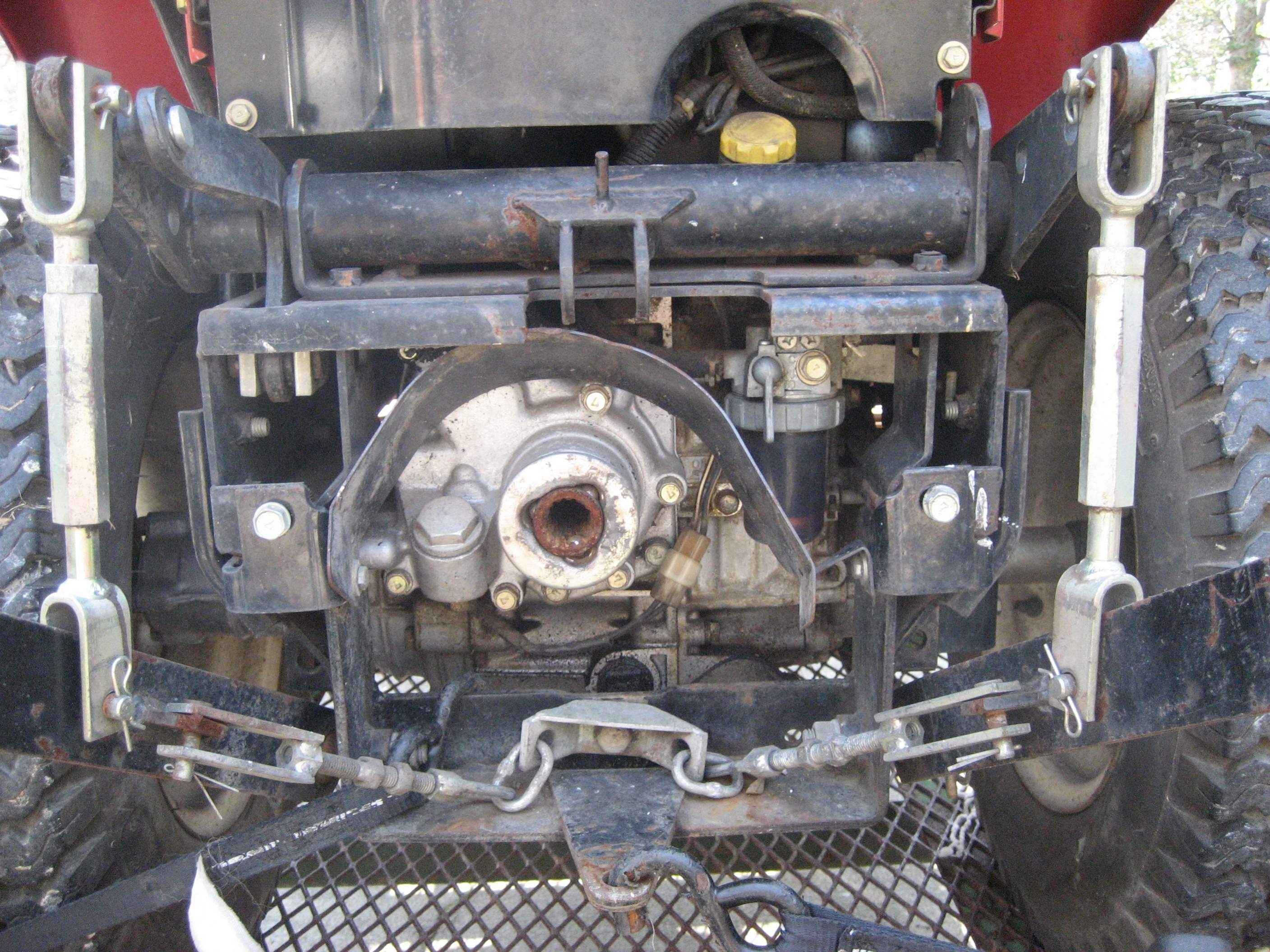

where can i buy a full pto assembly for the rear of a ym 146
   / where can i buy a full pto assembly for the rear of a ym 146 #1
1971bmw2002
Nov 12, 2025
8
ym146
sorry for posting about this so much im new to this tractor stuff and never owned one before
   / where can i buy a full pto assembly for the rear of a ym 146 #2

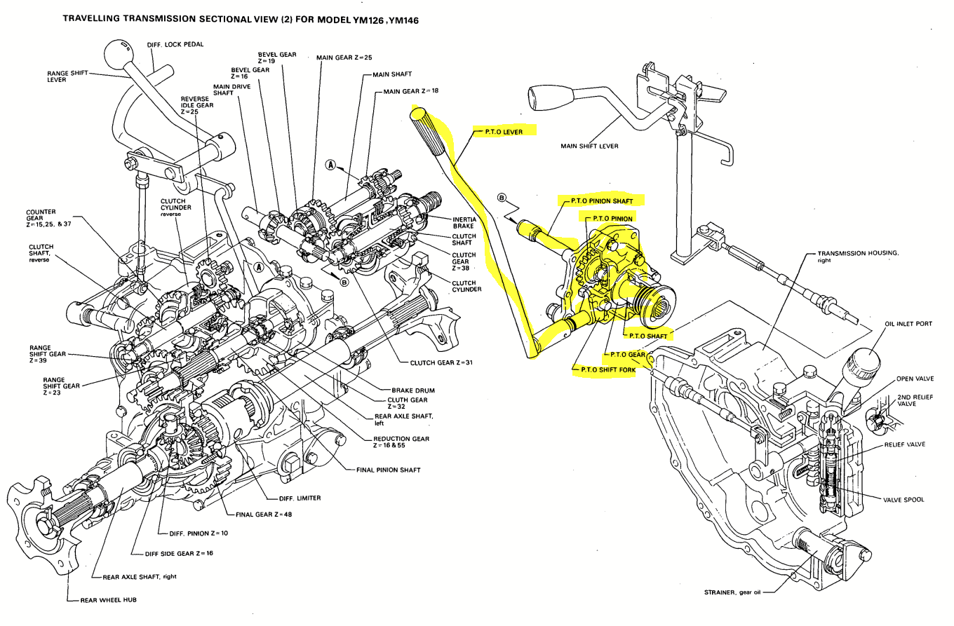

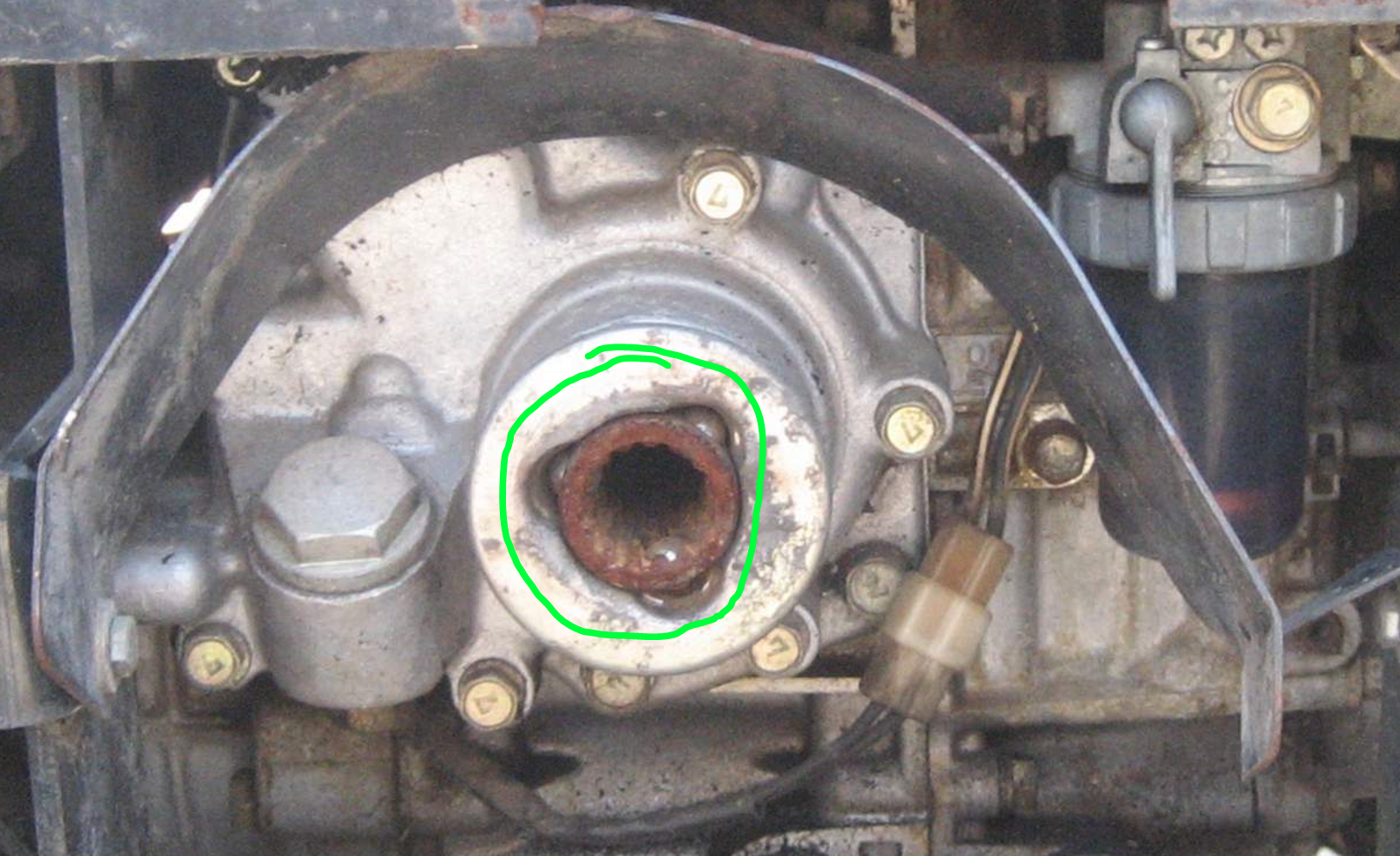

You can ask in the Yanmar section again. :ROFLMAO:
This is in the FREE manuals on the YTOG.
YM146 PTO . . .
This is for the front PTO.
From the documents, to add a rear PTO, you have two options,
1. A rear electrical PTO drive with shaft.
2. A Sleeve Hitch and a belt system of the front PTO drive.
