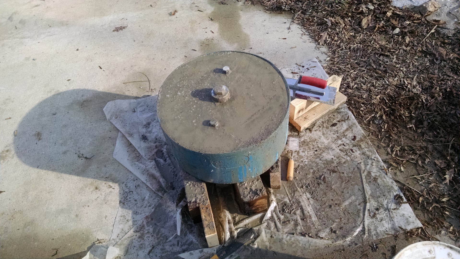

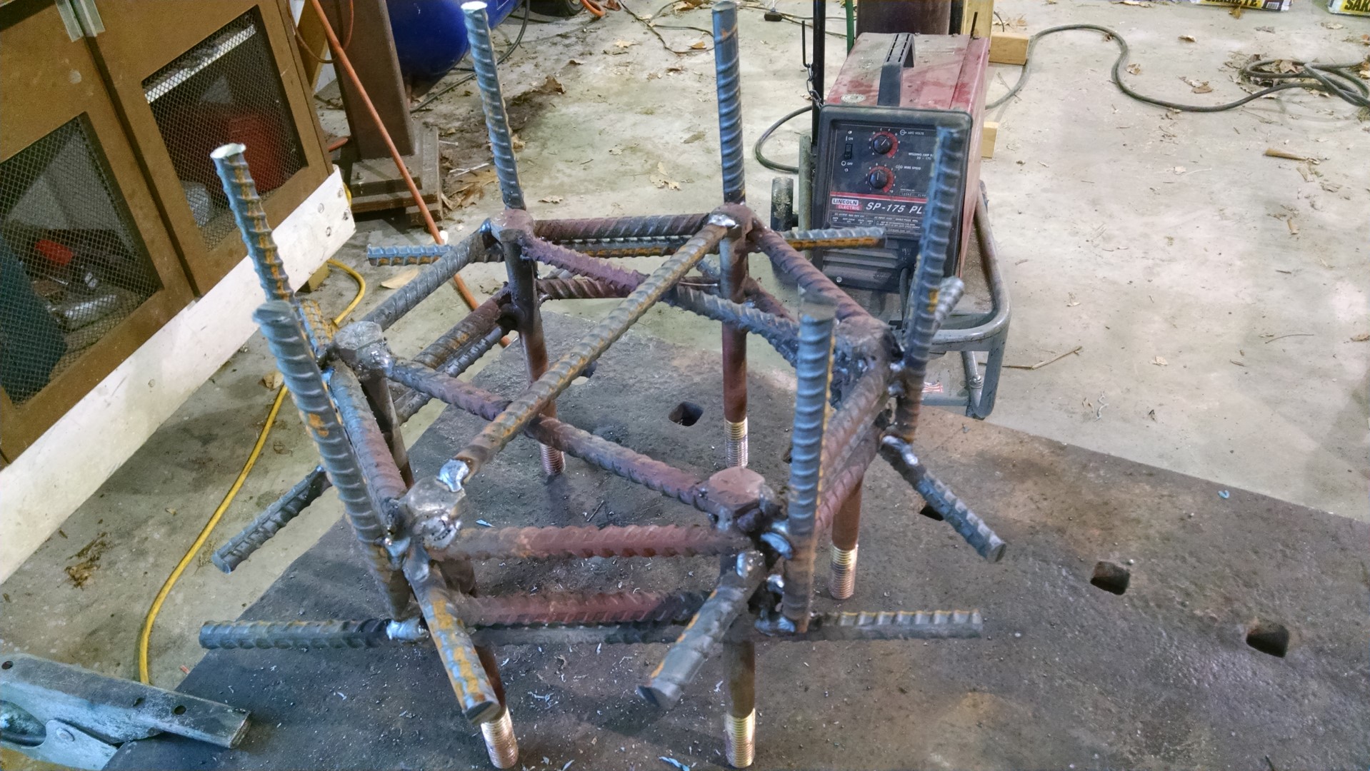

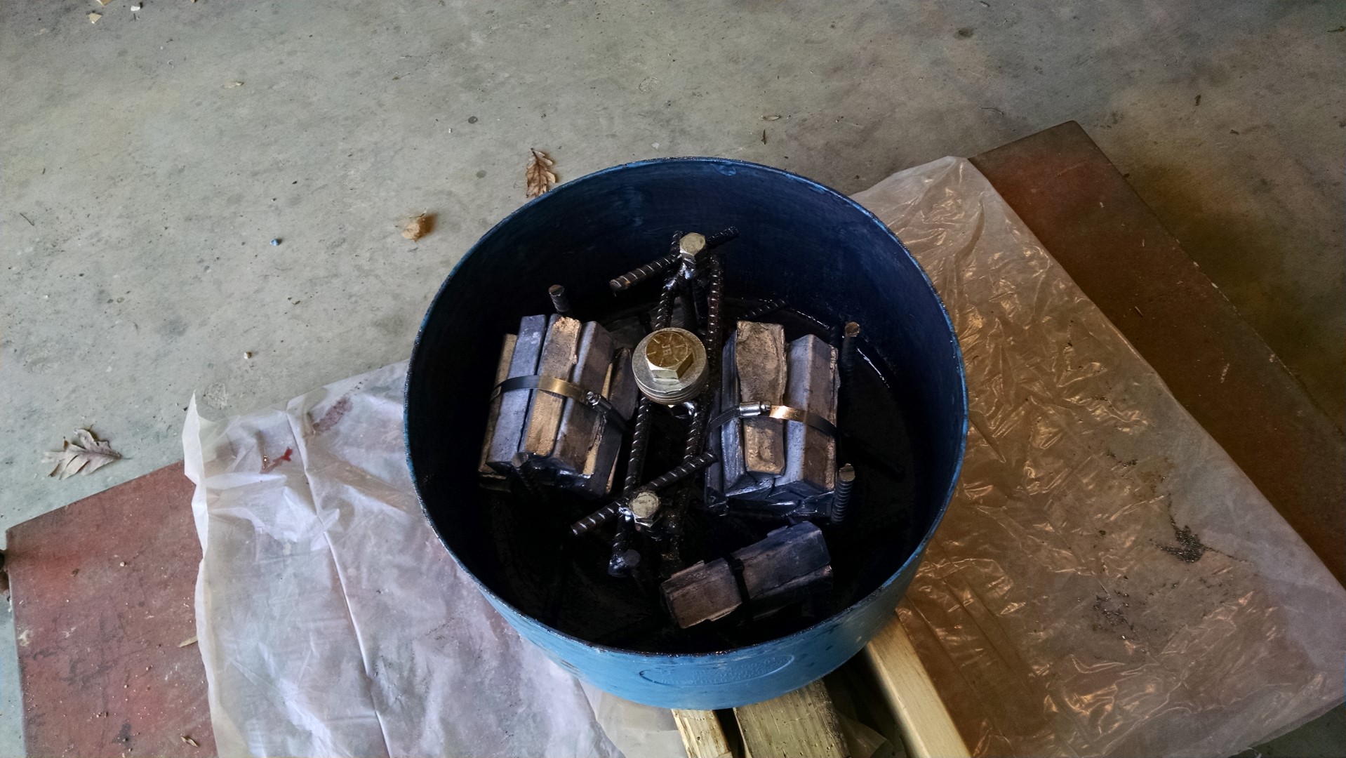

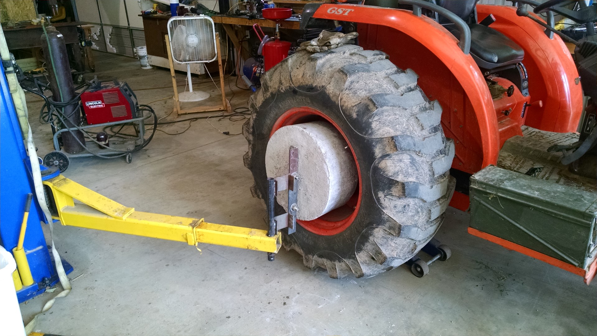

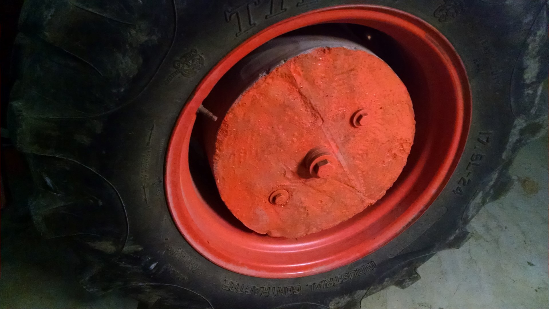

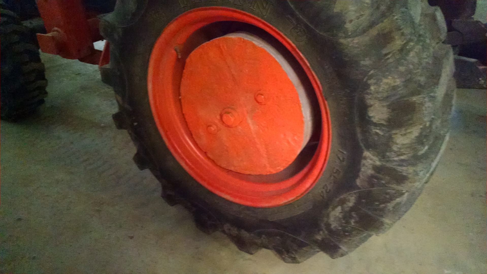

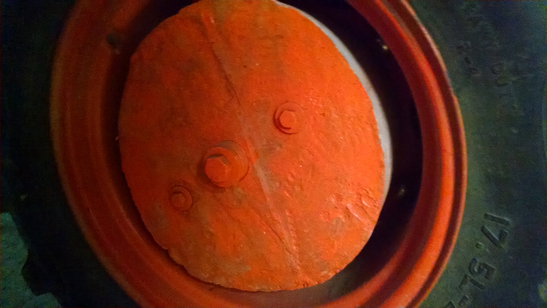

I made my wheel weights out of steel, concrete and lead. 240 lbs on one side, 260 lbs on the other, total = 500 lbs. Cost me $120 for 140 lbs of lead from a friend who casts his own bullets.
Pics:
Pics:
View attachment 503346View attachment 503347View attachment 503348View attachment 503349
Nice wheel weights, you have 3 ingredients, but what's the recipe and mixing instructions and how'd you end up with 240 one side, 260 the other side, two different recipes by trial and error? 500 lbs is what I'm looking for but how hard is it to set that 260 lb weight in place, or is two pieces, lift it by chainfalls maybe?
   / Wheel weights #40

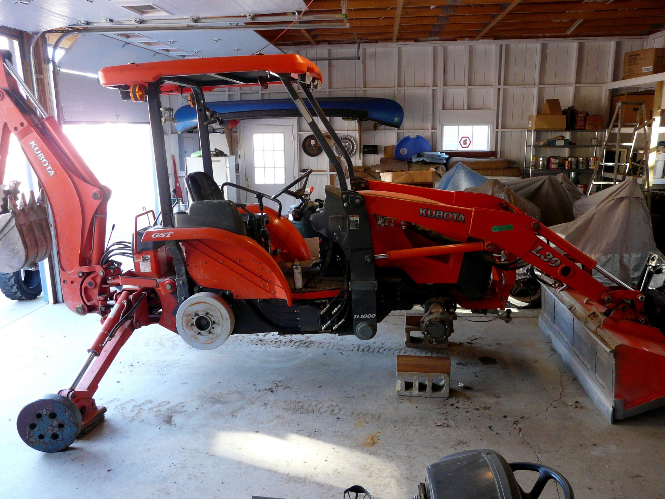

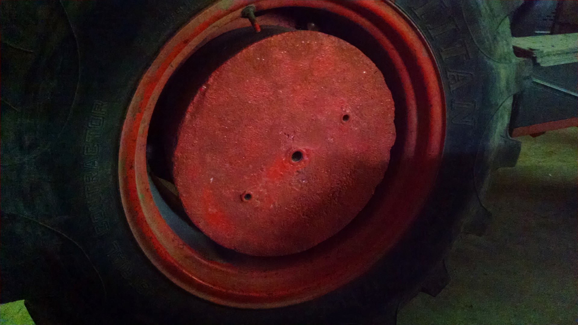

Unfortunately I can't find the thread where I documented the build, but here it is in a nutshell:
- Six 5/8"x8" Gr8 bolts mounted to the wheels; weld 1/2" rebar between them fixing them in place
- Remove and weld additional rebar; weld two 5/8" doubled nuts to rebar about 12" apart and one 1" double nut to the center
- Add the lead weights and attach with SS hose clamps
- Cut a 30 gallon plastic barrel about 8-10" high, drill holes for 6 gr8 bolts
- install 6 bolts with rebar and lead etc. fill with concrete; let sit for a couple days.
- build tool to mount to 12k lb double post lift and attach wheel weight to it.
- roll tractor, lift the rear tire, mount wheel weight using shop lift and rotationg tire; tighten 5/8" bolt nuts, call it good.
Pics:
IMG_20141203_152020914 (Large).jpgIMG_20141204_124601540 (Large).jpgIMG_20141204_140211219 (Large).jpgIMG_20141208_121636227 (Large).jpgIMG_20150605_110648562 (Large).jpg
