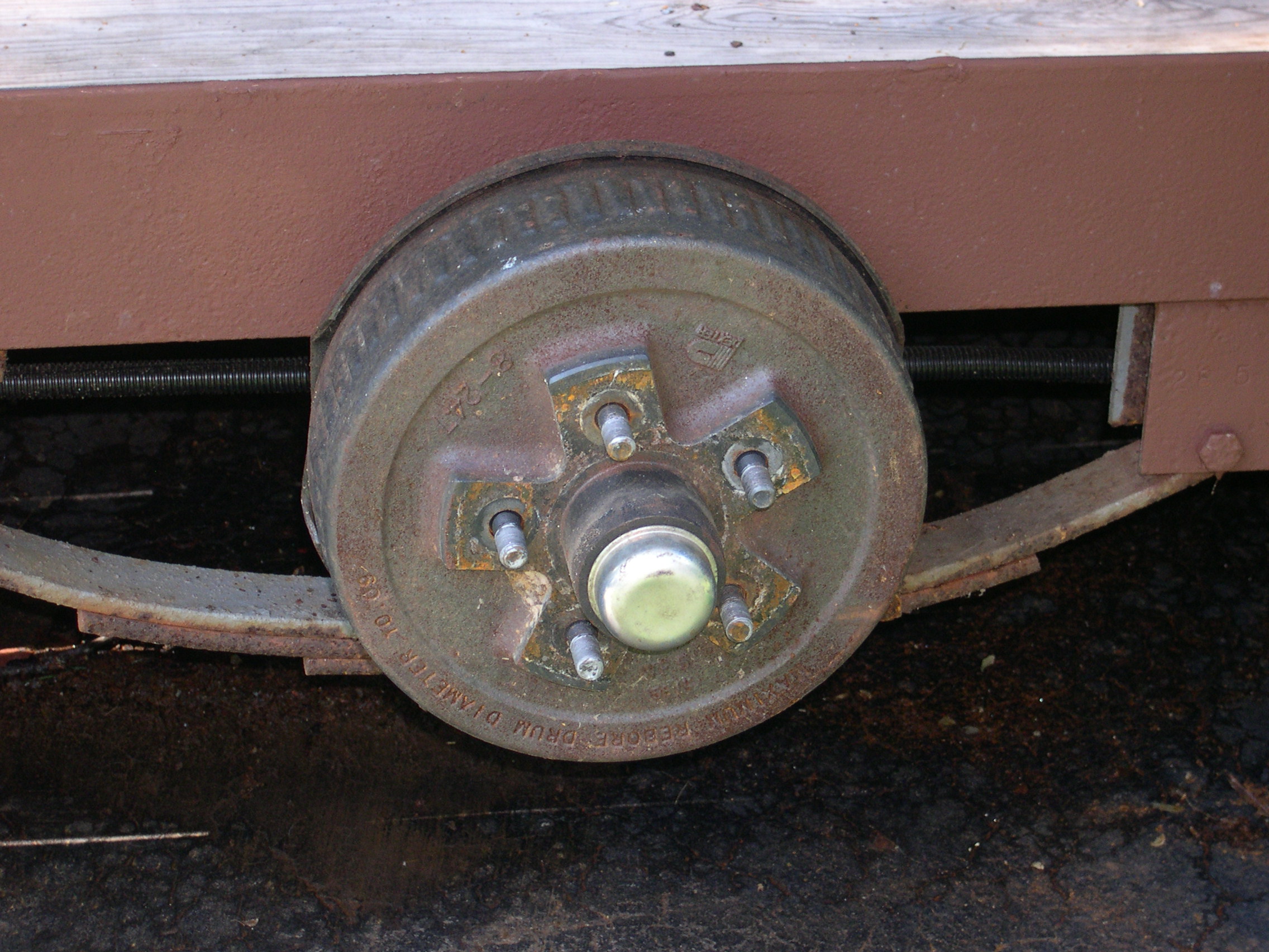

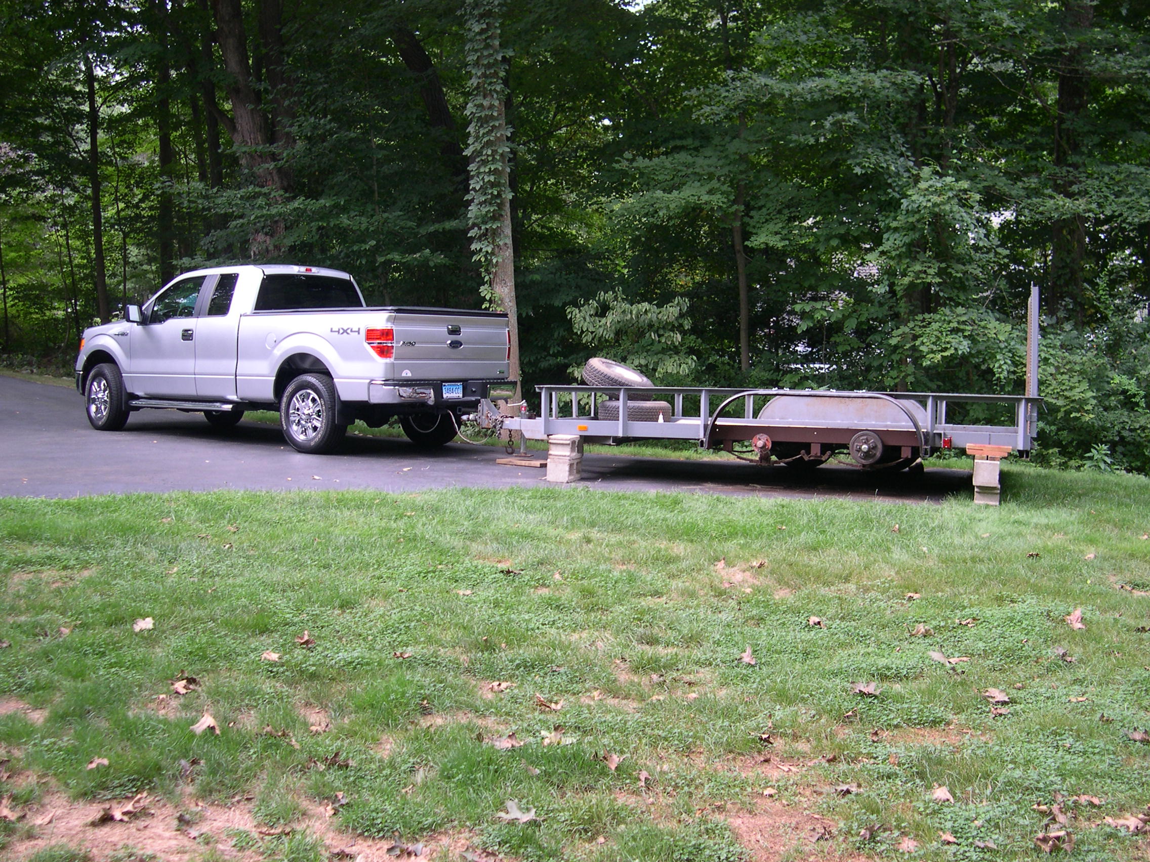

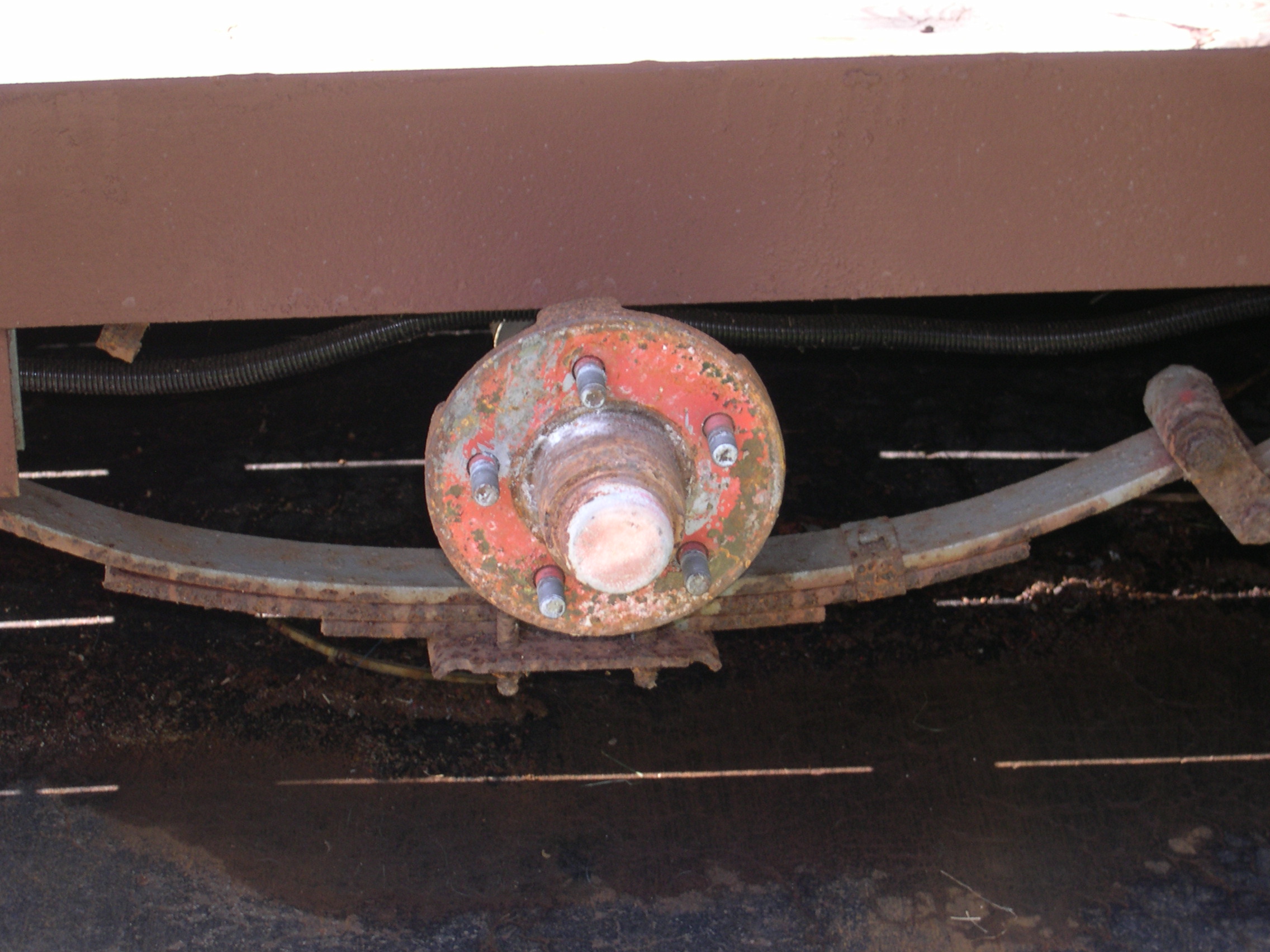

Well, a few months back I bought a used 14' tandem axle landscape type trailer to haul my BX and to pickup the occasional load of mulch, topsoil, etc. The trailer was in decent shape but the first thing I did was re-wire it since it had some bad connections and the existing wiring was pretty worn.
Next up was doing something about the rust-through on the wheel well skirts. The original thin gauge sheet metal had numerous rust perforations. So, given I don't work well with metal (don't weld), I decided to cut some 1/2" PT plywood for new skirts. About half way through doing the first side it dawned on me I might not have enough clearance between the tire and the plywood skirt. After sanding, priming and doing some touch up painting, I fit the wood skirt and re-mounted the wheels. Darn if one rubs and the other doesn't. The rear wheel with the drum brake (brakes not hooked up), clears while the front wheel doesn't.
I called around to see if anyone carries 1/4" PT plywood, but no go. So, I started looking into wheel spacers and did find plenty to choose from, but no one gives much for spec's other than the number of lugs. Here's an example though you can find them for sale elsewhere.
Amazon.com: Mr. Lugnut Automotive Wheel Spacers
The hubs are 5 lug with 2.75" spacing center to center for adjacent lugs. I probably only need 5-10mm of extra space. Any thoughts on which of these would work, or do you think I'm playing with fire adding thin spacers to gain clearance? How about some heavy gauge washers? :eek:
Pic's of trailer:

I don't see anything wrong with using those spacers.
Got a real problem with the way those blocks are stacked though. :(
/ Wheel Spacers for Trailer?? Opinions? #3
My experience with spacers is bearing wear. I would not use them but to each his own.
What I would do is chalk it up to experience and either put brakes on the other axle, really not needed but would solve the spacing issue, or have some sheet metal skirts made then welded in. They serve no structural duty so you could have about anyone with a welder tack them in. I would go to a heating and air guy with temp-lets to have the metal ones made then find a local mom and pop muffler shop and have them welded in. I would do it for free if you lived near.

Anyway, one vote for and one against spacers. I pulled the trigger last night and ordered a set of 5/16" spacers. One thing that confused me was how you measure the lug pattern for a 5 lug hub. Apparently, you measure from center to center on lug 1 and 3, or basically not CTC on adjacent lugs. Once I figured that out, I "think" I ordered a set that should fit. Will be here today, so I should know soon.
I'm not too nervous about mounting these 5/16" spacers since I don't use the trailer too often. Guess I'll take the chance on the added bearing wear.

Yeah, I found a similar how to via google. Received the spacers from UPS late morning. The good news is it fits. The bad news is that it looks like I need slightly longer lugs. One thing leads to another. :(! Guess I'll have to figure out how to remove the old ones and replace them with longer ones. Haven't even looked into that yet. Thanks for your help.

how do your wheels center ? are they hub centered or bolt centered ?
If they are hub centered, the hub should extend as far as the spacer is thick... otherwise they will run loose quite easy...
What are you getting yourself into ? buying spacers, buying longer wheelnuts, taking the drums off to change the lugs, and perhaps taking them off again to change wheel bearings...

I worked at a custom trailer shop where we used wheels of Iveco and Mercedes vans to get the lowest floor heights possible. We found out that we had to put 2 bushings over the studs to fill the space between bolt hole and stud, because the inner dual rocked between the brake drum and outer wheel, when the trailer braked. the outer wheel was held by the conical wheel nuts, but the hub centering wasnt enough to hold the inner wheel..
You can get into a lot of trouble with wheels, studs, etcetera.
Also, a guy that used to work at my company, way before i got there, had a Ford Granada with spacers, so he could use wide tires. More than once, he saw his rear wheel taking him over on the highway on-ramp because the entire axle shaft broke... :p
Same with a contractor around here, that has a tractor carrying a 3pt power harrow, air drill, packer combo. They used to have 18.4 duals under that tractor, but the offset weight caused the halfshafts to snap. They changed to 800mm wide rear tires to get the same footprint but with less offset. As long as they take bumps at walking pace, they are allright.
I would avoid wheel spacers at just about any cost. When talking 10 bucks per side, for me it would be a no-brainer... ;)

I decided to send back the spacers. Tried loading my tractor to see what would happen to the tire clearance. Drove around a bit and there was tire rubbing noise on and off, especially in turns.
So, change in plans. I ordered those fender skirts Skyco posted a link to above. I'll probably pop rivet them on as he suggested. I did look on line for skirts but the only ones I could find included the fender with it. Lesson learned - should have posted here fist before going the plywood route.

Question for you DP, or others. Having taken the rear wheels off and seeing brakes mounted to the axle with two green wires sticking out the back side, am I safe to assume I would just need to wire them up to a 7-way plug in place of my 4-way? The brake controller came with the truck, so I think I'm good on that end. Anyway to test these brakes before I spend the time/money to wire them up?
The guy I bought it from said he had some "stuff" for adding brakes but when I picked it up, the "stuff" was at his office. He was suppose to get it for me but never called me back, so I didn't even figure it had the actual brakes on the back axle. Kind of a nice surprise.
/ Wheel Spacers for Trailer?? Opinions? #19
There is an electric brake controller for the electric brakes. Some are manual, and some electronic. You have to set them up for the load you are carrying.
/ Wheel Spacers for Trailer?? Opinions? #20
To test those brakes just hook up 12 volts to them... It does not matter which wire is positive or negative and try to move the wheel while jacked up. If you want to add brakes you will need a 7 pin plug, and a break-away kit, about $35. Very easy to do.
