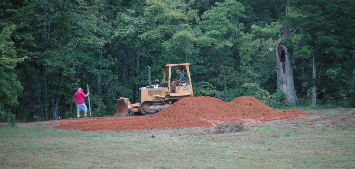

Chose to outsource grading to a contractor. Better quality than I would have been able to achieve on my own and in far less time.

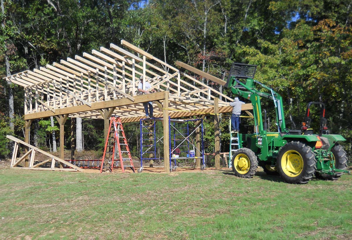

A box beam made from 2x6s slipped over one of the lifting forks creating a jib boom. Wouldn稚 want to attempt any heavy lift, but worked great for the trusses.
Trusses went up in a day with only one helper.

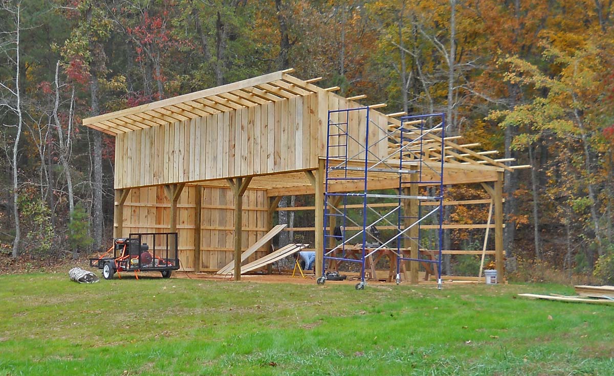

Overall size is 36 x 20?
Exterior siding is re-sawn yellow pine.

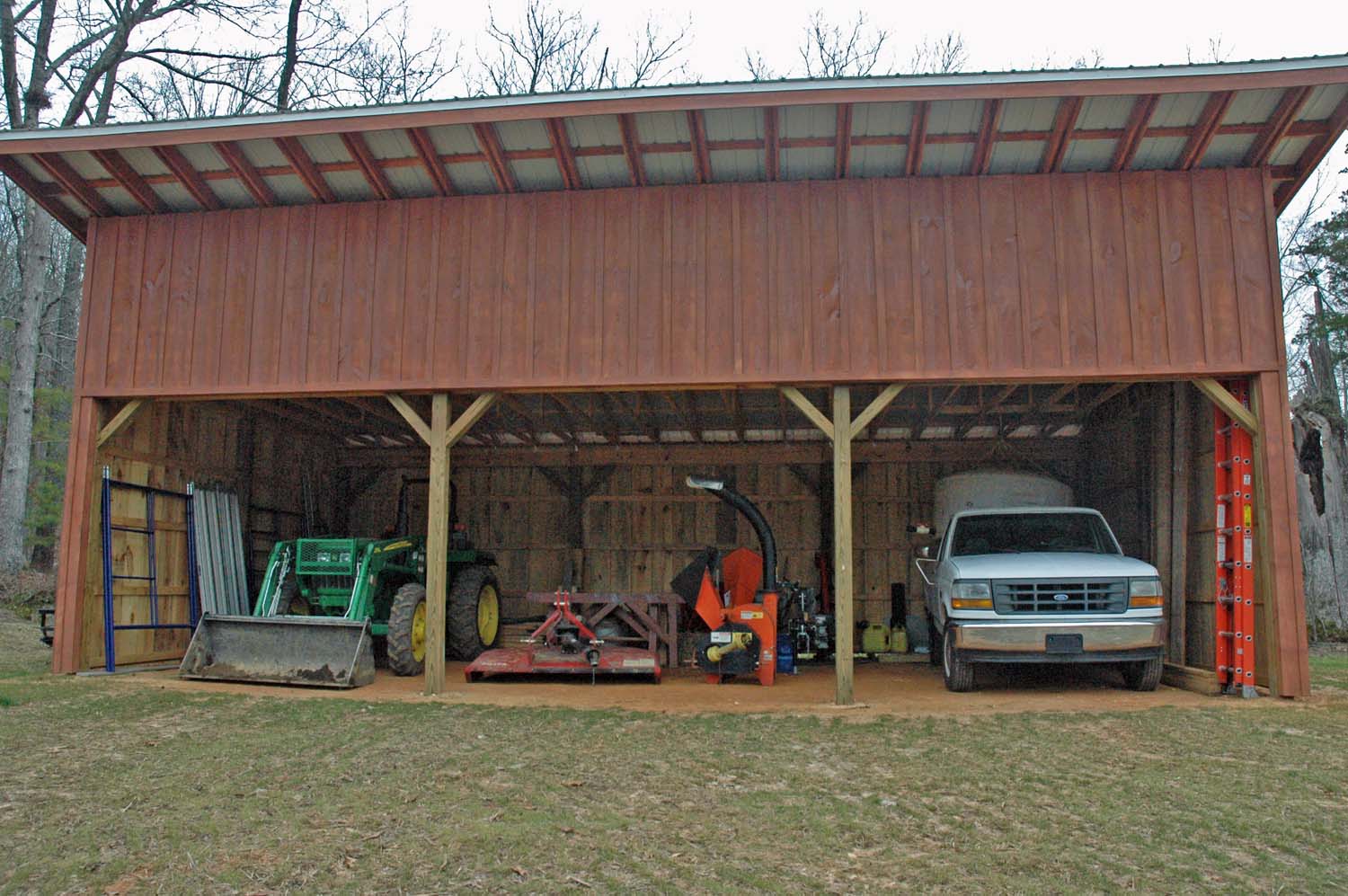

Move in day was about 2 months after starting. Had to work around my day job.

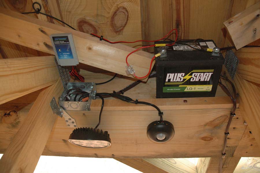

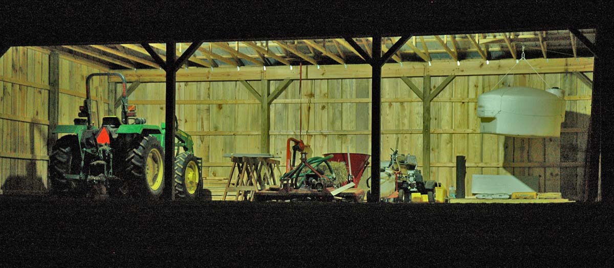

Last part of the project was lighting. Did not want to trench +300 to the house so electric system includes 15 watt solar panel, a garden tractor battery, 2-27 watt LED flood lights and a couple of motion sensors.
Let there be light.
