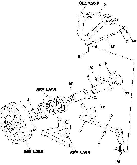

Here's an example of a dual clutch that provides independent PTO.

I don't know if you got a chance to look at the PDF attachments I posted earlier. it is exactly like what Rick Just posted. Two release mechanism, one inside the other, kind of like two input shafts in either "live" or"independent". I also posted the hand clutch mechanism as well.

i got it now. it's a foot clutch for one section and a hand fo rthe other.. 2 seperate release mechanisims.. but both stages of the clutch are up fron together..
not what i was envisioning much earlier with a 2 position foot clutch that operated both... or a single followed by another single down the line..

Yeah, it's the cheap way to make a live PTO independent.
   / What type PTO? #35
yep.. economy independent pto via a 2 stage clutch. and since the hand lever isn't tied to the foot clutch in any way like in a conventional 2 stage clutch you can cl;utch the pto any time drive train going or not.. so .. really.. independent in the full sense..
i'm kinda surprised this didn't come out as independent pto in this form way back when 2 stage clutches first hit.
