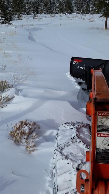

I take back what I said about maybe being able to use a 7 ft blade. That wouldn't work for me at all. Here is a photo going around a bend to the left. The edge of our driveway roughly follows the drift. You can see the front wheel is turned at the angle needed to make the bend, and it is outside the plow even with the 8ft plow. I forgot how noticeable that is on the sharp bends.
