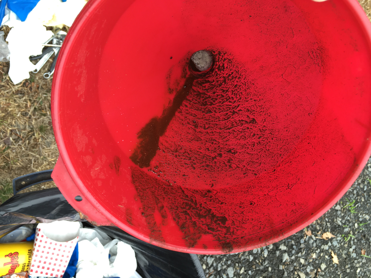

This is exactly what I just found yesterday. It looks like tiny pieces of rust in the form of grains of sand attached to tank all the way to the bottom. You can easily scrape some off with a stick etc. I drained the tank and it looked like muddy water coming out. Flushed tank with clean diesel fuel a couple times, replaced filters and fuel shut off valve and got her back running. The new fuel I put back in has opti-lube Ag formula with biocide. Will see what this does.

This is a small sample of what came out. There was ALOT more of it though. Mud looking diesel fuel.
I'll try to drain mine soon. The stuff in your photo next looks like what mine probably looks like inside the tank.
