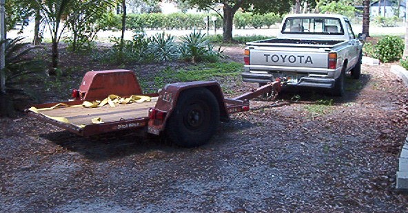

Do you really need a full 16 feet to move the 2910? I'm new to tractors, but I've been using trailers for a long time. I'm towing a B6000 with some implements and misc on a Ditch Witch model S2A trailer, rated at 2900 lbs gross weight. It's only 8 feet long, and 6 feet wide, but it has a very long tongue which would allow a loader to sit in front of the deck. It's a single axle tilt back trailer, and it very sturdy for it's size. It also has 30" tall tires to keep bearing RPM at a minimum while on the highway. I tow it behind an 2800 lb 83 hp Toyota pickup, rated for 3500 lbs and 350 lb tongue weight. It works fine, and I suspect if the B6000 had a loader on the front, it would still have enough room to turn the truck without hitting the loader on the tailgate. See pics.

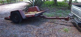

second trailer pic

I don't know how big a B6000 is, but wouldn't a B2910 pretty much squash a trailer that small? I'm pretty sure a B2910 with FEL would weigh more than 2900 lbs., too.
   / What is the smallest trailer I can get away with? #28
The B6000 is about 900 lbs. I guess it's smaller than a B2910? It's a B series Kubota, but it is older, so maybe it's smaller too? Really though, the trailer has a 2960 gross weight rating, and it only weighs about 400 lbs, so it should carry a B series with a loader. I can't see a B series with a loader weighing more than 2000 lbs, but I'm guestimating, so I could be wrong.
Bob, I bought that trailer on ebay for $243. It needed wiring and new deck wood, so I put about another $100 into it. It's made by the Ditch Witch corporation (or whatever thier parent company's name is). It was built by a machinery company to carry thier smaller trenchers continuously, every day, all week long. That's why I trust it to tow whatever I want. I towed the B6000 from Orlando to West Palm Beach with no problems (200 miles?). I originally bought it for other stuff, it just happens that the Kubota fits on it nicely. Maybe a used high quality trailer is an option for you? A cheapy junk trailer is a waste of money, but a used trailer built for other specific purposes (like mine) may be a good, lower cost, option. I guess it depends on what you want.
