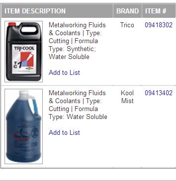

Water soluble coolants.pngThere are water soluble cutting/cooling aids such as pictured, as well as solids and "eco" friendly aids ... Buy CE-16 AGS Metalworking Fluids & Coolants from UseEnco
and, of course, if you like the smell of french fries, there's always lard or equivalent
