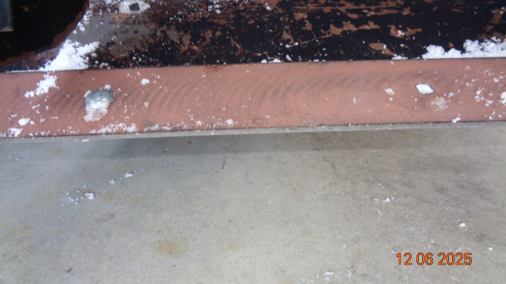

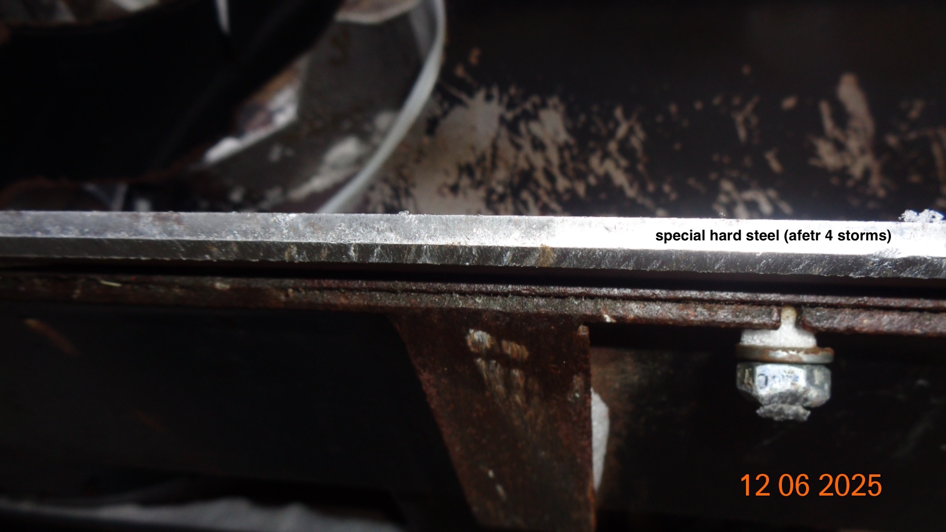

2) First report on the new hardened-steel blower scraper blade:
A) In the past, using the OEM mild steel scraper blade --and remember I take mine right down to the pavement surface, with no "feet" on the blower at all-- I get about three "edges" used up per season. That is, after some usage, I flip the scraper around and use its other edge, then have to replace the blade altogether before the end of the season.
B) What happens is that the starting-out "square" edge. 1/4" thick, first gets ground off to a knife-edge. As it gets worn further, it eventually begins to grind off the bolt ends on the underside of the blower housing, then the nuts. Yes, I keep a jar of replacement short carriage bolts, washers, lock washers and nuts on hand.
C) So far, I've used the blower for four "snow events," each of which entails a number of trips up & down the driveway as well as a large turn-around area at the bottom in front of the garage.
D) Did my first inspection today -- so far it looks great, with only about 1/16" worn off the bottom front edge of the 1/4" thick blade. Ordinarily, I'd be looking, after four uses, to see if it was time to flip the blade around yet!
So it remains to be seen just how much longer this expensive hard steel blade lasts, but it's looking very good so far.
