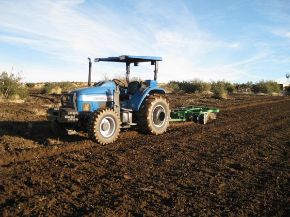

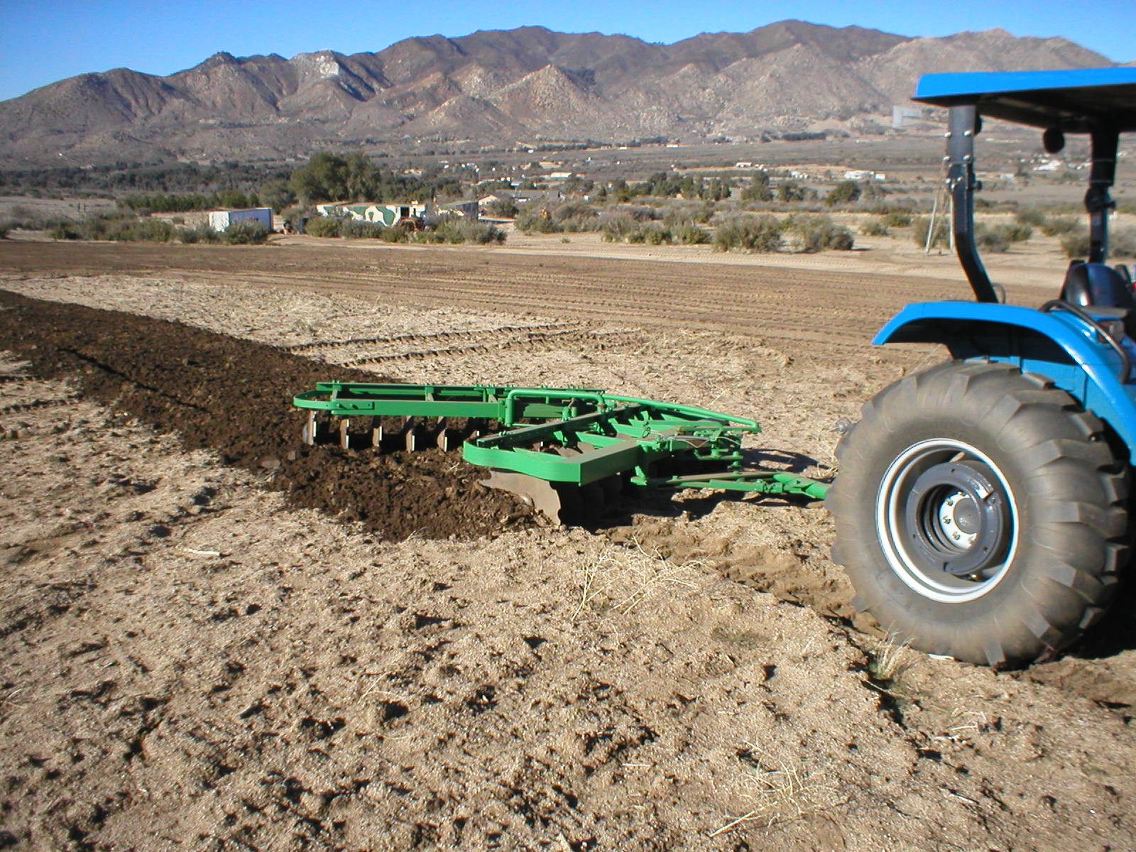

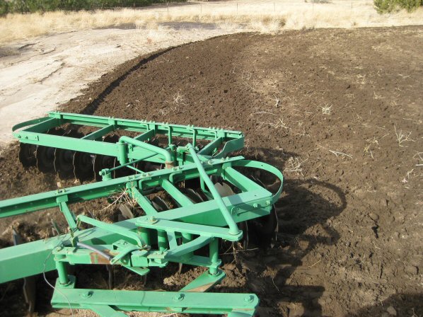

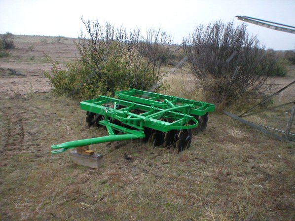

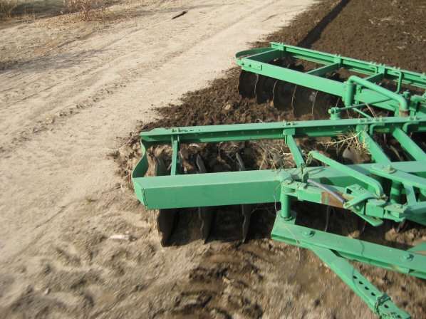

There are so many variables that without more info from you, all you will be getting are guesses and general suggestions. You think that a 6' disk is small and yet I could probably show you one that you could not even pull. I have seen 12' disks that require a D8 to pull.
Pictures and a description of your grounds really helps. Are you wanting a wheel transport disk, or an old simple pull disk? I have a 75HP tractor that weighs 10,000lbs without the loader, I pull an old 8' Kielfer-JD disk with 22" pans. Most of the time I barely know the disk is back there and yet at other times, if the ground is just right and going up hill it's all the tractor wants.
