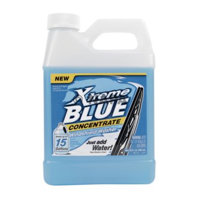

Thanks for the info James. I've attached the MSDS for it and a pic. From what I can see it looks like the only ingredient is methanol (colored blue). Is this what you saw on the NAPA site? What are your thoughts? Is this any good? It's listed as NAPA part# BK7654201 Xtreme Blue

I found this quote on another forum.
Has anyone looked at Xtreme Blue Concentrate? It is a 16oz bottle that is intended to be diluted. Looking at the mixing chart, it suggests that to make a -20 degree fluid, you would mix 16oz of concentrate with 8 oz of water. If we assume the resulting mixture is the typical -20 Xtreme Blue fluid at about 35% by weight (38.9% by Vol), that means this bottle undiluted is about 52% by weight (58% by Vol).
If the above statement is correct then it might take more than 10 bucks of that stuff to get the mix right depending on how cold it gets where you live.
   / Washer fluid for rear tire ballast question #7
yep, it looks like it is 3/4 methanol, but there just isn't enough of it to do any good.. You are going to have to buy a lot of bottles of this stuff
   / Washer fluid for rear tire ballast question #8
Without actually sitting down and doing the math, you are going to need about 25 gallons. of this mix, so 100 containers approximately. So about $200 of this stuff.
