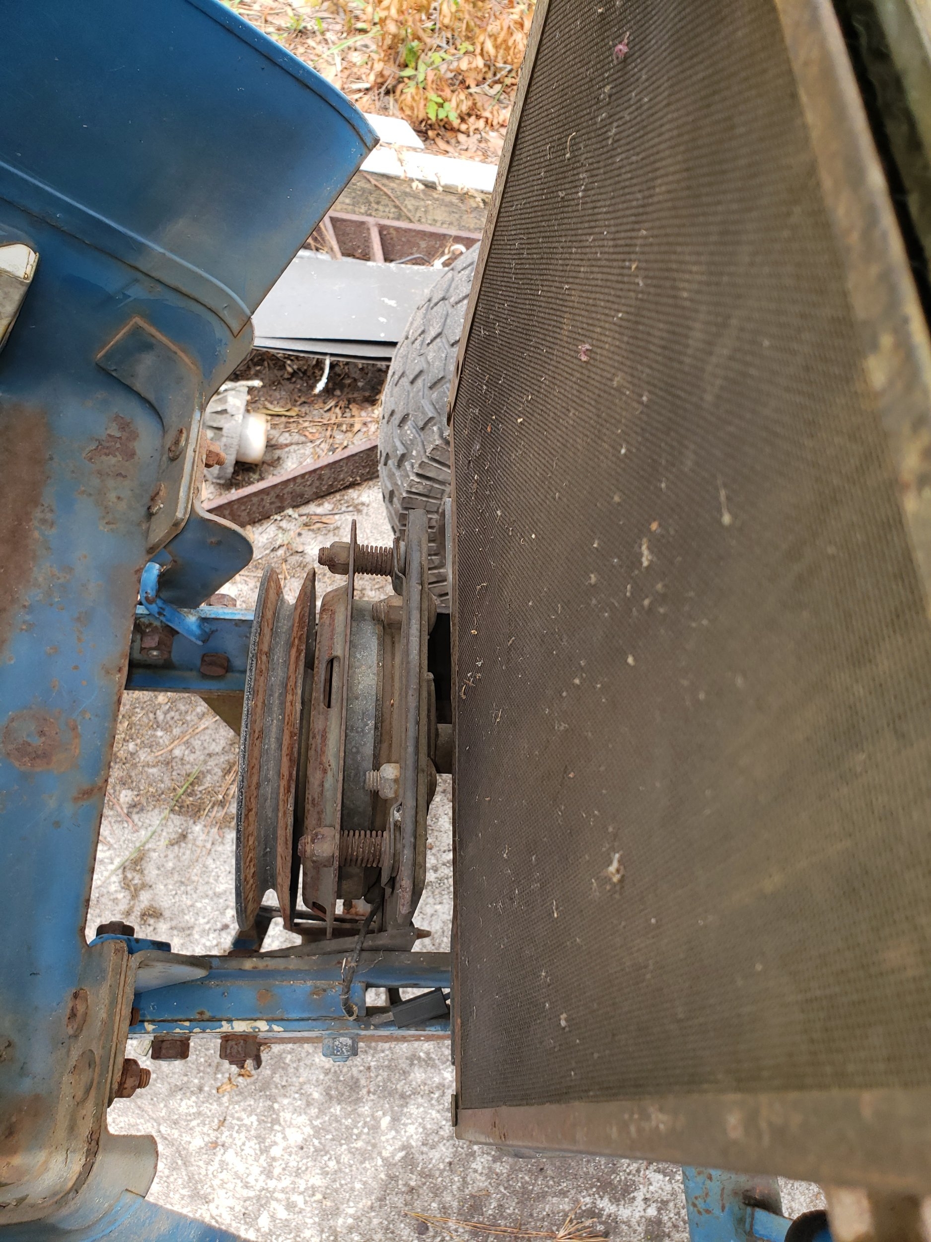

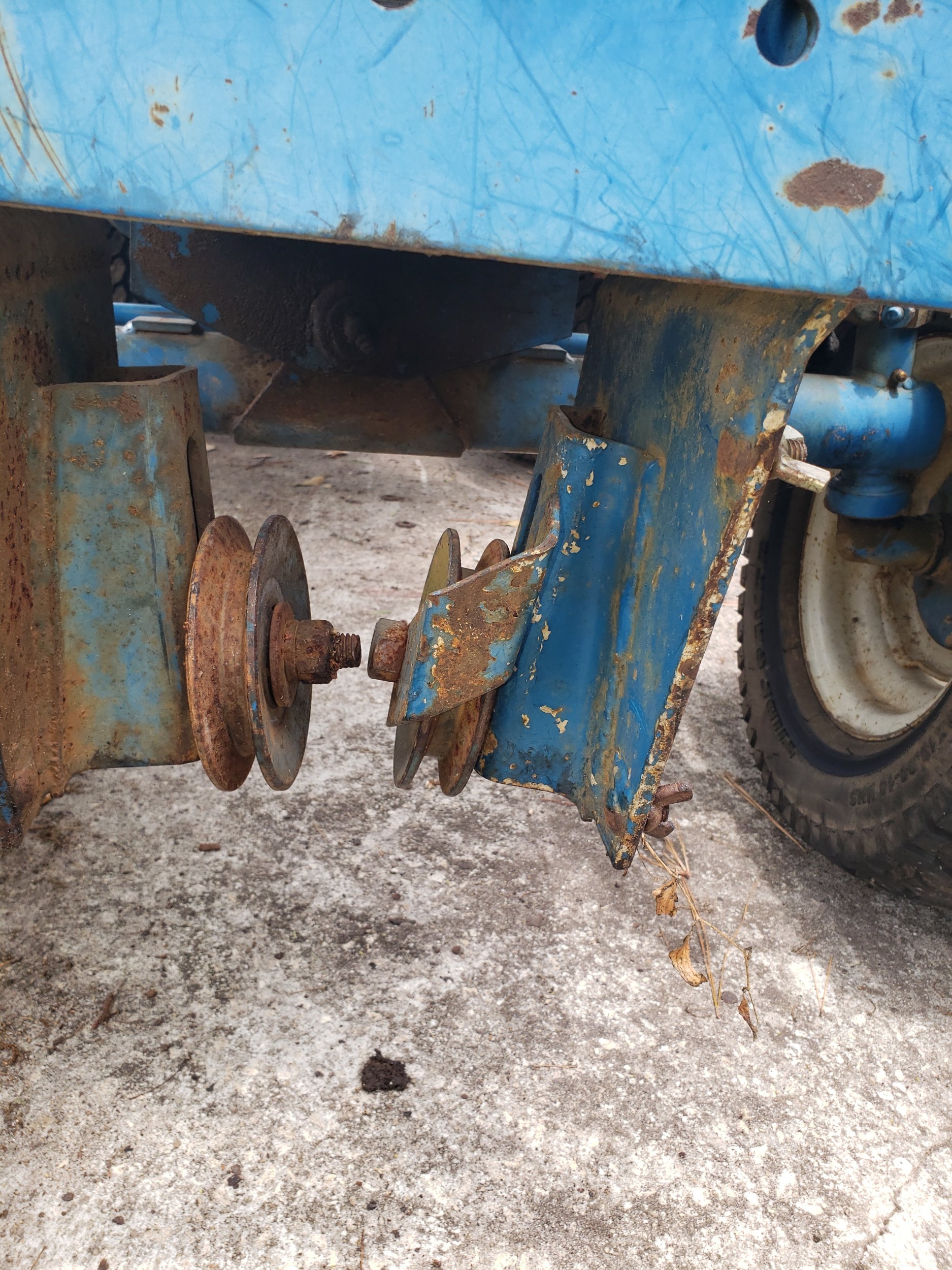

My Ford 1210 has a front pto driven off the front crankshaft with an electric clutch to activate it. That is what powers the deck (which I don't have). The rear lift arms have cables that go thru rollers to raise and lower the deck, by using the 3 point lift lever.

Thanks Sandman2234 for reply and comments, any chance of a few pictures of the set up on the front crank connection. I have seen a u tube video of the cables connected from the 3pt hydraulics. The output speed of the underbelly PTO is 2000rpm when rear PTO is running at 540rpm.
   / WANTED, WANTED, WANTED. #8

Hi, Many thanks for your time and effort.
