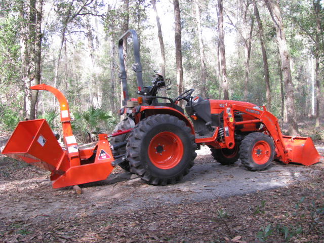

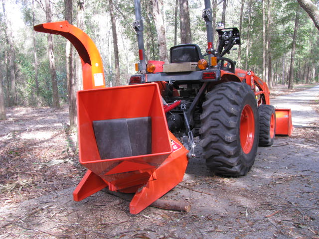

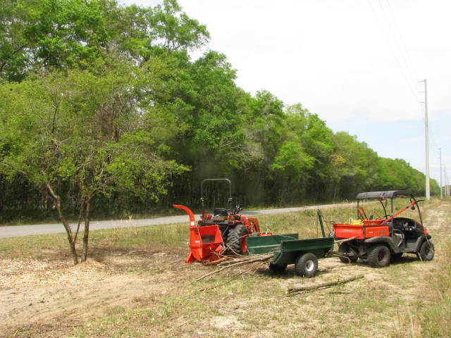

In two years of regular use, chipping more Oak than anything else, I have never snapped a shear bolt. Not even sure my BX42s has a shear bolt. Wallenstein makes The Best, they go on and on and on.
Buy the BXM42 for its heavier construction. You will be glad you did.
Your L3240 will power either Wallenstein model easily.
