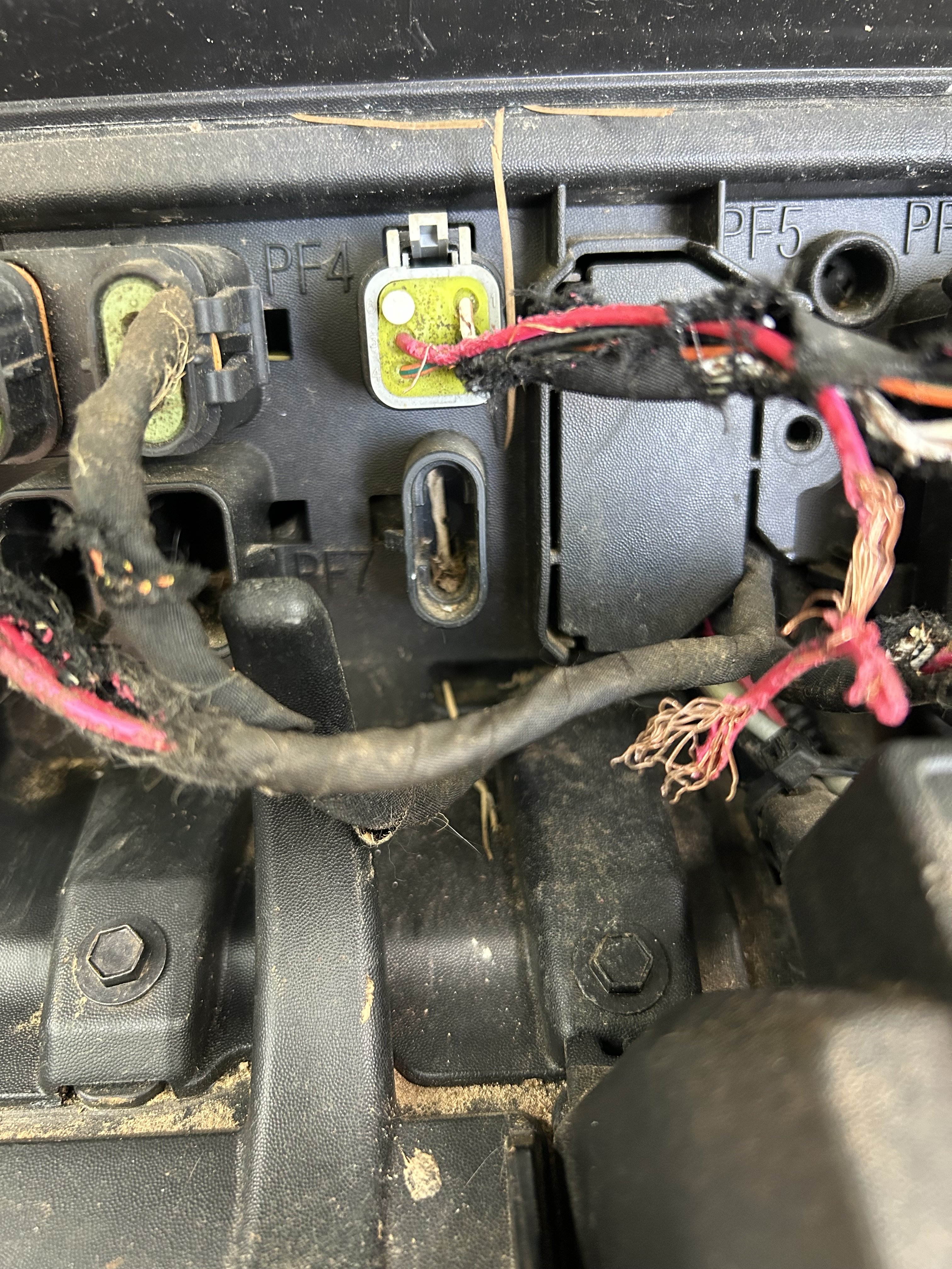

Been a little bit since I checked on my tractor up on the hunting lease. To make a long story short found some wiring that had been chewed up?
The barn cat ain’t working so does anyone have any recommendations? I ran across several products online at Tractor Supply but would like to get some real world advice before throwing money on some of the “snake oil”.

Snake oil is just what you need. Maybe some Eastern Ratsnakes would keep the mice away.
   / Varmit Proofing #3
i've heard mothballs work. And stop feeding the barn cat so he gets hungry.
   / Varmit Proofing #4
I had that problem with my car. A box of D-Con behind each headlight gave them something to eat besides insulation. Mice gotta eat, too. When the box ran empty they went back to the insulation.
   / Varmit Proofing #5
My dozer sits in the woos. Never got wiring chewed - knock on wood - but the dash board box and the battery box were always full of mouse nest stuff. And I mean full. I used D-Con and they would carry the whole box away, over and over again. Then I switched to GranpaGus pouches. I put them in the dashbooard and battery boxes and have not had a problem since. Switch out old packs for new a couple times a year. Fall and spring.

   / Varmit Proofing #6
I was going to suggest Weather Tech Liners, but I misread the title. 😖
Now that I re-read it... moth balls in mesh sacks. Just be sure to remove them when operating so they don't get cooked. They give off toxic fumes.

Get a better barn cat.
   / Varmit Proofing #8
I wish you well. Personally I mix up two tbsp of one million scoffield concentrated pepper extract with 16oz of water in a spray bottle and coat everything well. Wire, harnesses, popular places for nests and the like. It works well for my equipment and pickup and the extract does not cause any corrosion or permanently stain anything. The wife says her use of spearmint or peppermint essential oil works better. Frankly, I think they both work but the pepper extract doesn't dissipate as quickly. We have had huge expenses related to rodent problems over the years not to mention you machines not working when you need them most.
P.S. if you use the pepper extract you do NOT spray if there is the least air movement and you really should wear gloves. It does NOT wash off with soap and water. GOOP abrasive hand cleaner works well though. And you WILL wear gloves when working on your equipment from that point forward.
