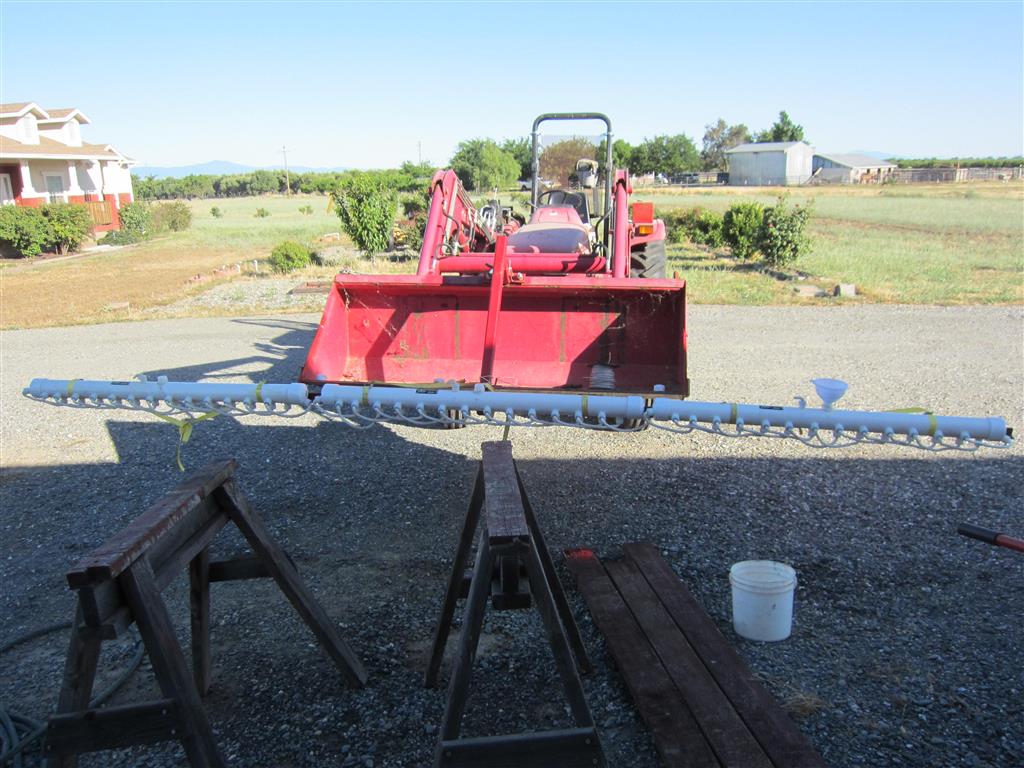

As mentioned in the thread spray only weeds that are green and growing. I have also read to spray only when you expect several hours of sunshine on the sprayed plants. Glyphosphate impedes the ability of the plant to absorb oxygen needed for growth, or so I have read. Somewhere on the net I saw an applicator. PVC pipe joined in the shape of an L with the long section about 30 inches long. The short section had a cotton rope pushed through holes drilled on each end. Herbicide was poured into the long section and the rope became saturated. Then the rope is dragged over the leaves of the offending plants. More precise than spraying ??
   / using Glyphosate killing weeds before preparing soil; vegetable garden ?? #17
They are called wick (or rope wick) applicators. You can buy them in various sizes (from hand-held to tractor-mounted) or use available plans to build your own.
Steve
   / using Glyphosate killing weeds before preparing soil; vegetable garden ?? #18
   / using Glyphosate killing weeds before preparing soil; vegetable garden ?? #19
Steve

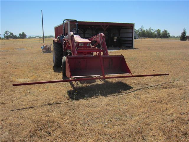

They're called wick/rope applications or weed wipers. Here's mine.
The modules are 5-ft wide and cost about $100 each. A pretty simple system to rig up. I used mine to control fiddleneck weeds in my oat hay using Roundup.
