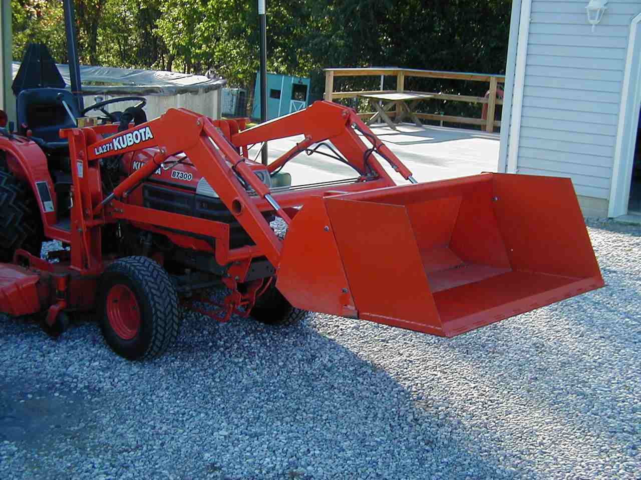

I use a rear blade for most (under 8") snow moving. I use the loader in drifts (gets deep in one section of the driveway). This fall I made a bucket extension to increase the capacity of my 7 cubic foot bucket to somewhere near 15 cubic feet. Made it out of left over metal and it just bolts to the bucket. (light duty only - snow and mulch)
First snowfall (last week) it worked like a charm. Holds lots more snow.

About how much rear ballast for the extra bucket attachment..or rear ballast not needed.
   / Using a FEL to plow snow? #46
I have Liquid in the rears (24 gallons total), and 150 pounds of barbell weights (6 X 25 bolted to the rears) and a 6' Rear blade.
Should be enough.

The bucket extension attachment for the loader has two skids that will keep the lip of the buchet 1" off the gravel, so the stones stay in the driveway.
