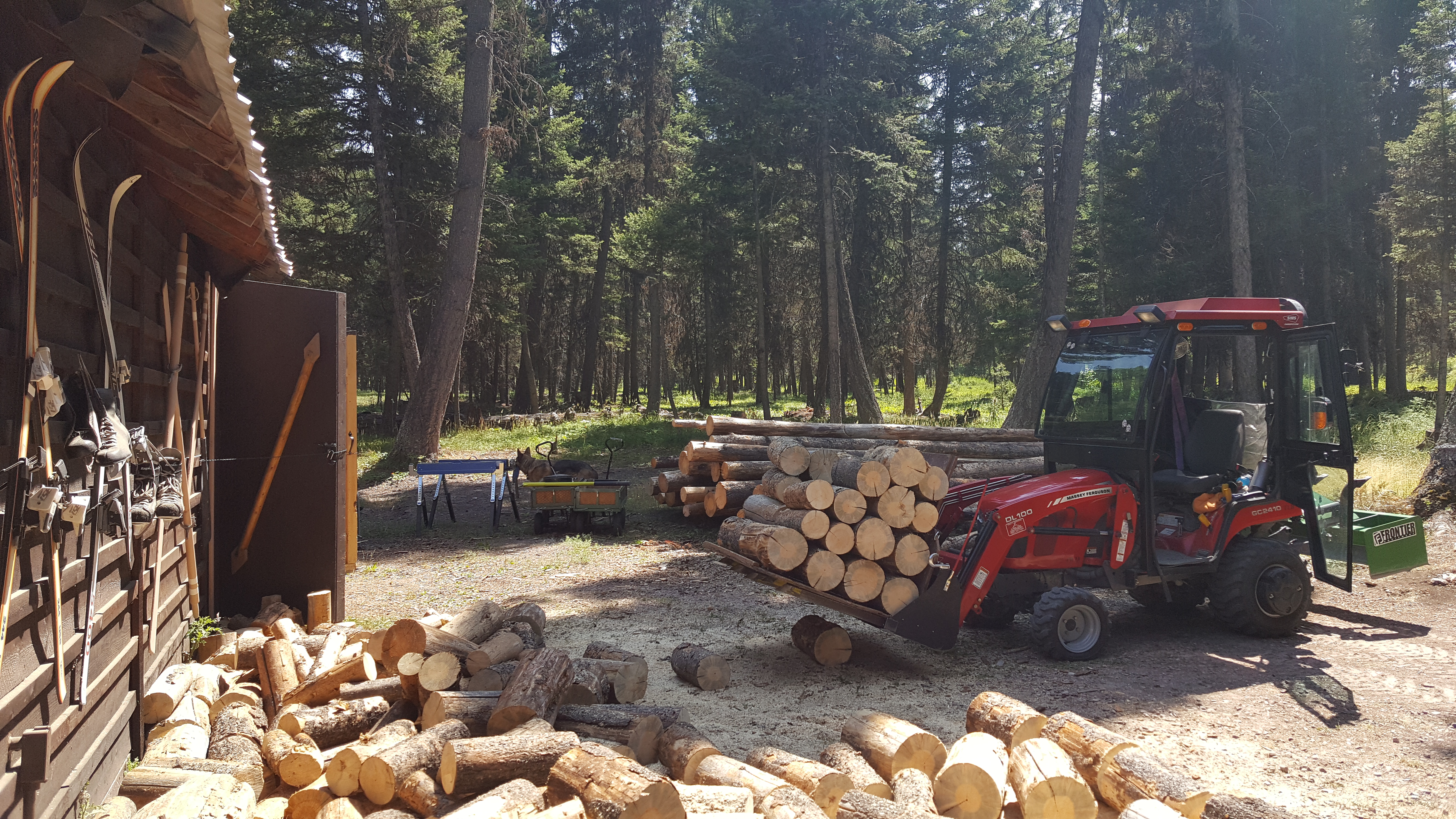

You possibly could have the loaded pallet (loaded upper pallet slightly offset towards the tractor overhanding slightly from the empty pallet) sitting on top of an empty pallet, and then insert your forks all the way into the upper pallet with the load, and then raise your forks up to contact the pallet, then tip your forks back to create space from the empty pallet? This should give you enough ground clearance to move the load? Unknown what product you are trying to lift, possibly you could shift some of the weight towards the bucket while it's still on the loaded pallet?
I have done a similar process with a couple of 8" log rounds laying on their side under my bucket platform extension I built to load up with firewood rounds and move into my woodshed.
Good luck finding a solution, KC
