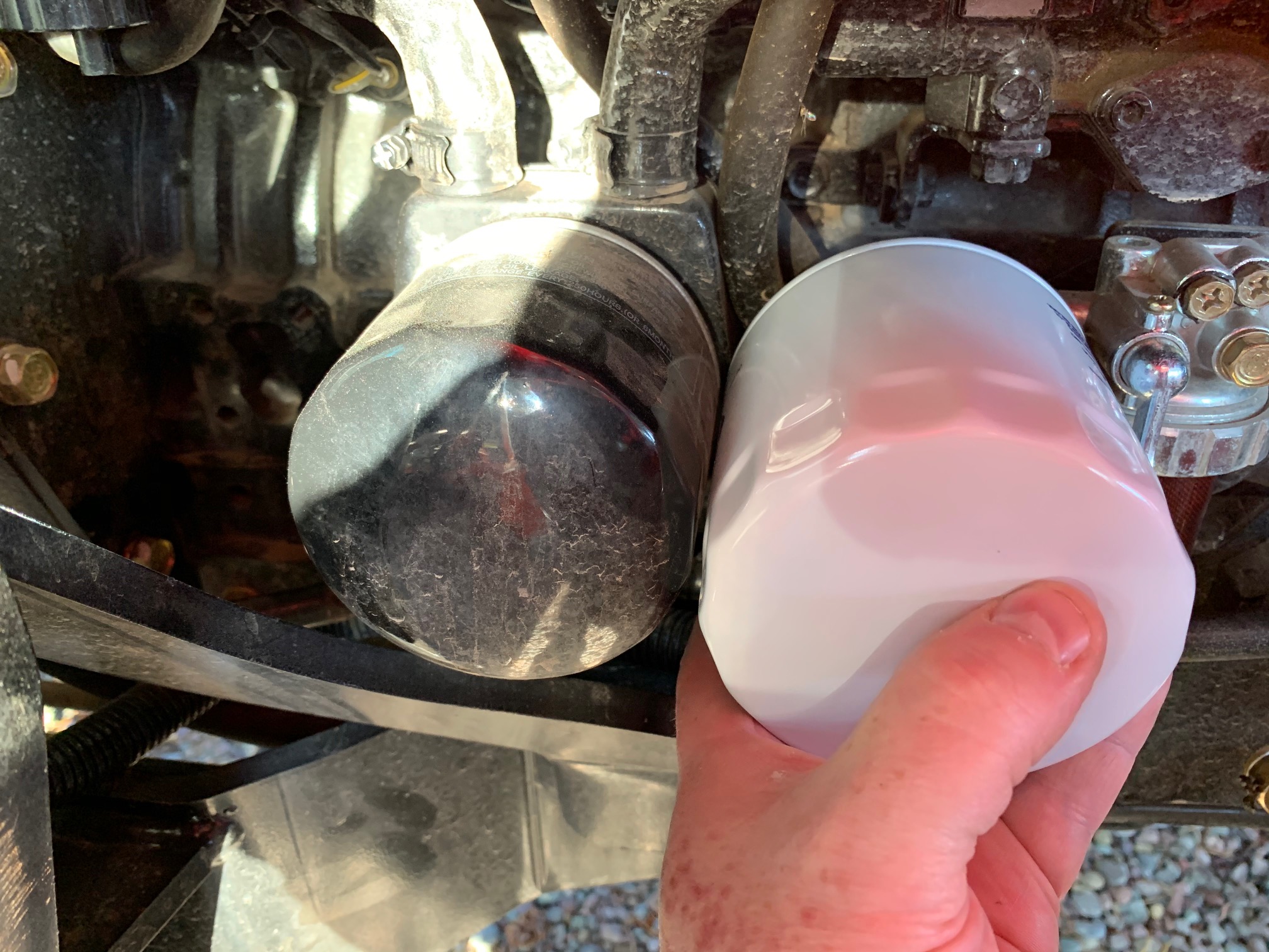

I'm going to change my oil/filter in my T474 with the Kukje A2300N2 this weekend with 25h on it, I finally cross referenced a NAPA 1626 (Wix 51626) filter that will work, it is even a smidge longer than the stock
View attachment 671581.
