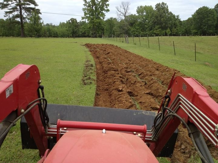

   / Two bottom plow. ford 640. #9
Nothing like plowing new ground on my Mahindra 2816
   / Two bottom plow. ford 640. #10
gilsimp,
Looks like you have a 1x14". Next spring I have about 40 acres to plow with my 3x16's. Plowing is what I really enjoy doing day or nite.
idaho2
