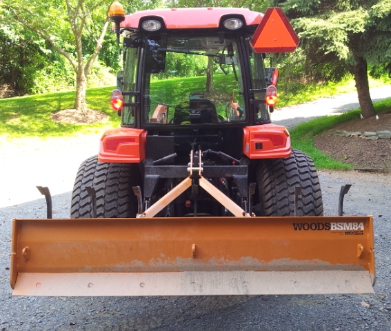

I知 in the market for a new NX6010hst. I知 really leaning towards turf tires for this tractor, I feel they would do better on my property than industrials, and ags are out of the question due to rutting up my yard.
The dealer I talked to today had never ordered a larger Kioti with ags. What options are available for this style of tire through a dealer, he will have to order what I want from Kioti. I have read on here that someone got their NX with Titan brand turfs, and they were very wide tires, which is what I am after. I also saw mudplugger has some wild looking hybrid type big turfs that look appealing. I did not see a way to contact him directly.
Any info is greatly appreciated.
   / Turf tire options for a new NX6010hst #2
If wide turfs are what you want, I think you'll like the Titan R3s that Kioti offers as their option. 84" sidewall to sidewall in the rear; track is about 82" wide. Very aggressive lugs. Outstanding in snow and on rough ice. Because of their size, though, don't plan on hauling without a deck-over trailer or a rollback truck.
Here is a pic of the Titans on my NX4510 HST cab. As you probably know, it's the same tractor as the NX6010 HST, but with the fuel delivery detuned to 45 hp, and without the cat 2 hitch and lift arms. The BB in the pic is 84", although it looks bigger due to foreshortening by the camera. It covers the tracks nicely.

Thanks Threepoint. That picture helps a lot! They look nice and wide, just what I知 after.
I already have an older Pequea 10k deck over, so I知 good on the trailer.
If I pull the trigger, I値l need to make sure it痴 defintiely coming with those Titan turfs.
