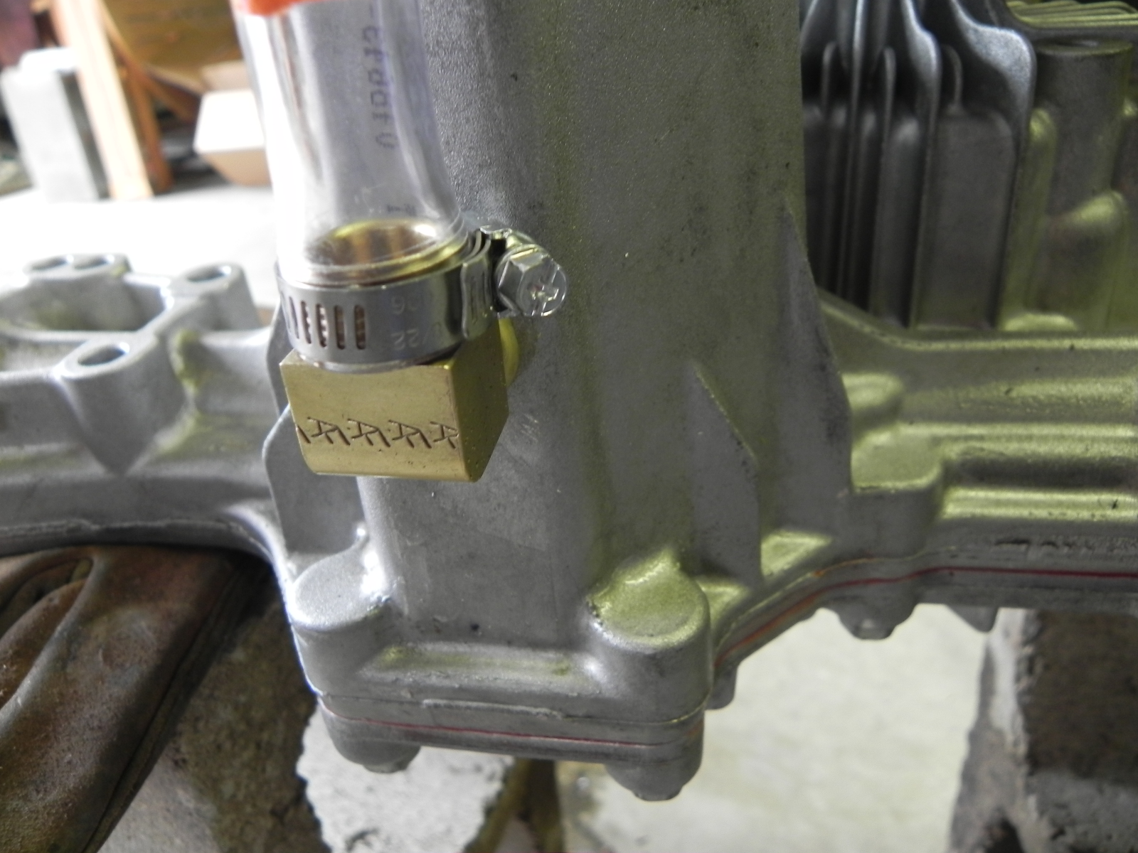

Good morning,
Removed the unit after 1.1 hrs of run time since installing the shims. (Prudence would suggest an internal inspection after such modifications)
Everything looking good, unit running very well. Warm but not so much that the hand cannot remain on the case after 1 1/2hrs of pulling
the tractor, ~500lbs, rider ~200lbs and 1/2 container of damp grass ~100lbs.
The oil darkened slightly but that was probably due to the oil that had remained in the hydraulic pumps.
Also a very small stream of silvery metal particles, (not at all the amount in the first oil draining) also due to the oil that had remained
within the system.

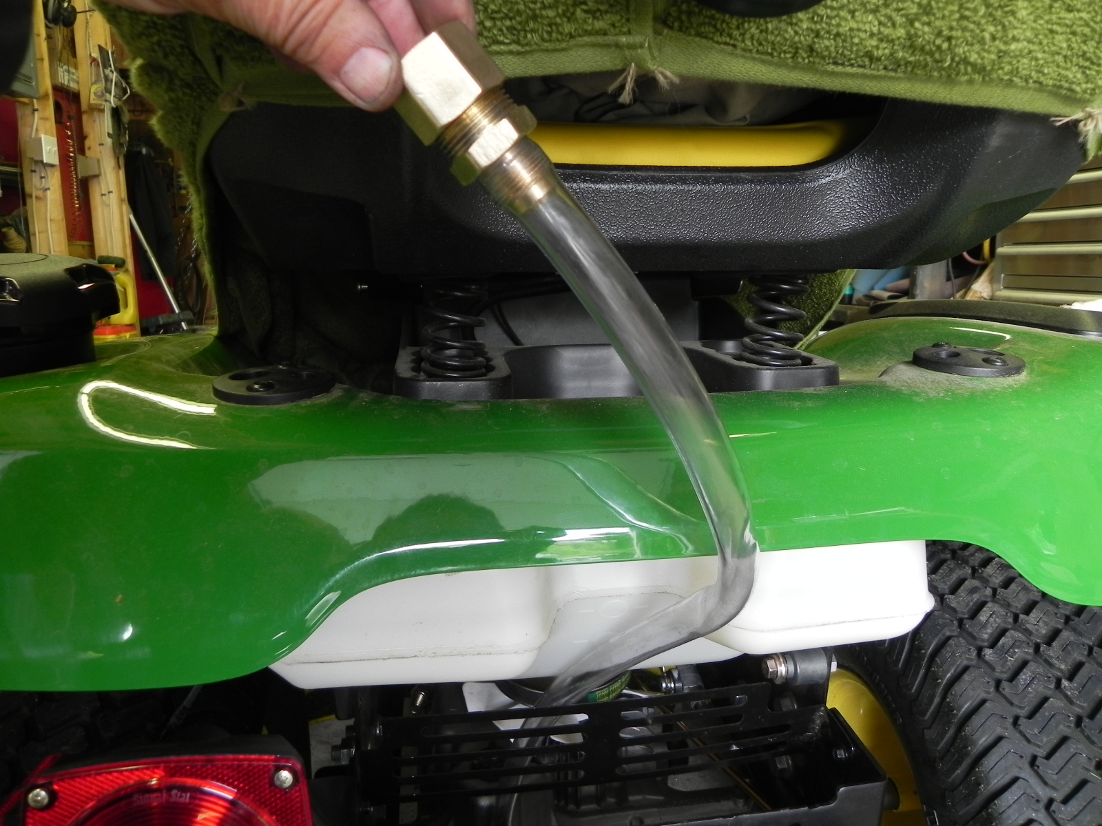

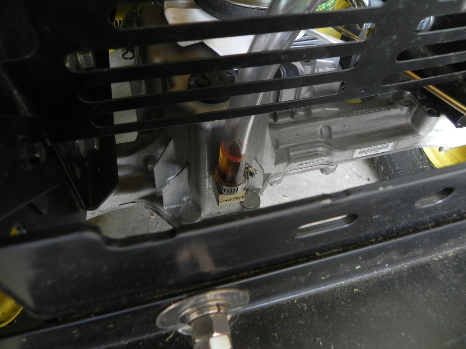

Installed a fill tube, (photos included), with a mark on the clear tubing that indicates the level of the oil.
The tube acts as a filler neck and a sight glass.
The unit was filled with the recommended amount of oil, (used Mobil 1 5w-50 synthetic), 2 1/4 qts which brought the indicated level
to the factory specification.
A curious action of the oil level once the unit was in service.
After running for roughly 1/2hr the level was observed in the tube to be 1 inch higher ?!
Then after running for another half hour the level of oil was not in sight ?!?
The oil had risen 1 inch and then dropped 2 inches ???
Later after the tractor had been parked and cooled off the oil level was back at the normal position, odd.
It occurs to me that the engineers that had designed the other units that incorporate a reservoir tank must have concluded
that any air within these units is not to the benefit of the hydraulic function. (Now noting that the oil level does rise and fall)
With the reservoir tank the oil will be held higher than the internal volume of the unit, (Archimedes, "liquid seeking its own level", I believe).
With the observed action of the oil from the clear sight tube it must be that under changing conditions of temperature and load the oil level
will rise and fall. If the unit is not purged of air at the factory then it might be possible that the unit could run low on oil under some conditions.
Also if we observed the sectional side view of the blueprint of the K46 unit we can see the that the upper level of the pump which feeds the hydraulic
motor may possible be exposed to the air which is contained in the unit. If there is any negative suction in the vicinity of this pump around the pistons
or mating faces it might be possible to draw small amounts of air into the hydraulic circuit which would then be thouroughly entrained within the fluid stream which would then degrade the overall hydraulic action.
This then would probably cause stress to the oil itself and probably create an increase in operating temperature since the unit will need to work harder to perform the same amount of work.
It DSCN0421.jpgDSCN0425.jpgDSCN0427.jpg cannot have been lost upon the thought process of the design engineer that ANY air within these units will not be beneficial so therefore this is probably the reason why we see the reservoir tank on the [upper] level models to ensure that all air is sooner or later purged from the unit while in service.
It might then therefore follow in our thought process that there may be no reason for the K46 to have received a bad reputation but for the simple facts that without the ability to change out the oil along with the additional function of being able to purge all of the air from the system that the K46 is in fact not able to receive the basic service due any precision piece of machinery to facilitate a prolonged period of service and reliability.
Cheers, andrew

Nice write up again P901.
I wonder if you just used the tube as a reservoir, meaning you could fill it above level but leave a small amount of air at the top. Keeping it upright of course.
