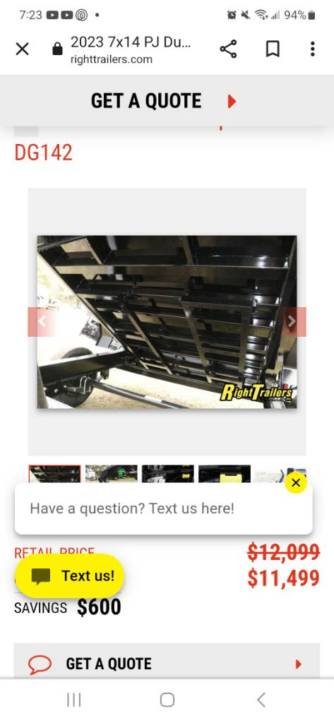

I'm not saying it will sell for that, but unless it's pristine, I would look at new, if you're paying almost new prices. I know stock can be a problem, but I'm seeing a lot of new 7x14, dual 7k axles, in-stock at $11,500 to $13,000 within a 50-mile radius with a quick search.
Now, what I can't comment in these I see, or this auction one is the little things that might make or break it for your use case, like slide out ramps, angle of approach, how high the skid steer rides above the axles, dump angle, tie down points in the dump bed, ect.
