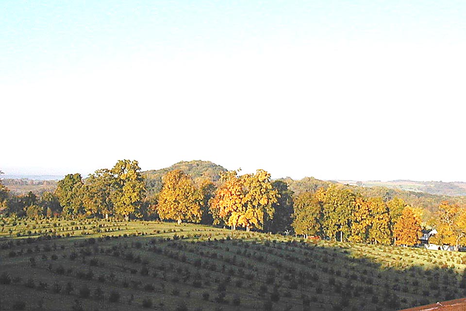

I planted about 3500 seedlings 4 years ago (pic attached) of red oak, white pine, white spruce, and ash. Had near 100% survival, but deer ate the buds on the red oaks for the first two winters. Then last year I covered many of the buds with paper popcorn sacks (stapled on) and they didn't bother the oaks until I removed the sacks. Then the deer fed all summer on the new leaves. The deer also fed well on the ash. Then this fall, the bucks decided the oaks were the right size for a good thrashing - some literally torn down to the ground so there was nothing left but a short stub. I plan to relocate the trees into grove-like areas. I plan to do this with a tree spade. We'll see how well that works. The spruce are doing very well, and will be far ahead of the oak in no time.
I spray pre-emergence spray around the trees in the spring, and that takes care of grass and weed competition most of the summer. A bit of upkeep with the mower late in the summer, but not bad. I mow between the rows, to allow the hawks to keep the mouse population to a low roar. They like to knaw on the bark in the winter if snow and weather permits.
