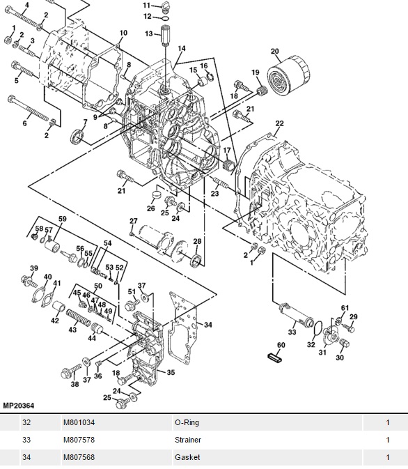

where is the location of the hydraulic oil filter and suction screen on a 4100 JD
Thanks
   / Transmission Filter and Suction Screen #8
Anytime I change the oil in my Ehydro I always clean that screen, it's not a bad job to do.
   / Transmission Filter and Suction Screen #9
can anyone show me with a photo where is the location of the hydraulic oil filter on my 4100 john deere ?
