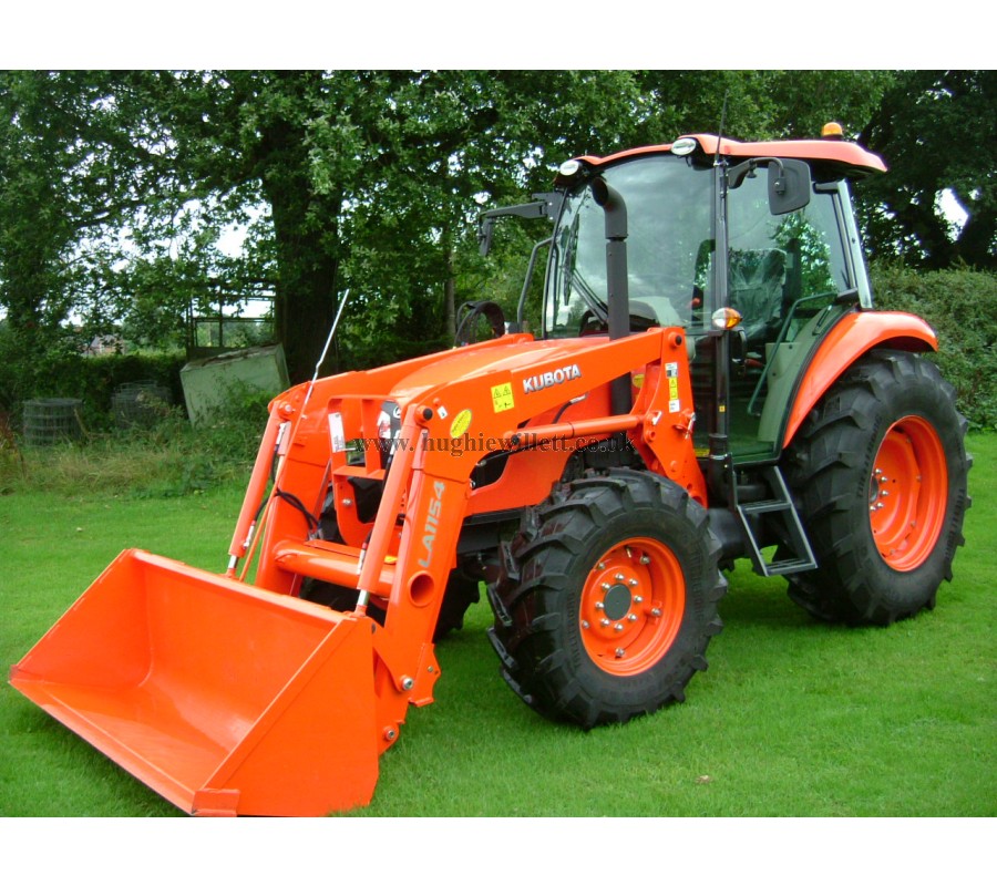

Planning trading my 2007 M7040 for a new M7060 HD12 with cab.
Still unsure on tires. Use the tractor for loader work on hard surface, mowing 15 acres of horse pasture.
Also grade riding arena, haul fire wood, push snow on 400 ft paved driveway.
Have R1's on the old machine and want to get a more turf tire.
If you Get R4 kubotacputs a short 24" rear tire on.
If you get turf tires you get a even smaller rear tire.
I thinking of getting R1 's and swapping them for Nokian Tr1-2 all weather traction tires on the rear and a loader style tire on the front.
Does anyone have a m7060 with the turfs and how do you like it?
Can it move in any mud?
Thanks

I have a new M7060 due to be delivered this week. I upgraded to radial tires which will get the wider front tires. They do not show as an option in the USA but my dealer was able to get them.
Mine should look like this:
   / Trading in M7040 for M7060
Amy dealer also can order with the wider radials. I wish I could test drive a turf tire M7060 to see much it is effected by the much shorter turf tires. They are about 35% smaller so top speed of the 12 speed will be reduced from 25 mph to about 17.5 mph. I don't think Kubota installs different gears for the tire options.
I wonder if just switching to wider radials will help some with rutting in the field but no matter what it still is a 6500 lbs tractor with the loader.

Get the Metric Radials, R1-W
I have yet to make ruts with them in the field, in places where the 2wd on bias ply cuts the ground to pieces

Decided to go with a open platform vs cab, it seems some days I climb on and off the tractor 25 times and really did not want the hassle of climbing in a cab.
Ordered m7060 with two remotes, weights, rear light, loader, 84" bucket, front bucket hyd control, radials, creep gear, and low exhaust.
Should have it in a few weeks.
I got a good trade in on the 2007 M7040 of 25K, new machine was 40.5K.
