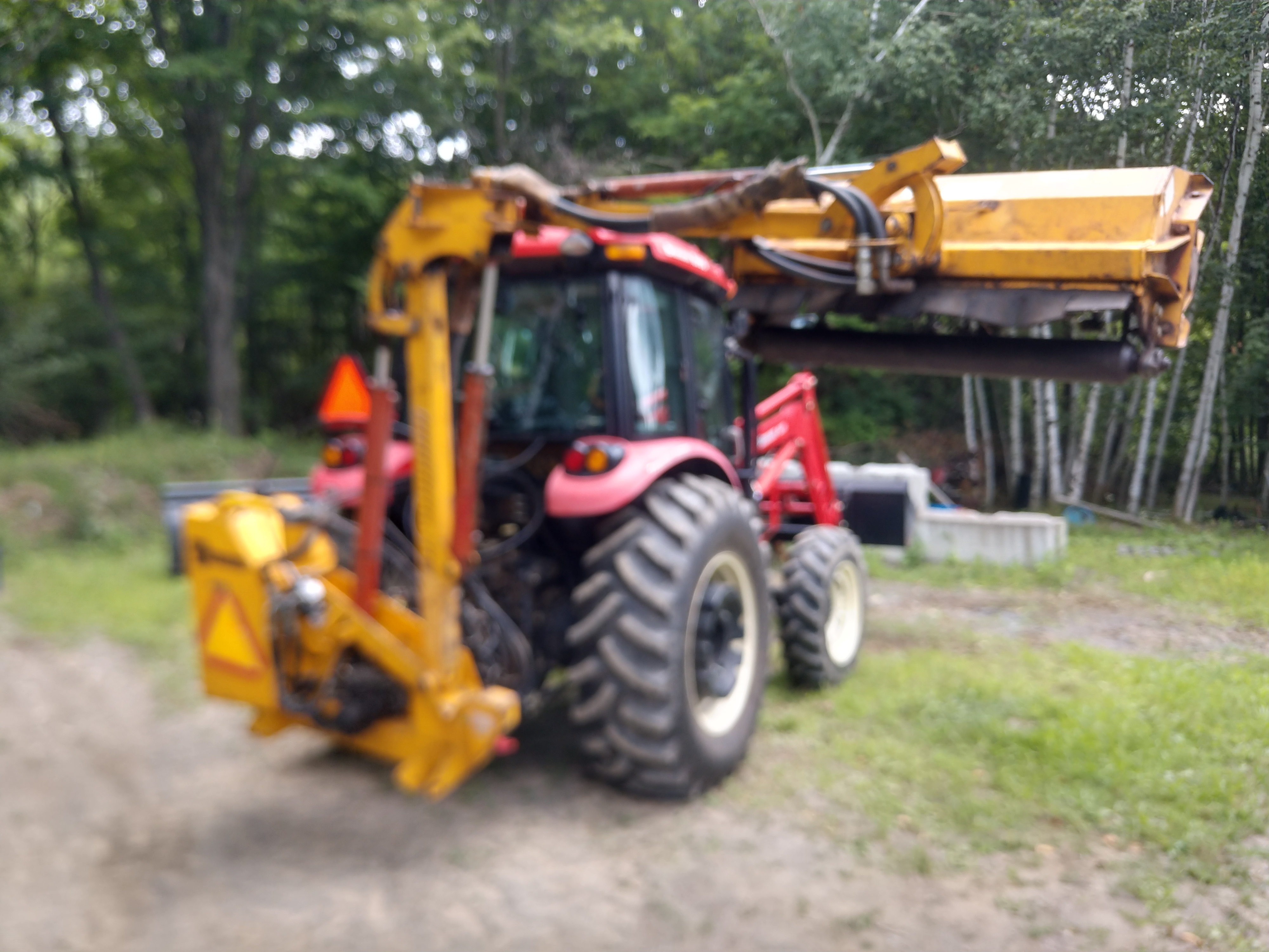

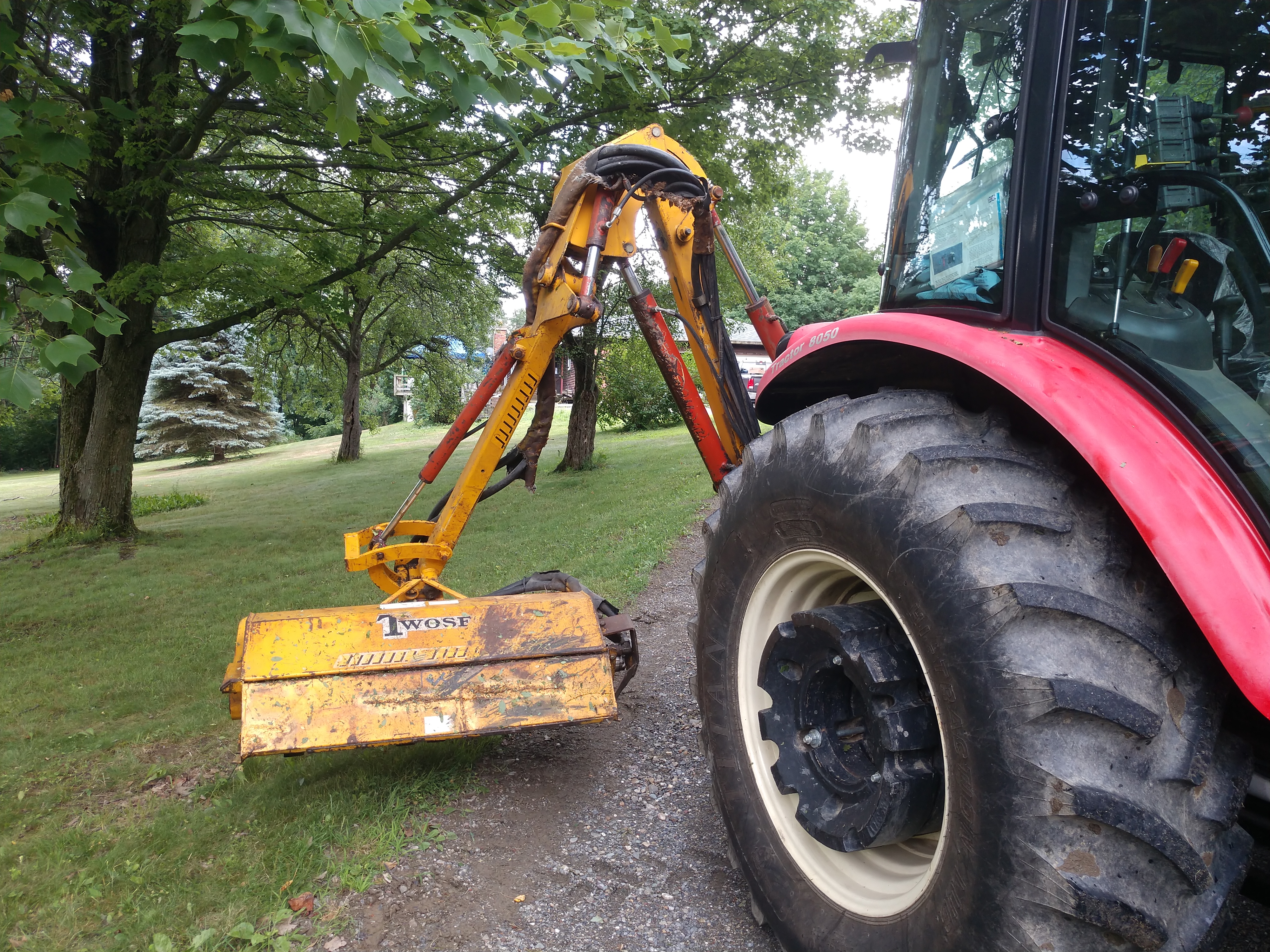

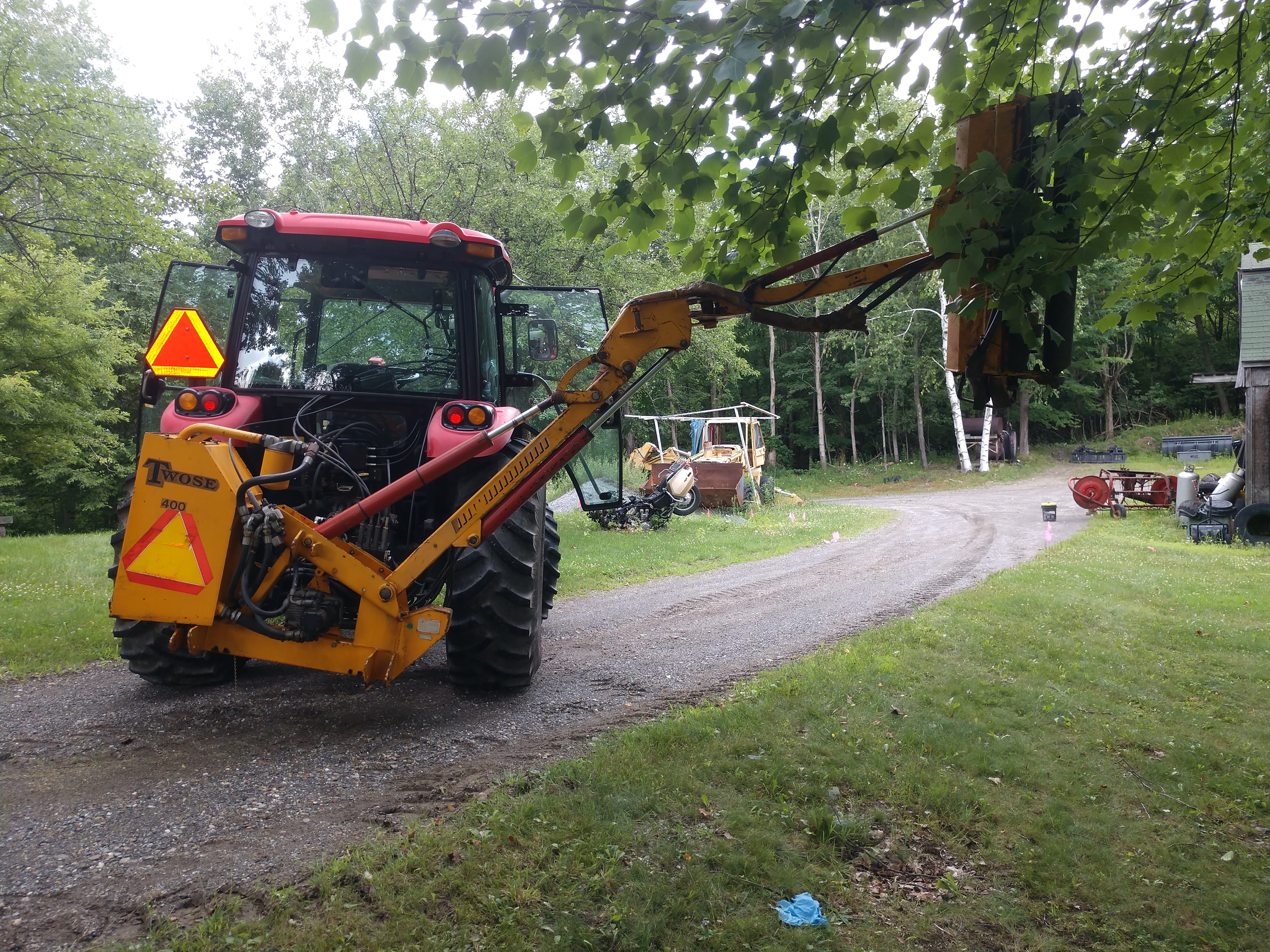

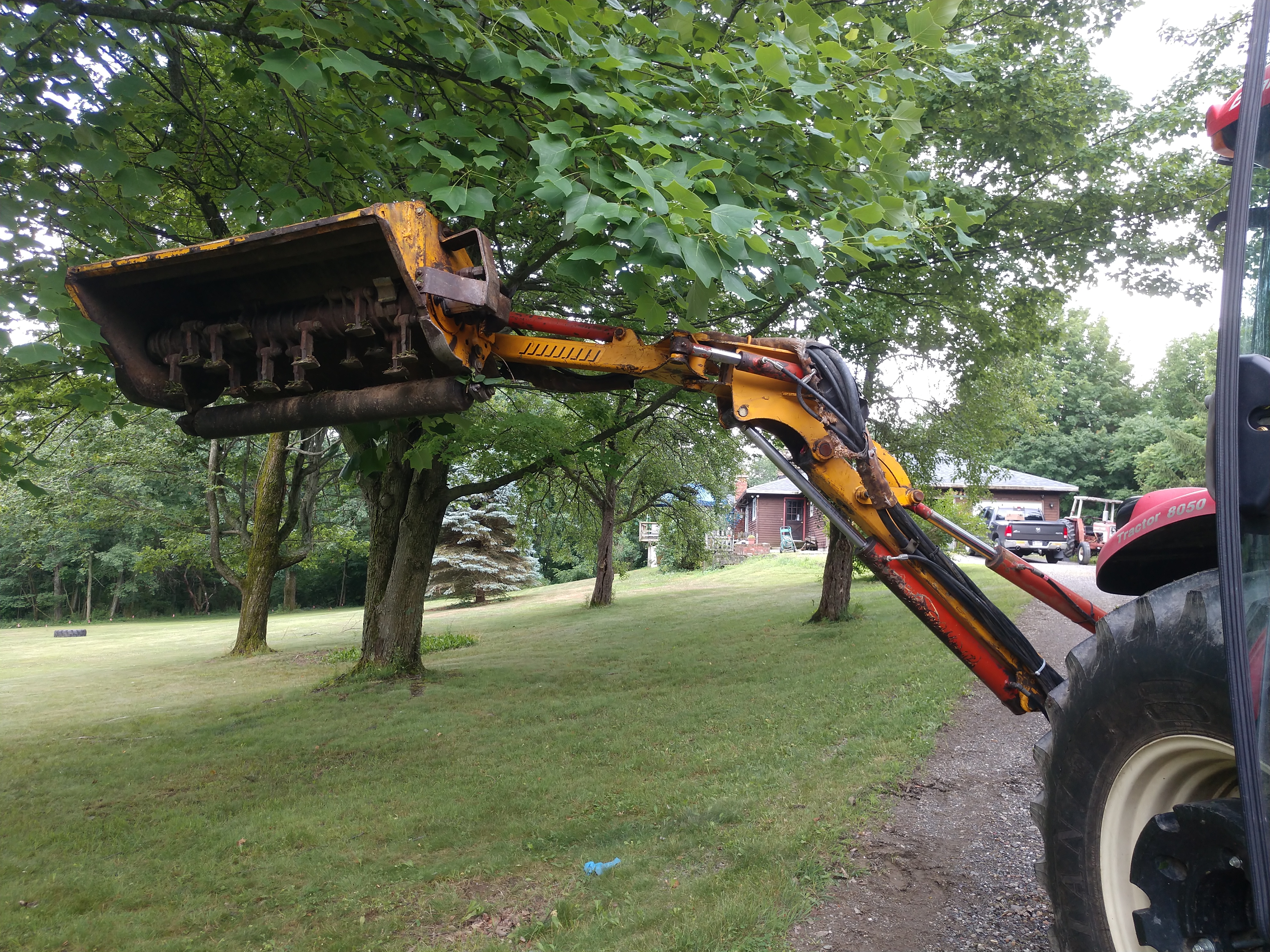

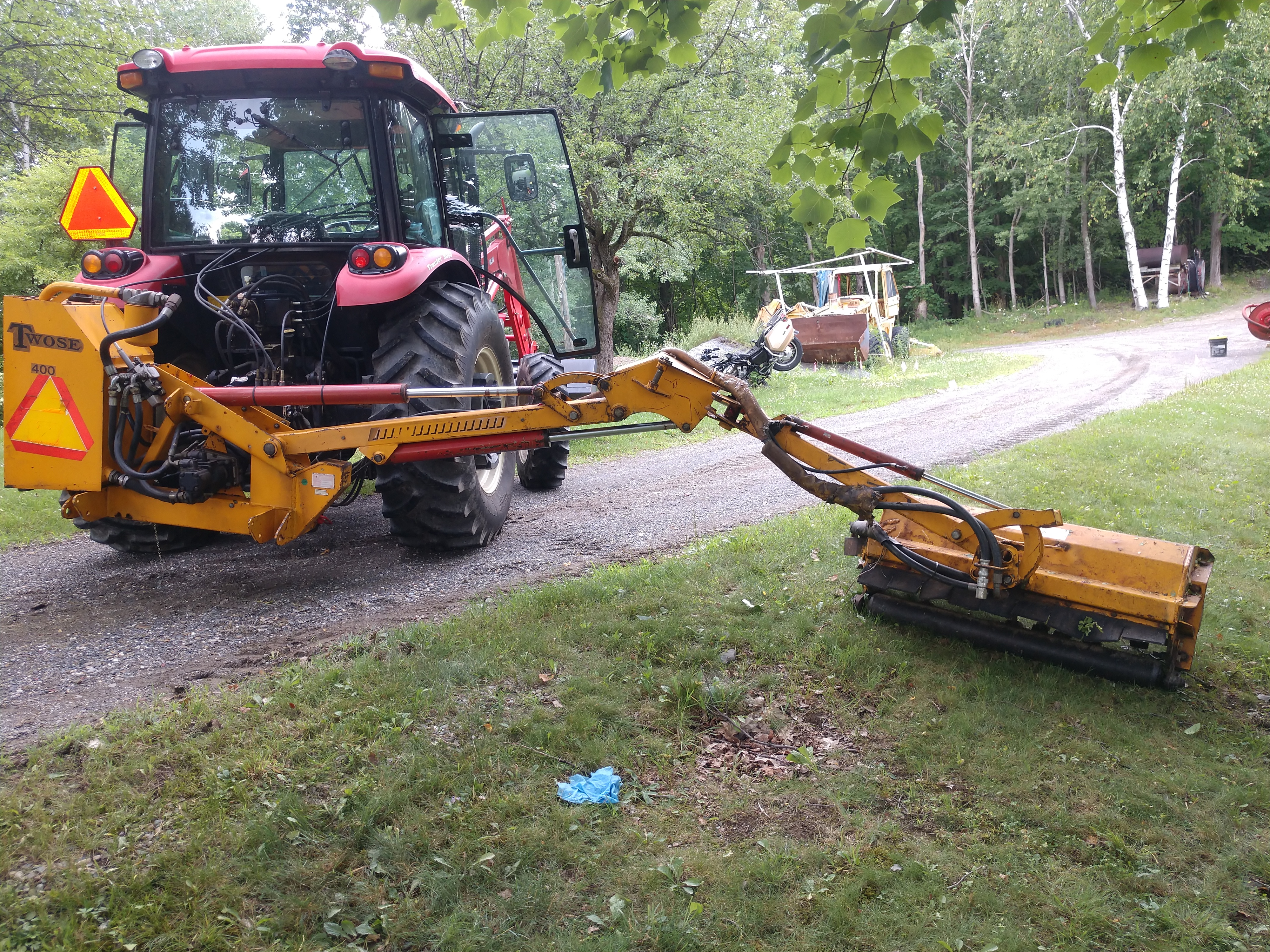

major manufacturers of side boom mowers are tiger,diamond and alamo.
   / Tractors with side mounted (articulated) mowers.... #17
The majority of the road side boom mowers in this area a mid mounted,
the pumps for the hydraulics are either hung off the pto or are tank mounted to the 3 point arms.
Most of the large ones that look to be three point are actually mounted to a heavy sub frame.
There are smaller units available for three point usage;
Betstco has three point boom sickle and flail mowers, they are kind of light duty looking,
FH-BRM Boom Sickle Hedge Cutter | Betstco Sales, Parts, and Service:
And occasionally you can find mid sized units on the used market;
mower 5.jpg mower 8.jpg mower 14.jpg mower 13.jpg mower 11.jpg Branson bracket in use 1.jpg
My 4 foot flail and it's a handfull at times on my tractor which tips the scales at around 10,000 without the mower,
you get booming up and out it will bounce the tractor quite easily.
