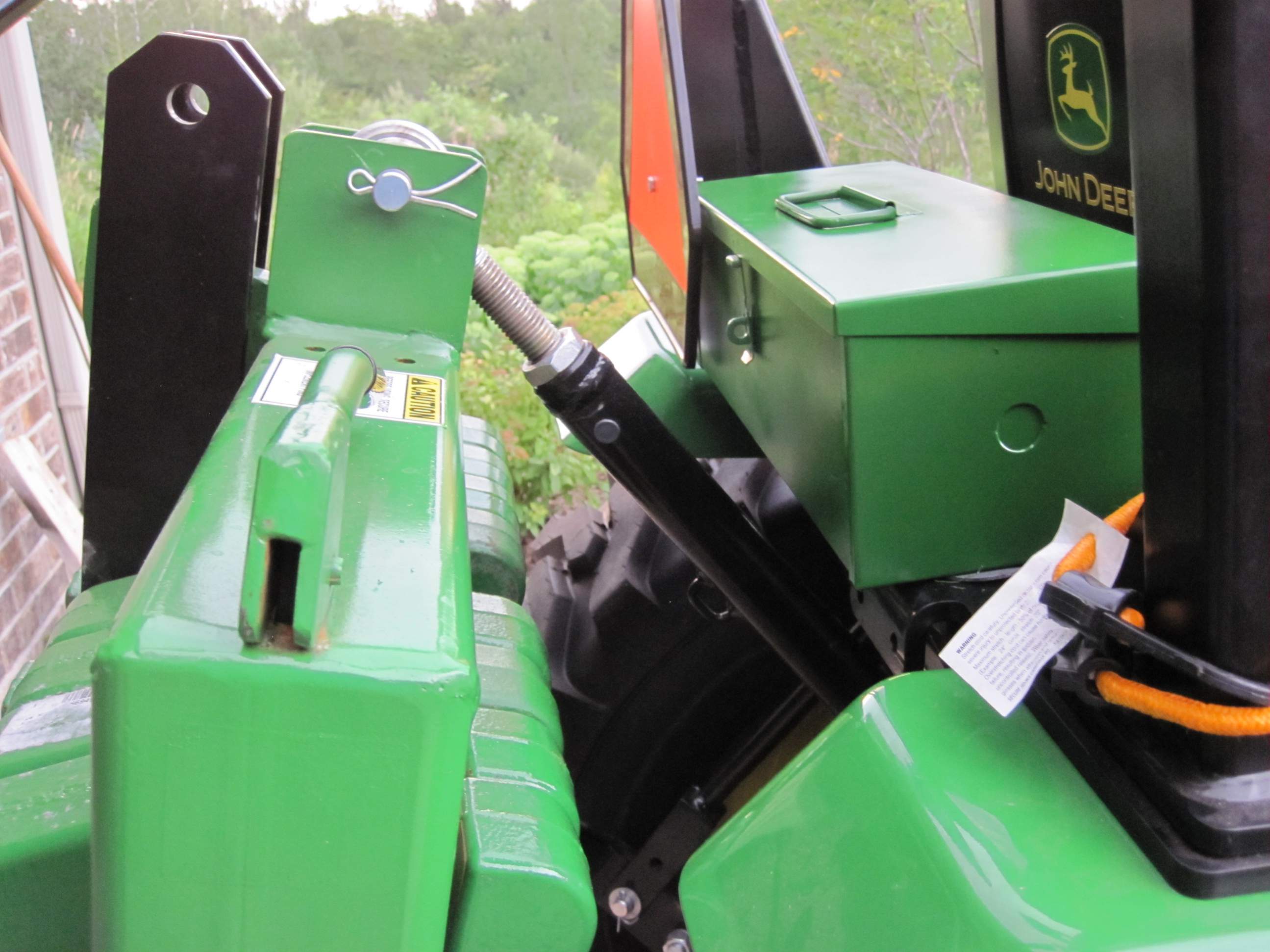

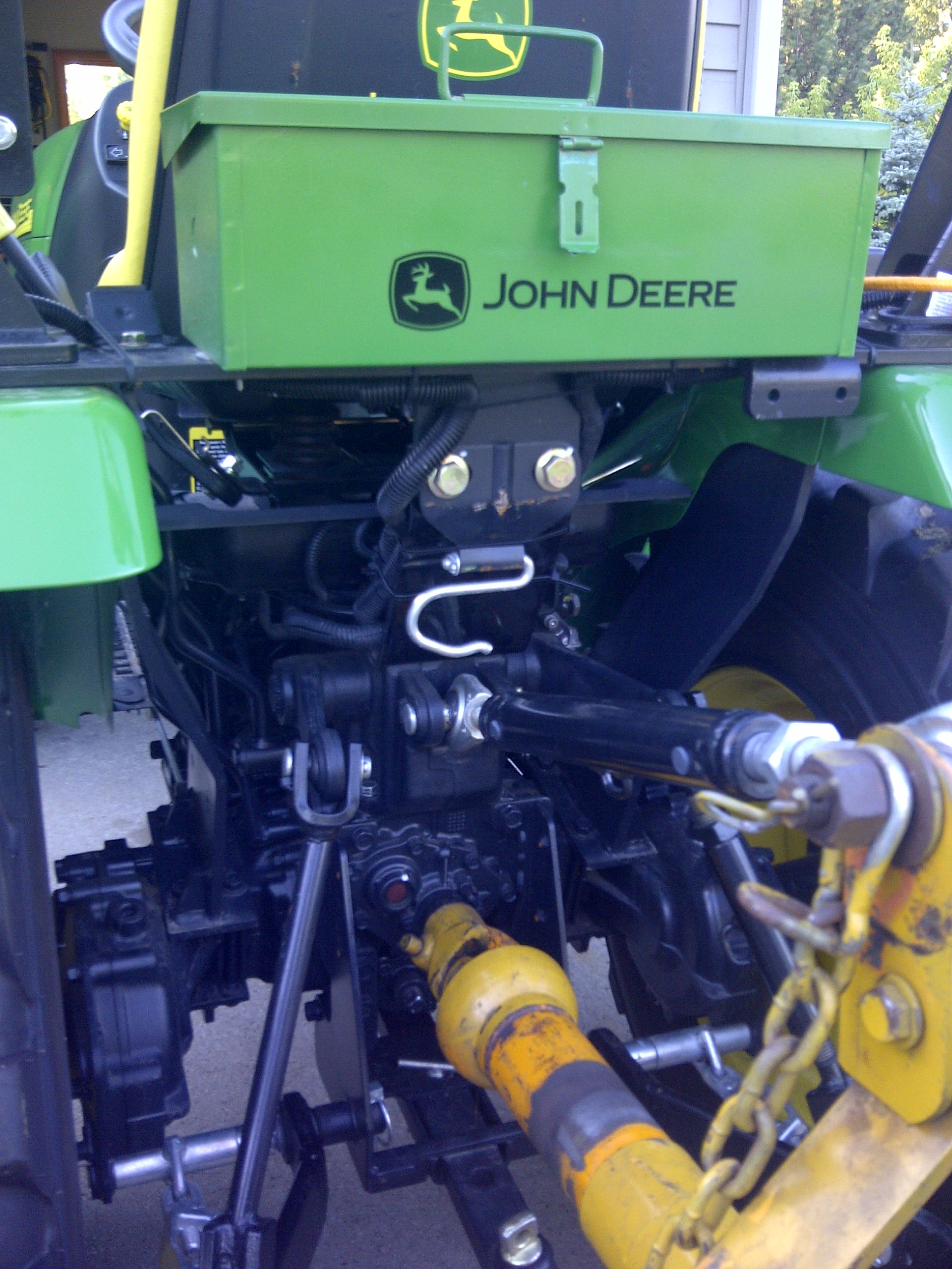

any body have pics of how you mounted a tool box to your tractor?
Our toolbox (generic Fleet Farm toolbox mounted to the rear behind the seat):
