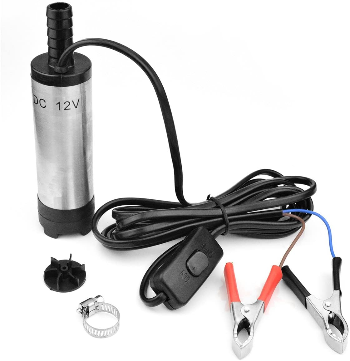

Guess I am getting older, but those full 5 gallon jugs of diesel sure seem to be getting heavier. I purchased a small diesel transfer pump off Amazon and it works great. Attach 9/16 ID hose to it, drop it in the 5 gallon jug, tap in to the exisiting 12v leads hanging by my ROPS, turn key on and place hose end in tank. Works great. shut off power and fuel drains from hose and pump.
