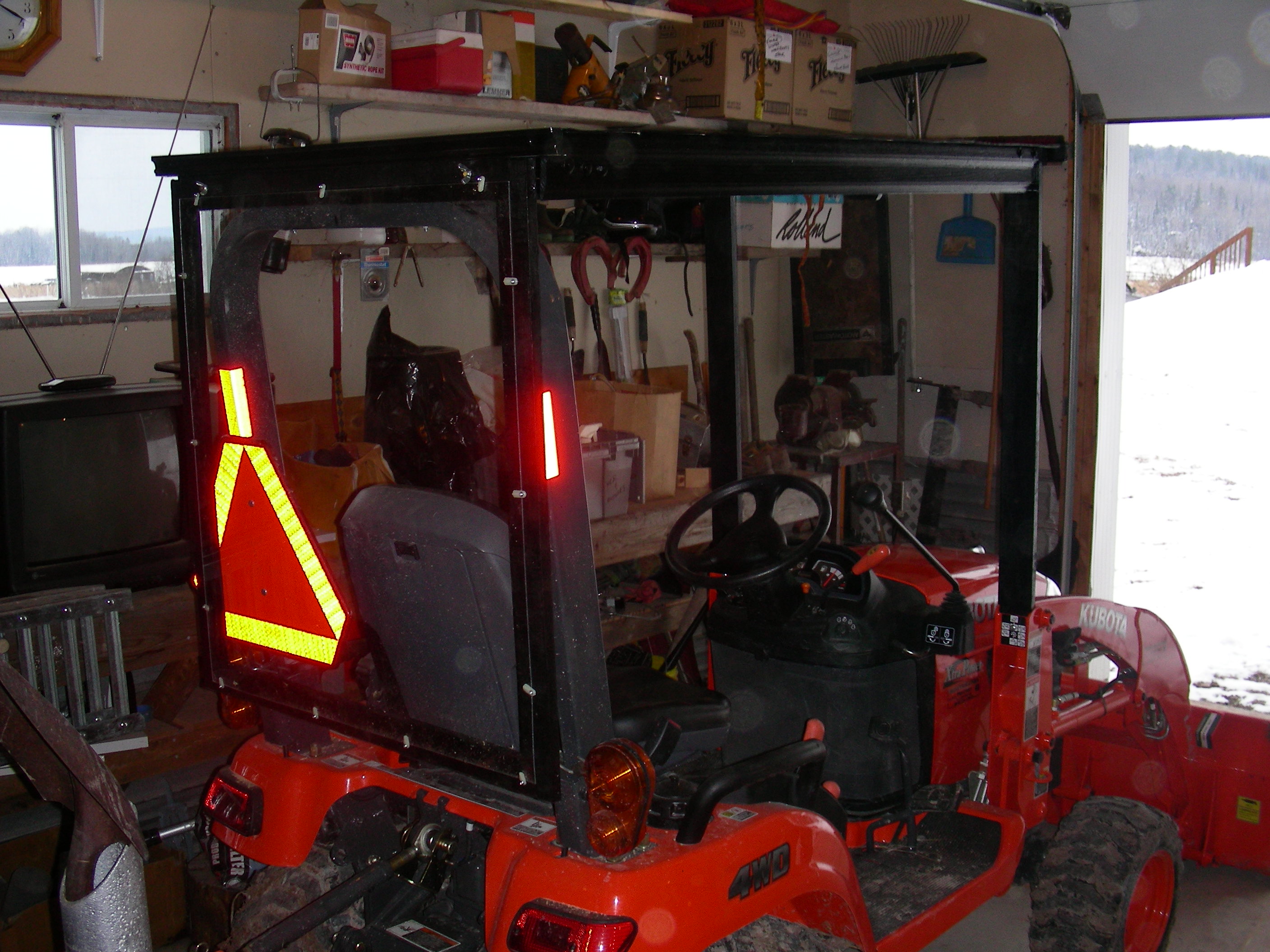

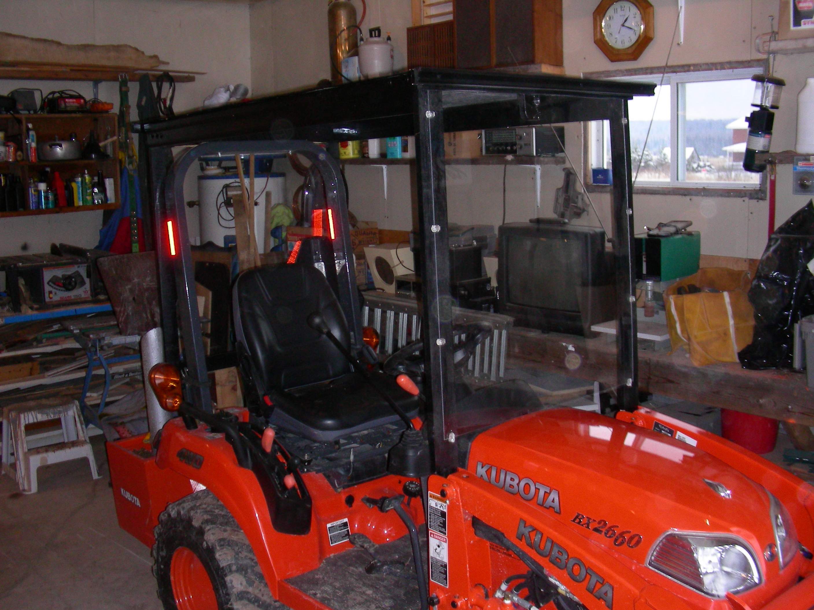

I used hardwood , painted black , then mounted 30 x 32 inch plexi glass front and back . Only required two quarter inch holes in ROPS and two in the vertical brace for FEL.
I have used already for one winter without side panels , might make some out of clear vinyl , but most of the time winter wind blows west to east so I work west to east and stay out of direct wind.
I added a 12 volt light to front upright and used existing 12 volt plug under seat.
jake
