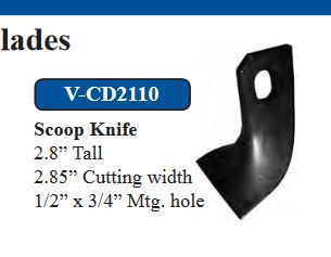

You should be able to get scoop knives from flail master. Take one of your current blades and measure the width at the bottom of the Y, and measure from the top of the mounting hole to the bottom of the blade. The blades stay in the Y configuration when spinning. Flail masters catalog has the dimensions on the parts. Would be great if you could get close in weight. Do you have a scale that can weight something that small?
Flail Mower Blades and Parts - Flail MasterFlail Master
At the bottom of the page is a link to download the catalog. Hope this helps.
Ha ha, I JUST NOW saw where you said "at the bottom of the page" catalog.
OK, so a scoop like this, right? In attached pic
Yup, those are what you want. Not looking at the catalog, but I believe they are organised by make, though many use the same part number. If you can't find yours you can measure and get something that will work. They are great to deal with over the phone as well. Good people.

Thanks, Ink. I'll have to measure my Y blade width at the blades cutting edge, to see if it matches those scoops.
They somehow appear to be narrower, so may not work, I presume.
Saturday, that will be my mow day. ebay is also full of various blades.
There is some overlap so not being exactly same width may not be a problem. Just measure the distance across the bottom of the Y. If you measure and post what you have, we might be able to help.

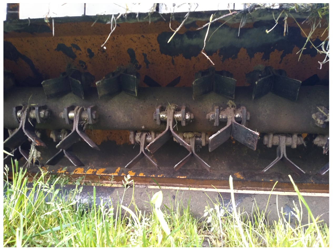

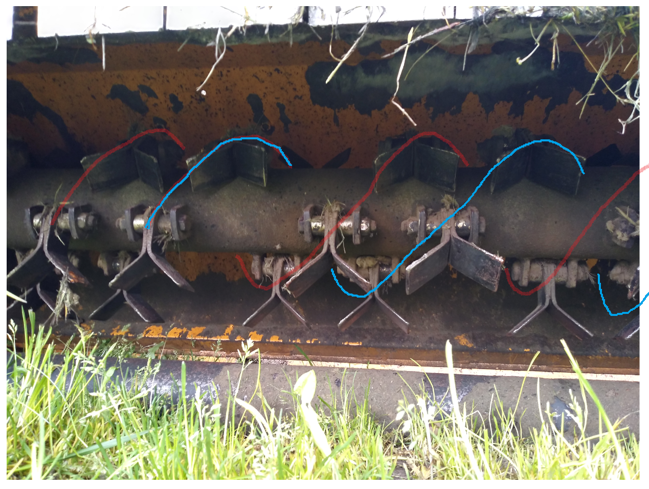

Anyhow. I have 4 rows 8 blade stations each. Not spiral arrangement obviously. Checker board.
yes, waffle effect is quite observable. Give it about 5 -6 days, and it clearly shows itself.

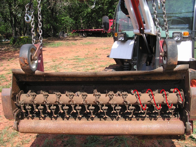

Mine is a single spiral. The hangers are evenly spaced in the row:
Yours is a double spiral arrangement. Two hangers closer in the row, in a double spiral around the drum:
The way the blades are set in a spiral is not real obvious.

ukrkoz, Not sure that you saw this in the other thread, since it didn't get any replies, so will post it in your thread:
I could swear... I know what fooled me. When I looked at English and German spiral arrangement mowers, you could clearly SEE how attachments run in a spiral. Or two spirals. Every next mounting point will be somewhat higher than one before. Not next to each other. Makes beautiful spiral moving across rotor, when running.
