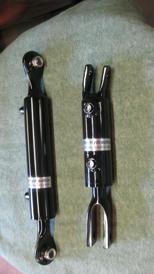

Hello,
I want a top and tilt kit for the rear of my 2025. I have the backhoe, so I have hydraulics back there.
I am not really sure how I would hook up the cylinders to my hydraulics. I assume I would have to hook the lines into a set of controls when the back hoe is off the tractor, or maybe I would have some sort of T fittings or splitters so the top and tilt would remain hooked up, guidance would be appreciated.
I am pretty experienced in aircraft hydraulic systems, especially modern European helicopter (Airbus) systems, so I can handle the install, but I do not know much about how tractors are set up. There does not seem to be any pre-engineered kits for Bobcat compacts.
D.

You will need both of the rear remotes for the tractor to control the top & tilt units. If you don't already have those, then I highly recommend that you get them.
Top & tilt sets can be purchased from Fit Rite Hydraulics. :thumbsup: There is a long lead time though. :eek:

when you say both of the rear remotes, are the remotes the hydraulic lines? I have 3 lines I disconnect from the back hoe, are those the remotes? Or is what I would hook them into to control the top and tilt the remote?
I will call fit rite soon.

The connections for the BH are constant flow. Rear remotes are separate connections that you'd control from a lever on the right console of the tractor.

You should have 2 empty slots on the right side of the seat next to the 3pt position control lever. You need to get the factory rear remotes for your tractor. There will be control levers that will come up through those 2 slots that provide control for 2 sets of couplers that will be at the rear of the tractor by the top link mount.
Tell your dealer that you want both valves to be spring return to center valves. You DO NOT want a detent valve for your T&T application.
You are looking at $920 plus shipping costs for the complete T&T set.
I'm not sure what the rear remotes will cost, maybe around $1000? :confused3:
